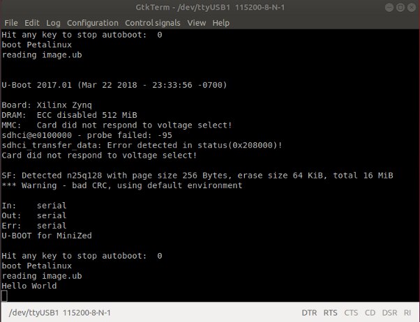

I just powered up my brand new, out of the box MiniZED board for a webinar.  During the process of using Xilinx's new Vitis environment, When I attempt to JTAG program the device I get the following messages on a console connected to the UART1 console:
MMC:   Card did not respond to voltage select!
sdhci@e0100000 - probe failed: -95
sdhci_transfer_data: Error detected in status(0x208000)!
SF: Detected n25q128 with page size 256 Bytes, erase size 64 KiB, total 16 MiB
*** Warning - bad CRC, using default environment
This occurs about 75% of the time when I JTAG with a valid application from the Vitis IDE with a valid program that I was using as per the webinar.  The instructor kept telling me to reset the development board.
From the above, it looks like it is sometimes responding with a bad CRC and invalid voltage.
I tried this using different USB ports on my desktop computer, different ones connected to different controllers.
Anyway,, I am asking to have this, what I consider defective miniZED board.
I have a log file of many different attempts.
By the way, when it fails, the Vitis IDE fails to program the development board.
Anyone else have this issue with the miniZED board?

    The MMC error is a red herring.  I also had that error but it should be checking the flash instead of the SD card.  The cause of not being able to program the board is probably that you do not have the boot selector switches configured for JTAG.  The switches are on the same side as the USB connectors and next to the LEDs.  The switches should be toward the LEDs.  My board was delivered with boot from Flash selected.

    Nope, the switch is correctly set to JTAG.  The fact that the issues is intermittent with no changes to the hardware is significant aspect that I wrote and you missed.
    the fact that sometimes, 25% of the time, the same JTAG downloaf of code works, and the 75% of the time it does not over a 2 hour period (newly opened, following instructor webinar) is significant.  Remember, I switched that small switch to JTAG so it does not boot to the Petalinux OS before I started working  (powering it up).
    The error stops the JTAG booting in mid process. As if it partially downloads, then stops due to a CRC error.  I try the same operation multiple times, pushing the reset switch after each failure and most of the time the JTAG process fails, but occasionally it succeeds.
    pretty sure the board is defective.

    I have seen this error before and it can indicate an incorrect u-boot setting, or perhaps something misconfigured in the hardware platform.
    Let's put aside JTAG momentarily.  Are you able to reliably boot the factory installed image from QSPI?  I believe the factory boot image boots the FSBL and u-boot from QSPI, then fetches the Linux OS image from eMMC.  See this screenshot from u-boot as an example:
    The MiniZed cannot boot directly from the eMMC device - it has to boot (FSBL and u-boot) from JTAG or QSPI first.  Can you post screenshots of your JTAG and QSPI boots?

    I found the issue...
    I put a scope to the power line going into the miniZED and found it unstable.  I changed desktop computers and now that the power going into the miniZED on the programming JTAG microUSB connection it seems to be consistently working.
    I will change the power supply on the other desktop.  This was a weird issue having to do with power fluctuations on the power supply line going into the miniZED which caused an intermittent weird configuration and only exacerbated by the JTAG process.
    I now have a stable environment.
