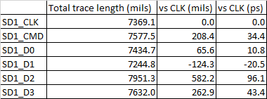

    Hello again. The issue was put on hold, and then corona hit the globe. So, we got a FMC Carrier v2 card in the end. The Picozed just works out of the box with the provided sd card, so we have to conclude that the issue is on my carrier card. I am currently looking at the document you suggested, UG933. I am a bit confused about the trace length you are referring to. Are you referring to the information about a delay skew of 50-200ps between the data pins and cmd pin relatively to the clock? (p.68). A required delay would incur a needed trace length. But I am unsure if that delay skew HAS to exist or not. Meanwhile, I will also be looking at the answer records.

    You do need to have the data/cmd traces be +50 to +200ps relative to CLK. The skew is important. Of course, with the PicoZed system, the trace delays consist of multiple layers:
    • Xilinx package delay
    • PicoZed SOM trace lengths
    • SOM/Carrier Connector delay
    • Carrier trace lengths (on both sides of level translator)
    • Level translator delay
    Are you using a level translator on your carrier? The FMC-V2 uses the TXS02612RTWR.
    I haven't done the analysis myself, but I assume since the Avnet FMC-V2 Carrier works that the lengths were skewed correctly after adding up all the other delays. An easy thing to do is try to match the trace lengths on the Avnet Carrier. You can find the list of trace lengths here:
    PicoZed FMC Carrier Card V2 Kit
    PicoZed FMC Carrier V2 REV1 NetLengths_160318.zip
    I did a quick calculation to add the traces on both sides of the level translator, then compared to the clock, then converted to picoseconds using 165 ps/inch.
    You'd have to add in the Xilinx package delay, SOM trace lengths, Mating connectors, and level translator to get the complete picture. But, we know this works, so if you do something close to this, your's should work as well.
