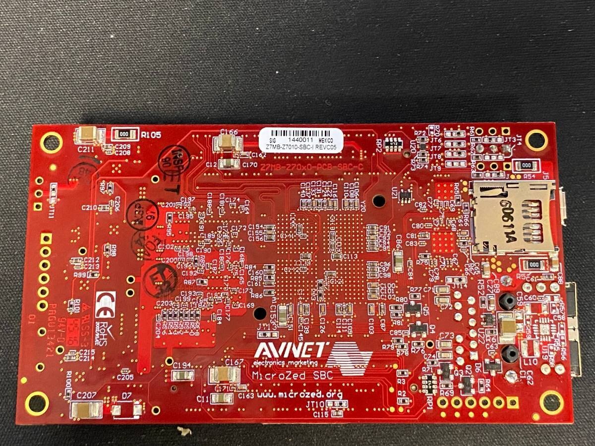

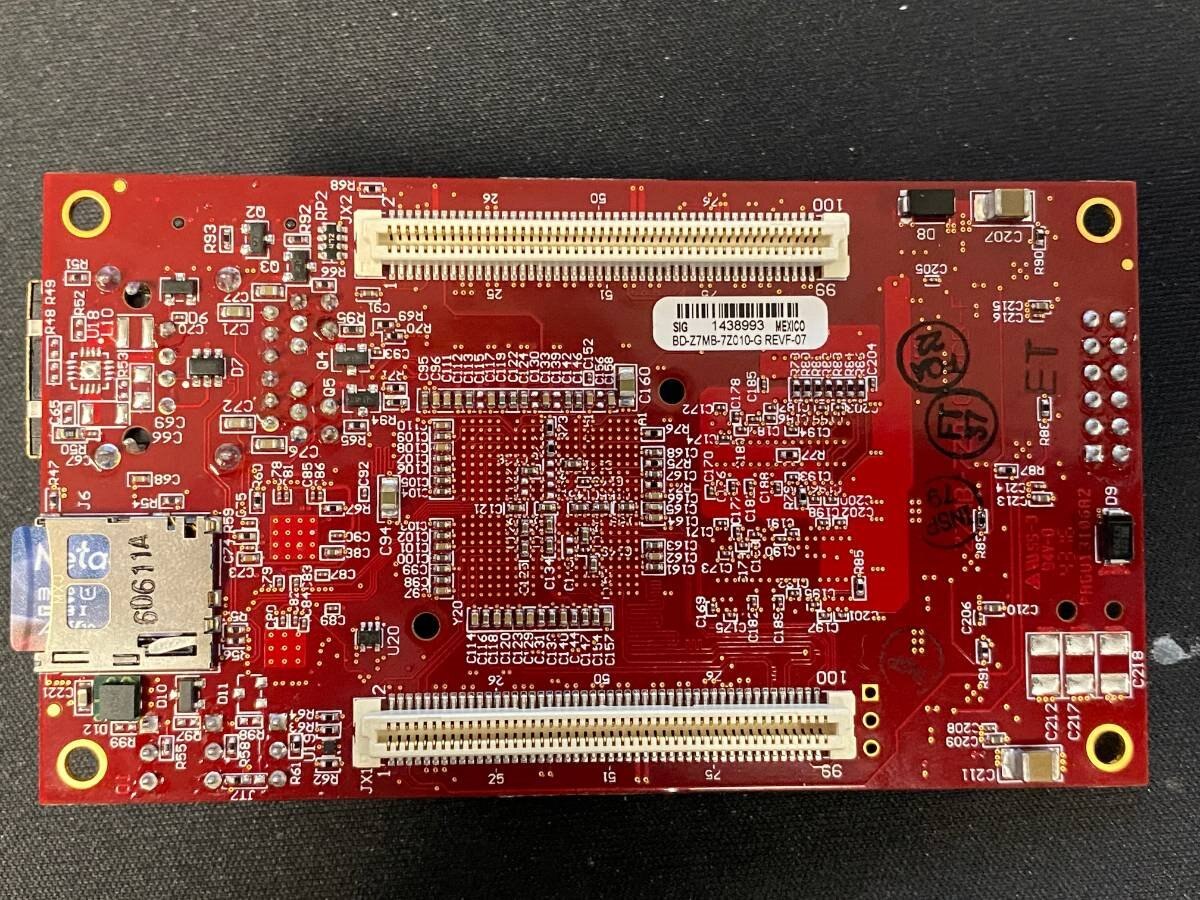

Hi, I tried multiple times to reach an engineer at Avnet but was finally directed here so maybe I can find some answers. We began developing a product roughly a year and a half ago using AES-Z7MB-7Z010-G. To my understanding this is the part number for a kit which contains other items and not just the MicroZed board. We would like to use the industrial grade version of the same board which comes in that kit. I thought I had chosen the correct part number of AES-Z7MB-7Z010-SBC-I-G but after receiving the board, I realized that there are some major differences which are not indicated on the product page. Headers JX1 and JX2 have been relocated to the top side of the board however the signals to each header were not rerouted. This makes the board incompatible with the previous MicroZed used for development! Can someone please clarify what part number I need to order?
We need the industrial grade version of the above board.
This is what I received when ordering AES-Z7MB-7Z010-SBC-I-G.
-Andrew

    Hi Andrew,
    Sorry for any confusion.  The part that you ordered was a Single Board Computer - the SBC in the name.
    The part number you will want is the AES-Z7MB-7Z010-SOM-I-G
    Right now the latest is the REVH.
    AES-Z7MB-7Z010-SOM-I-G/REVH
    That is the latest board.  If you take a look at the errata on the product page, you can see what is going on between the REVG and RevH.
    You can get to the product page through this link:
    MicroZed
    Then click on Technical Documents and scroll down to the bottom of the page under "Errata and Product Change Notices"
    --Dan
