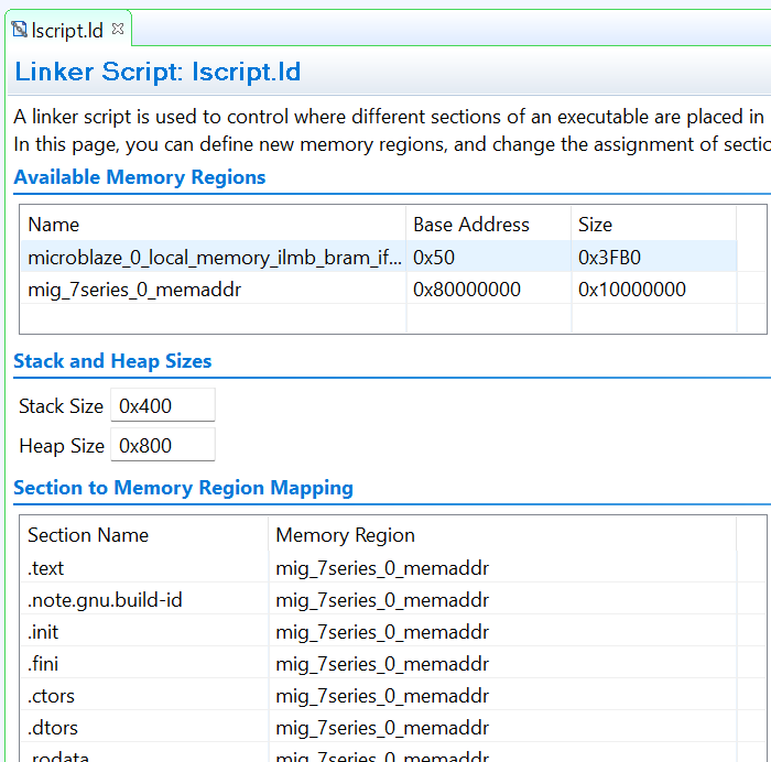

This is another doubtlessly naive question.  I know that you can read the BRAM by using XBram_ReadReg() and a BRAM controller.  Also that XBram_ReadReg() basically amounts to using Xil_In32() to read a memory location.
Can we do something similar to read the DDR RAM, or are we always forced to use the routines in xaxidma_bdring.c?

    You connect DDR SDRAM using MIG IP (Memory Interface Generator). MIG connects to AXI Interconnect and then you use it as a memory by the code running on the CPU. See this tutorial I created for using…

    Once you have the DDR connected to the CPU via AXI Interconnect, it will be memory-mapped into the CPU's address space.
    You can then use a Xil_In32() call to get the data, or you could dereference a pointer as follows:

    Be aware that data in the DDR is cached.  If you are accessing DDR memory that was (only) loaded by the CPU, then it will read back correctly.
    If you are accessing data that was loaded by the PL, then you probably have to invalidate the CPU's cache before reading it to ensure you get the data loaded by the CPU, and not stale data leftover in the CPU cache.

    Thanks for the tip, and I will try it out.  I couldn't find 0x3000000 listed anywhere in xparameters.h though.  Where did you find this documented?

    If you use MIG in the HW design, the lscript.ld in Vitis will show address and size of DDR memory (and any other available memories).
    Corresponding macros are also generated in xparameters.h
    /* Definitions for peripheral MIG_7SERIES_0 */
    #define XPAR_MIG_7SERIES_0_BASEADDR 0x80000000
    #define XPAR_MIG_7SERIES_0_HIGHADDR 0x8FFFFFFF

    Thanks for the tip.  Looks like the proper address is 0x80000000 rather than 0x30000000 though.
