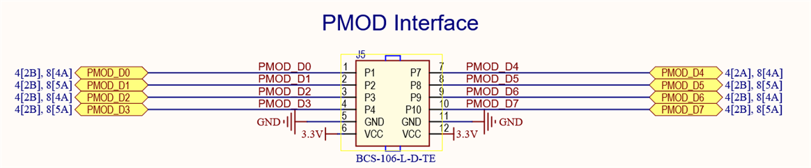

I am having some problems accessing MIO_13, MIO_12, MIO_11, MIO_10, which correspond to Pmod's D0-D3.
My system is built from a customized PCB with two DACs that is connected via J1-J2 to the Microzed board. I'm working with Vivado and Vitis v2022.1.

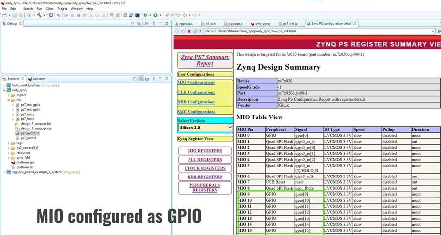

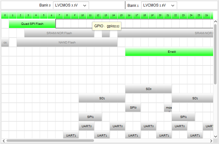

My Vivado design is a very simple zynq processor with the GPIO and some other peripherals enabled,  I double-checked that the specific MIOs are GPIO:
in VIvado:
in Vitis:
I am using xspio_polled_example.c gpio example file (with some changes) in order to operate the LED in my board, and all PMODs. Upon running the program, MIO_0,9,14,15 as well as the LED on the board are responding, but the problematic MIOs are not.
