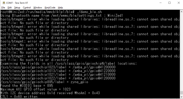

When I run the demo_ble.sh, I get a Library Error and Bluetooth does not connect as shown in the screenshot below.

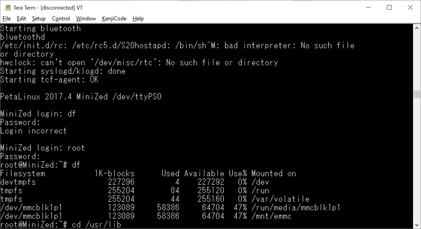

Has some one else encountered this problem The peta Linux version is the  2017.4 (latest image) running on my minized and has the "image.ub" in the emmc (43MB).
The bt.sh and wifi.sh from the "Getting started guide" works. but not this demo.

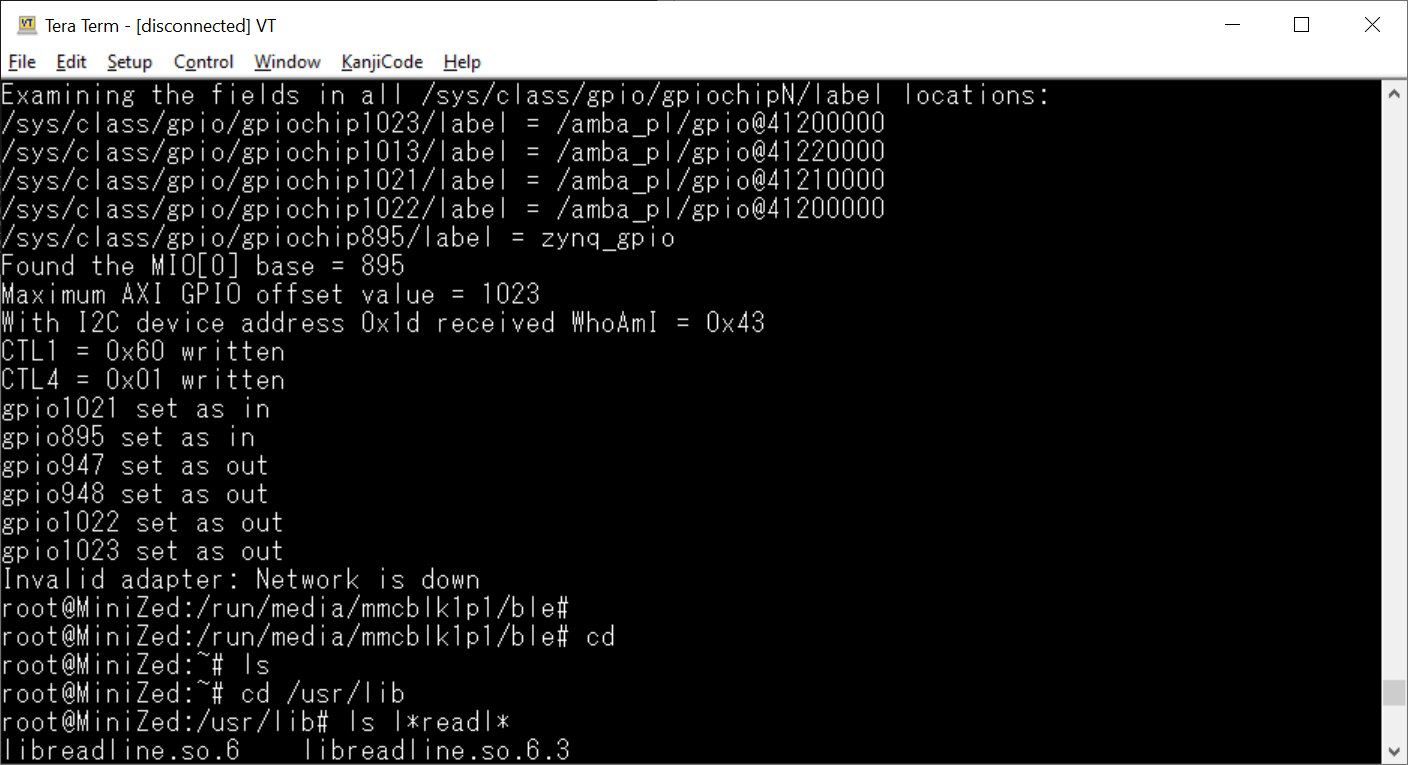

I checked the /usr/lib path for what libraries are present and the closest one is "libreadline.so.6" (not the 7)
Problem: How to get this library (7) added to the path. I don't have a petalinux build running on my host.

    Great that you are playing with BLE.  If you look at the reference designs, you will see that there are separate downloads for 2017.4 and for 2018.2.
    Using Bluetooth on MiniZed 2017.4
    Using Bluetooth on MiniZed 2018.2
    My guess is that you downloaded the one for 2018.2 but are using 2017.4 for the PetaLinux on your board.  They are not compatible.
    The latest versions of the Raspbian OS caused incompatibilities with the libreadline library in PetaLinux 2017.4. It uses version 7.0, while MiniZed with PetaLinux 2017.4 uses version 6.3 and it would give warnings. For this reason the Raspbian build version used for the BLE app was 4.4.50-v7+.
    When you update to PetaLinux 2018.2, it also uses libreadline 7.0, so we are able to use Raspbian version 4.9.41-v7+.
    So for this demo it seems that your options are to update your environment to 2018.2, or to use the 2017.4 version of the BLE files.

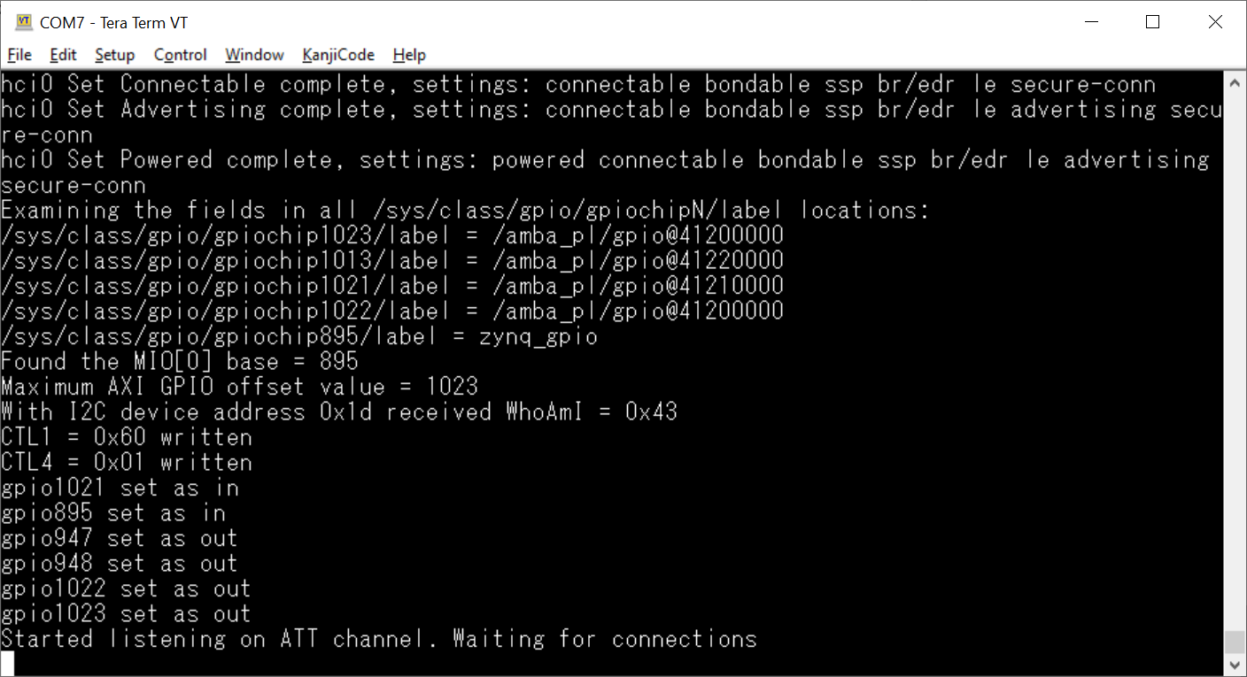

                  The 2017.4 ble files worked fine with out any library compilation errors as prior. However, the BLE Demo app in my mobile phone is not giving
    any temp/led information despite the connection.
    It get stuck in the listening mode on the VT100 terminal.

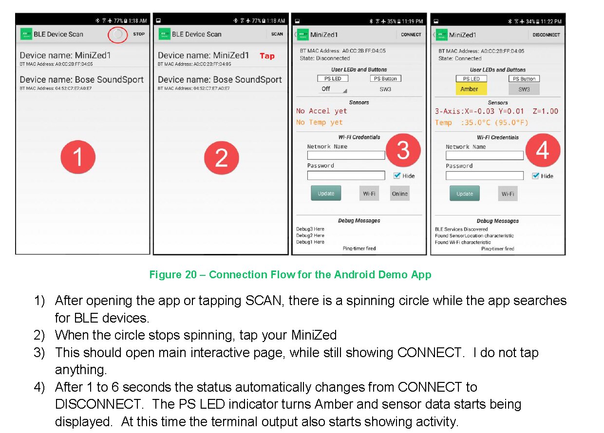

    On the Android phone, I am in stage 3 perennially but it is connected to the MINIZED1 displays MAC Address.
    but no further info on temp/sensor/led and no debug messages show up either at the bottom.
    Is there anything you can suggest. Also I noticed that if I punch in the wifi network and password on the phone app as soon as "update" is hit, the app quits and asks to restart again. I think there is something funny about this. The app developer's have to be notified.

    0 stefanrousseau over 7 years ago in reply to rsiva
    Siva,
    I agree, that app developer deserves to be sent to the gallows.  Here are my comments:
    1) There is an issue with the Android app on some devices.  This was never fully debugged as not enough Android devices were available to be tested.  Sometimes it helps to reset the Android device and to restart the MiniZed after power cycle.  In your case it proceeds quite far, so it is possible that this will work.
    2) If you have access to an iOS device, that is much more stable and we have not yet seen a device on which it fails.
