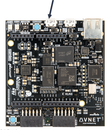

I have hooked up a new miniZed board (first day) and am trying to pick myself up by the bootstraps and get it running. I have USB cables connected to J2 & J6 and a blank thumb drive in J1. I can talk to the console with Putty and run a sub-set of the Linux commands. I got the i2csensor app to run and display data that looked reasonable.
But now it has shut down (gone dark) by itself three times.  It only does this when I am away from my desk or not looking, so I don't know if there are mitigating circumstances. It can happen anywhere from seconds to minutes after I enter a command.
I can't find anything in the documentation (HW User'Guide, Getting Started Guide, Quickstart Guide) to explain this.  Is there an undocumented feature or could I just have a defective board?

    Are you certain that both USB cables are delivering power? You could try removing the thumb drive from the USB to reduce the power demands on the system. If both power cables are properly delivering power to the system, that shouldn't be an issue, but it would be an interesting experiment.
    Although unusual, it is possible to get a defective board. Every board passes a factory test, but that only takes a couple minutes. If your board requires a little time before it fails due to a manufacturing issue, that would not get caught. The board is covered by a 45-day warranty, so if you can return it.

    Hi Gary,
    How are you powering the board? Just through the USB/JTAG/UART Connector?
    If I may suggest also provide power via the AUX power connector to a USB power supply and see if that's your problem.

    I studied the schematic before attempting hook-up.  J6 is connected to a cell phone charger that can deliver 2 A @ 5 V. I plug that in first.  J2 is connected to a USB port on my laptop. (I assumed the thing would only draw serious current when the transmitter is active, which I have not done yet.  But just to be sure, I have always had both cables connected.)
    To be thorough I removed the thumb drive and tried again.  This time the miniZed booted up the the line requesting my login. It accepted that but stopped responding to the keyboard when I entered the password.  I re-inserted the thumb drive and it seems to be working again.
    Hope this means something to you.

    Page 5 of the MiniZed PetaLinux, HDF Tutorial instructs me to "Set the MiniZed boot mode switch SW1 to JTAG mode (‘J’ for JTAG)". When I do this, it doesn't die.
    The self-destruct command must be coming from PetaLinux.
  • embeddeddesigner
    0 embeddeddesigner over 7 years ago in reply to embeddeddesigner
    I have to take that last claim back. The first time it ran for a couple of hours with no problem. This time it died in less than 15 minutes.  So bare-metal mode is also susceptible.

    I would contact your local Avnet team and request an RMA. From your description is sounds like a faulty board.

    I swapped boards and it has been running for over an hour now, so that was apparently the problem.
