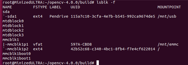

Minized BSP 2019.2 Vitis Ready + WIFI it uses /run/media/mmcblk1p2 as root filesystem (extract whole root image there from tar.gz), put rest of generated petalinux files to /run/media/mmcblk1p1
BSP Link
https://drive.googlel.com/open?id=1bOaXwf9CR_OSKg-2gOfmMrGM84EjBUP4
Also this BSP can have many, many flaws that I'm unaware of so use it with caution and at your own risk image
