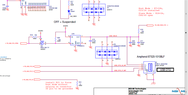

    I am working with Ed on the same new hardware platform.  As he stated we are using a custom carrier card with the USB port implemented using the Carrier Card reference design as shown below:
    The one difference is that we use a type A connector and we force the ID pin low for host mode.  Since the last post from Ed we have found that if we replace our newest PoicoZed SOM [AES-Z7PZ-7Z030-SOM-I-G Rev E)  with what I believe is a date code of 20 20 with an older identical part number SOM with a date code of 22 18, the host port works and can read a memory stick or loop-back to a console USB port.  This difference in behavior is seen with the same kernel/FW build

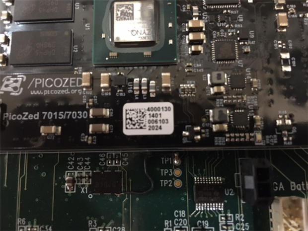

    Thanks for quick response.  We are a bit stumped by what we are seeing so appreciate the help.  The new cards must have the new for,at so I have taken a picture as shown below.
    I read some other Xilinx posts that seem to elude to similar problems with USB PHY transceivers not providing VBUS and there was an indication that the PHY chip (USB3320C)  was being held in a reset state and never able to detect a USB device insertion so that power could be applied.  I am not confident that s the correct sequencing so please clarify.

  • drozwood90
    0 drozwood90 over 5 years ago in reply to craigjavid
    Craig,
    No problem!
    Can you post a picture of each?
    A working one and the one that is having issues?
    Thanks!
    --Dan

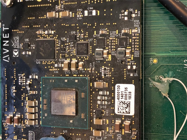

  • craigjavid
    0 craigjavid over 5 years ago in reply to drozwood90
    Hi Dan:
    Below is a picture of an older PicoZed SOM that seems to be working and supports USB host port operation in the same platform/firmware that the newer SOM pictured in my last reply does not.  The date code is 18 38
    By the way, I mistakenly stated the date code of the newer SOM that as an issue with USB was 20 20 but it is actually 20 24.  We have tried a second SOM with a date code of 20 24 and USB does not operate as expected either.
  • bhfletcher
    0 bhfletcher over 5 years ago in reply to craigjavid
    One change we made between Rev C and Rev E was the depopulation of capacitors C190, C191, and C192. You can see a description for this in Item 3.9 of the Rev C Errata. I see the correct Host-setting caps on your schematic above, so I wouldn't think this should be a problem. However, it may be worth an experiment to see if having those caps installed makes a difference. That's the only thing that I've been able to think of so far related to USB that changed between the two revisions.
    Bryan
