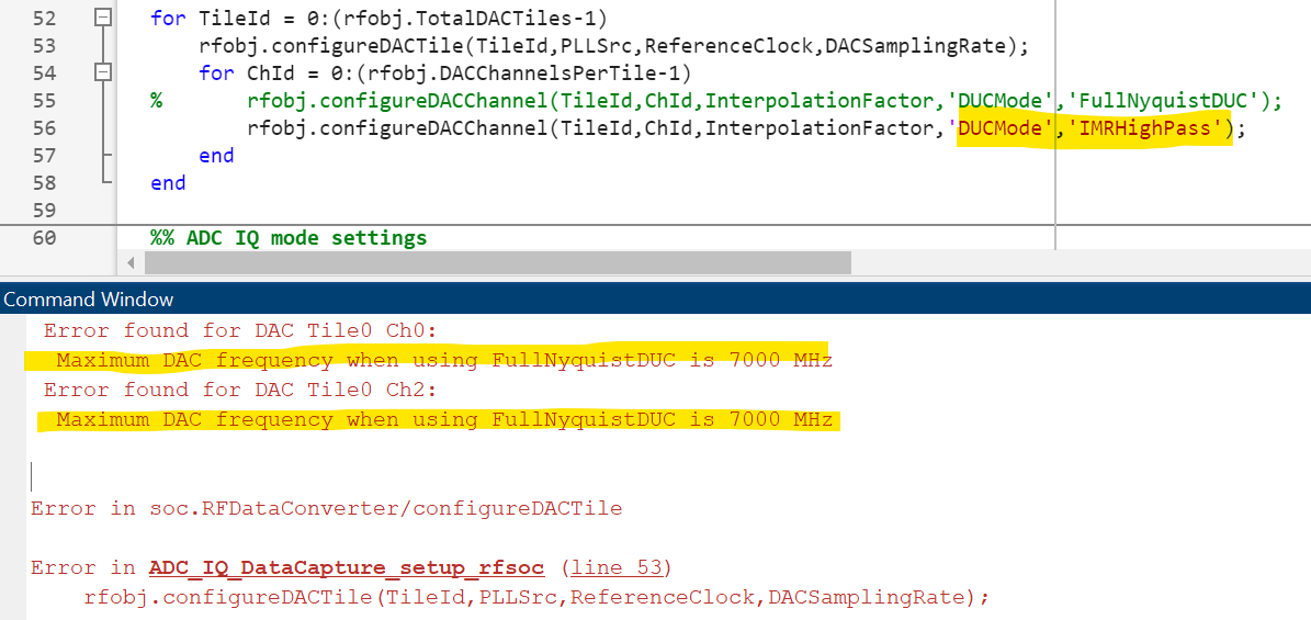

Hello everyone,
I'm working with a ZCU208 board by using the matlab/simulink board support provided at this link:
https://rfsoc-hdlcoder.readthedocs.io/en/latest/zcu208.html
All the examples work fine and I'm capable to modify the templates for my purposes without particular problems.
The only issue is related to when I try to set the sampling rate of the DACs over 7 Gsps, namely 8.6 GHz.
I receive the error:  Maximum DAC frequency when using FullNyquistDUC is 7000 MHz
Of course, I'm not using Fully Nyquist mode, but I set the IMR filter in High Pass mode as depicted in the screenshot below:
It seems that the problem is connected with soc.RFDataConverter object provided by Xilinx, but I'm not sure.
Did anyone have the same problem or is able to replicate it?
Regards

  • McG
    McG over 4 years ago
    I received just yesterday the first workaround to bypass the problem. It needs to modify a Matlab file as in the following:
    move "configureDACTile" function from line 108 to line 127 in the "CreateRfCfg.m" file.
    Execute the following command to obtain the location of the "CreateRfCfg.m" file:
    fullfile(matlabshared.supportpkg.getSupportPackageRoot,'toolbox','shared','supportpackages','rfsoc_shared','boards','+ZynqRFSoC','+common','+rfsoc_sw')
    Then modify the code at Line 106 as follows:
       for TileId = 0:(rfobj.TotalDACTiles - 1)
           isDAC = true;
    %    rfobj.configureDACTile(TileId,PLLSrc,ReferenceClock,DACSamplingRate);
           rfobj.setTileNCOPhaseProp(TileId,MTSEnable,isDAC); %NOTE: We need to explicitly tell the NCO to reset. When using MTS, the setup() routine over-writes this parameter to reset the NCO
           for ChId = 0:(rfobj.DACChannelsPerTile-1)
               if DACDataPathEn
                   switch(args.SysObjStruct.DACDUCMode)
                       case('Full DUC Nyquist (0-Fs/2)')
                           DUCMode = 'FullNyquistDUC';
                       case('IMR Low-Pass (0-Fs/2)')
                           DUCMode = 'IMRLowPass';
                       case('IMR High-Pass (Fs/2-Fs)')
                           DUCMode = 'IMRHighPass';
                       case('DUC Bypass')
                           DUCMode = 'DUCBypass';
                   end
                   rfobj.configureDACChannel(TileId,ChId,InterpolationFactor,'DUCMode',DUCMode);
               else
                   rfobj.configureDACChannel(TileId,ChId,InterpolationFactor);
               end
           end
       end
    I noticed that both socModelCreator and HDL Workflow Advisor go ahead in the process, but unfortunately, I have a Vivado error during the project creation:
    It seems Matlab is not still able to correctly manage the IMR filter settings. I have to wait for another solution...

  • lightcollector
    lightcollector over 2 years ago in reply to lightcollector
    Hi, I did reach out to MathWorks and we re-concluded the original poster's issue was resolved.  There was an official trouble ticket created for this issue and the code modifications were officially released for R2023a via the HDL Coder for RFSoC support package.  For the ZCU216, the correct support package is nearly seamlessly installed.  So this shouldn't be a task of chasing down the correct version of the support package, it's a matter of having MathWorks tools at least of version R2023a and having them install the package with the fixes.
    There are some additional conditionals of using above 7gsps (IMR mode) for the DACs.  More details can be found in AMD's PG269 document.  This link at least worked when I posted it:  https://docs.amd.com/r/en-US/pg269-rf-data-converter.  See the sections for IMR mode.
    If you are abiding by AMD's restrictions and it is still not working for you, please provide some more details of the issues you are seeing.
