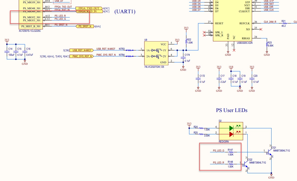

  • jafoste4
    jafoste4 over 7 years ago in reply to alphatozeta@yahoo.com
    Hi Tom,
    How did you configure your Hardware Platform? How is MIO 52 and MIO 53 connected? Assuming they are connected to PS GPIO, change
    #define ledpin 10
    to
    #define ledpin 52
    or
    #define ledpin 53
    -Josh

  • alphatozeta@yahoo.com
    alphatozeta@yahoo.com over 7 years ago in reply to jafoste4
    That's a good reference...Thanks.
    I got the LED to blink using 52 & 53. The realdigital article says the LED is on 16,17&18 for that board. How do I find that for the MiniZed board? I looked at everything I could find in Vivado connected to those signals but didn't see "MIOxx" anywhere.
    Thanks!
  • jafoste4
    Hi,
    I referenced the schematic for this information.
    -Josh

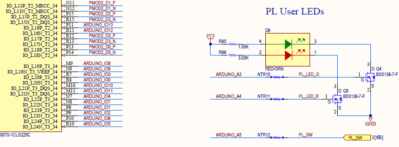

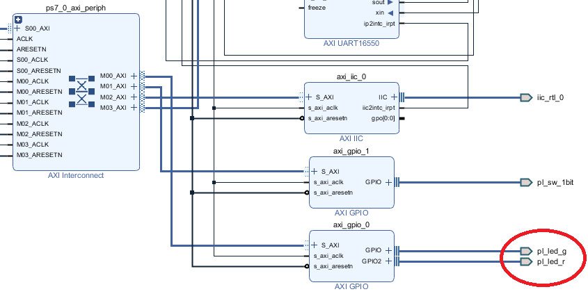

    Any hints about how to write to the other "PL" Red/Green LED on axi_gpio_0 ? I assume these go through another path from the processor through the fabric to LED?
    Thanks...Tom
  • jafoste4
    Hi Tom,
    If you go through the Developing Zynq Hardware Speedway, it shows how we connected that inteface up through the PL.
    Then if you go through the Developing Zynq Software Speedway it takes you through an exercise of turning that LED off and on.
    Training and Videos | Zedboard
    Please start there
    -Josh
  • javagoza
    javagoza over 3 years ago in reply to alphatozeta@yahoo.com
    In case anyone is still wondering how to do this I have made a couple of examples to turn on those LEDs from Programmable Logic. See:  P2P3 Getting Started. Clockless Hardware Blinky on the Avnet Minized
