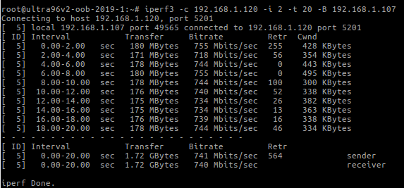

  • narrucmot
    narrucmot over 7 years ago in reply to micallef25
    Hi Eric,
    Where do you have the other end of the Ethernet cable connected?  Directly to the host PC, or to a router/switch?  If directly to a PC (and if the PC is not running a DHCP server) you will need to configure the host and target with static IP addresses.  If connected to a router then, like Dan says, you may have a USB-Ethernet adapter that doesn't play nice with the OS image.  One adapter that we know works is the TRENDnet TU3-ETG.  You can buy it on Amazon:

  • micallef25
    micallef25 over 7 years ago in reply to narrucmot
    Thanks, Tom
    Will have to buy this because yes, it seems mine is not playing nice.
    Do you perhaps know the speed of this? I was reading here: Ultra96 Accessories
    and noticed that each is performing differently.
  • narrucmot
    I have been able to achieve ~740Mbps with the TU3-ETG adapter on my Ultra96-V2 board:
    This test was with the DisplayPort monitor connected, other USB ports idle, and WiFi inactive.  The iperf3 server was running on my Ubuntu host.  The USB-Ethernet adapter was connected to my GbE switch.
