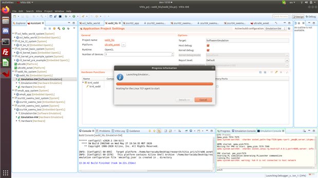

I was trying to emulate Ultra96 on either Software or Hardware Emulation. I have to mention that Hardware is running correctly and I am downloading on the board without errors. Also SW and HW emulation on zcu102 and zcu104 is running fine too.
On SW-Emulation I am building without errors, but when I am running the emulator I get the following error "hub 0 is not connected to host network" and agent is stuck:

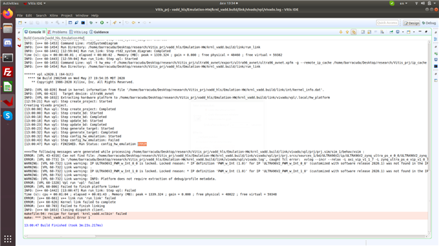

On the HW-Emulation I am facing a build-error. Probably I am missing some Avnet's IP and the Vivado Implementation fails
"WARNING: [VPL 60-732] Link warning: IP ULTRA96V2_PWM_w_Int_0_0 is locked. Locked reason: * IP definition 'PWM_w_Int (1.0)' for IP 'ULTRA96V2_PWM_w_Int_0_0' (customized with software release 2020.1) was not found in the IP Catalog.".
This is the error (attached is the vivado.log) :
So probably I have to download the locked IP.

    The PWM IP can be found in Avnet's 'hdl' git repository on github: https://github.com/Avnet/hdl/tree/2020.2/ip/PWM_w_Int The path to the IP is set in the Vivado project settings by the TCL build script…
    The path to the IP is set in the Vivado project settings by the TCL build script:
    https://github.com/Avnet/hdl/blob/2020.2/scripts/project_scripts/u96v2_sbc_base.tcl#L95
    Perhaps this is what you need to do for your Vivado project?
