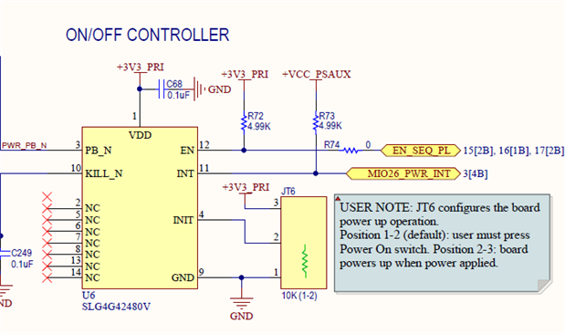

    I realise this is an old thread, but I'm interested in the same topic on my ultra96v2 board, where I don't have Ultrascale on the silk screen, and can't find R161.
    I assume there is a similar trick that I can do on the v2 board. Does anyone here know if it is possible, and if so, how?
  • narrucmot
    0 narrucmot over 6 years ago in reply to ryanharkin
    There is a note on the schematics for the Ultra96-V2 board that says to change the position of the resistor on the JT6 jumper to position 2-3 to power-up the board when the power cord is connected.
    NOTE!  Keep in mind that the previous caveats mentioned above (need to be sure to shut down the OS gracefully else SD card filesystem corruption may occur) still apply if you power the board solely by connecting the power cord.

    I'm not sure I've found JT6 on the board yet, I can see JT7 and JT9, with one above that isn't legible. But either way, it looks like a fiddly job that will need a professional to mod the board.
