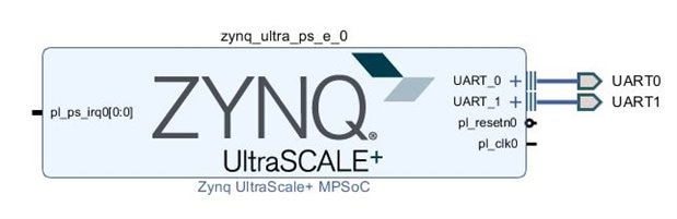

Hello! Is it possible to use UART0 of Ultra96 as serial console? Using Ultra96's BSP the UART0 is connected to bluetooth and i can't use it as serial terminal. Can you tell me how do i use both UARTs as serial terminals?
  • jafoste4
    0 jafoste4 over 7 years ago
    Hi,
    That would require you going in and modifying the Hardware Platform in Vivado to connect UART0 to one of the various UART outputs on the board. You would lose all functionality of Bluetooth doing so.
    -Josh
    • Reject Answer
  • reis220
    0 reis220 over 7 years ago in reply to jafoste4
    Like this? Both UARTs are routed to EMIO.

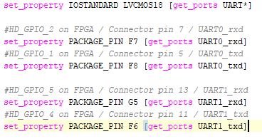

  • reis220
    Yes, i've written constraints to both UARTs.
