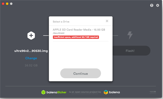

it says we need a 16GB micro SD Card. So I got a 16GB Sandisk card, but seems the image is 'larger than the memory Card requirement of 16GB.

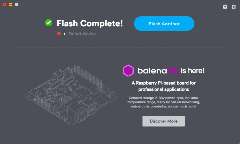

Followed the instructions in the "Ultra_FactoryImage pdf", But I'm seeing that Balena reporting space is insufficient !

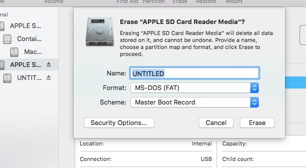

The SD Card is formatted MS-DOS FAT.  Tried other formatting options too. No Luck !

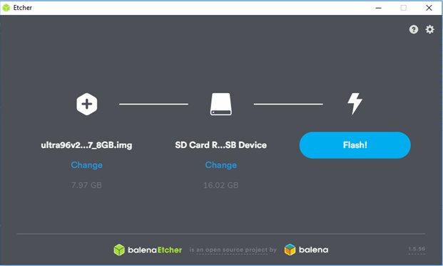

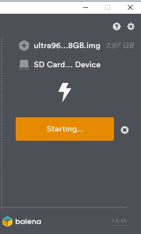

    I have a new image that has the Wi-Fi Access Point working. I am in the middle of updating the Getting Started Guide, but if you'd like to give it a try, I created a version targeting an 8GB Delkin Utility microSD card. This should allow you to image it to any 16GB card. The issue that you are experiencing is because different vendors have slightly different amounts of bits in "16GB." In this case, we created the online image with a Delkin 16GB card that has a few more bits then the 16GB version you are using. Most of the 16GB is empty user space, but forcing the larger image onto a smaller card will likely not work (Win32DiskImager will actually allow you to do this, but is not recommended).

    I used Balena, and tried flashing the image on to a "32GB KINGSTON SD Card" - did not work

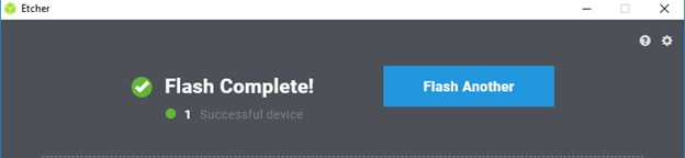

    Thanks for the "new" link. **I was able to flash it using a Sandisk 16GB using WinDiskImager utility on Windows. Just wanted to let you know.
    Booted, Blue LED light up, I was able to access the web page. The WiFi connection showed up automatically. Just an update.

    Balena Etcher should work. I was able to flash the 8GB image to a 16GB Delkin card, although it was in Windows. Hopefully Linux works as well. Are you sure the Kingston card didn't have an issue? It might be worth trying a different card.
