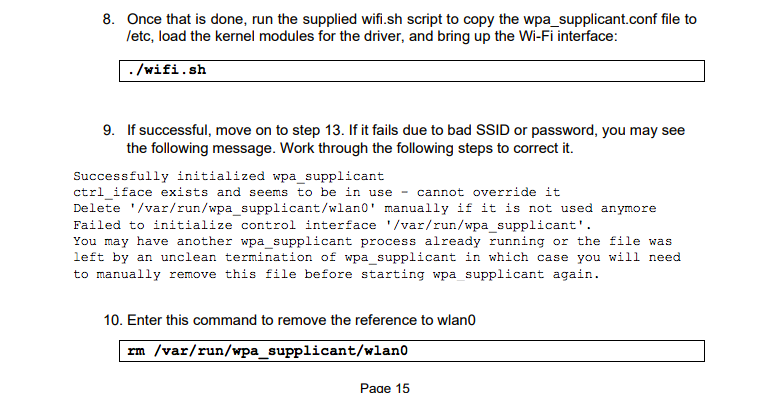

I am having a Ultra96-v2 and just flashed the image with the latest release as suggested in this link.
Creating a Boot Image for Ultra96-v2 on a 16GB Sandisk Micro SD card.
I did login and changed my credentials in the wpa_supplicant.conf and saved it. ( used vi)
Ran the wifi.sh and it locks up.
Did some debugging, and removed the wlan0 file as suggested in the Startup guide.
Now, if I start wifi.sh nothing happens  ! just sits there at the command line.

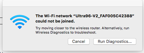

Thinking it needs to be rebooted - I did reboot ( pressed SW4, shut down and restarted )
Rebooted the Ultra96v2 - still no luck.
Now, putty does not open the terminal.
It times out. The Ultra96-v2 is up, blue LED is on, The WiFi connection Ultra96-V2_FAFA<...> . showsup .But when I try to connect to it, I get this message.

    Hello,
    The system has already tried to start the network so running the script is causing a conflict.  Copy your modified conf to /etc and modify /etc/network/interfaces, change  the line wpa-driver wext  to wpa-driver nl80211.   Now reboot and don't run the script again, the network will start automatically with working settings.   Note that I'm seeing an issue that it take 3-5 minutes to be able to ssh to the system but I don't do anything manually.
      Also, this is to connect to an existing network not create an AP, I haven't tried that..

    Yes, Jeff is correct. I got the image updated, but still in the process of updating the Getting Started document, so they are out-of-sync right now. The latest image boots the board into Access Point mode. You can then connect to that access point, then point a browser to 192.168.2.1, after which you can go to the Configurations menu to setup the Wi-Fi. There is also a way to change it at the command line, but I need to get those instructions.
    I'll have the updated document posted soon.
