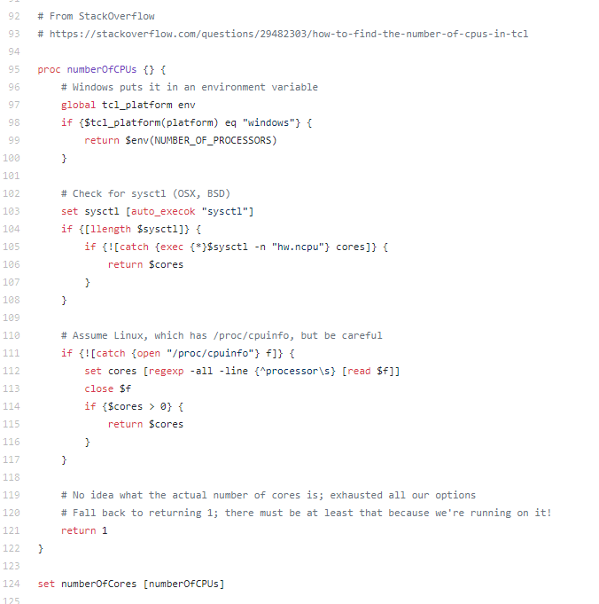

  • drozwood90
    0 drozwood90 over 6 years ago
    Ralph / et al.,
    I wanted to add to this with some new information - I think I found the source of the high memory use.  While experimenting using build scripts and what-not (as I usually do), I noticed that some code I pulled from the Xilinx GITHUB had the implementation command set to jobs 16.
    Well, my machine is only a quad core.  This means that was the source of my issue.  Basically, once I changed that one line to jobs 4, my machine did NOT use more than 16GB of ram generating an image for a ZCU104 (7EV MPSoC).
    I was not seeing this in any of the builds from Avnet's repo, as we had worked around this without even knowing it.  The intention we originally put the below code in for, was allowing customers to tune their performance.  In this case, it worked around the high memory issue I was seeing.
    From make.tcl in the 2019.1 Avnet repo:
    From the same repo, but the UltraZed build script
    --Dan
