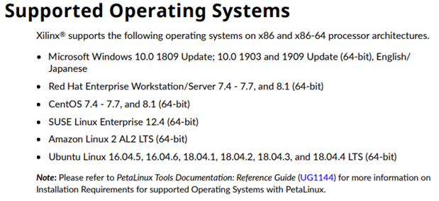

    I recently became aware of an issue that might be affecting you. Are you using native or VM Linux? If so, which version?
    See this post by Javier Garcia: https://ohwr.org/project/soc-course/wikis/Custom-Board-Definition-Files . Note this key message:
    The only presets that apply to the Ultra96-V2 are those in the zynq_ultra_ps_e_preset entry, but there is a critical problem with them as it produces different outcomes depending on your Linux distribution, e.g.:
    If you use Vivado in Ubuntu 16.04.6, the design works.
    If you use Vivado in Ubuntu 18.04.4, the design doesn't work.
    I personally have been using Ubuntu 16.04, which may explain why I haven't seen your specific problem. I don't see that Javi published what the specific error is when 18.04.4 doesn't work, but it is related to the LPDDR4 so definitely worth a try.
    We will be investigating further and updating the Avnet BDF to correct these issues.
    Many thanks to Javi and GL Research for publishing this research!

    Regarding the various distribution versions, it shouldn't matter which one you use as long as it is supported by Xilinx. I think the Xilinx Support may be the key to understanding some of this. You can see the Supported OS in the Release Notes.
    https://www.xilinx.com/support/documentation/sw_manuals/xilinx2019_2/ug973-vivado-release-notes-install-license.pdf
    https://www.xilinx.com/support/documentation/sw_manuals/xilinx2019_2/ug1144-petalinux-tools-reference-guide.pdf
    As you can see, Ubuntu 18.04.4 wasn't officially supported in 2019.2, which may explain why the BDF usage is different. I think there are still some issues identified with the BDF, so we will still address them.
    Regarding Arch Linux, I do not see that on the official list for either 2019.2 or 2020.1, so you will want to exercise some caution there. Here is the 2020.1 list:
    https://www.xilinx.com/support/documentation/sw_manuals/xilinx2020_1/ug973-vivado-release-notes-install-license.pdf
