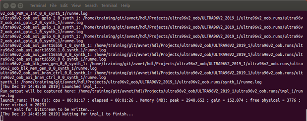

$ vivado -mode batch -source ./make_ultra96v2_oob.tcl

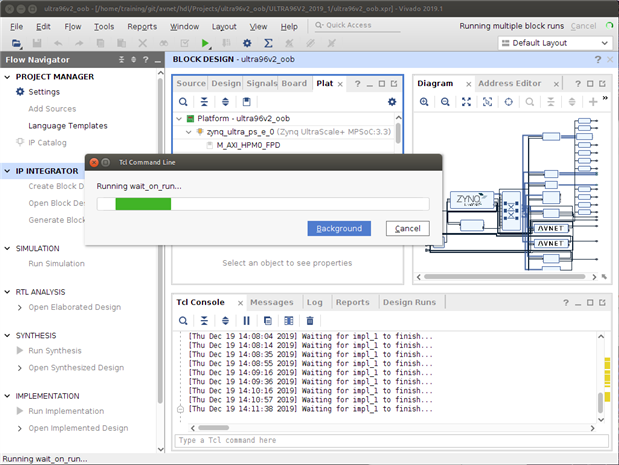

The build will begin and the terminal window will display the progress as the block design is created and the design is built

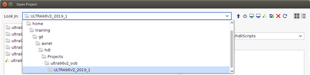

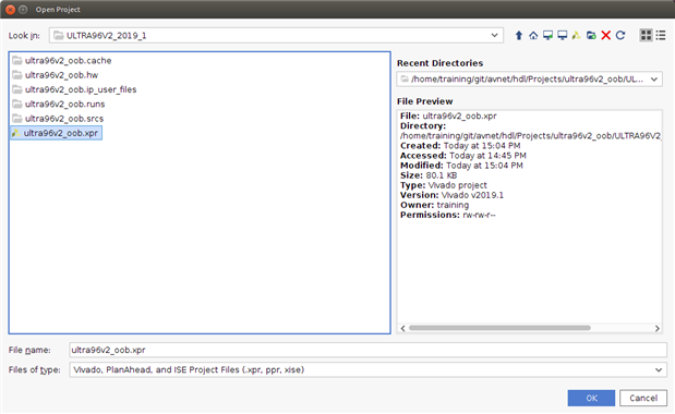

Click on Open Project in the Quick Start GUI pane and navigate to the Projects/<project>/<board_version> subfolder.
Select the project name and click OK to open to open it.

The build will begin and the GUI will display the progress as the block design is created and the design is built.

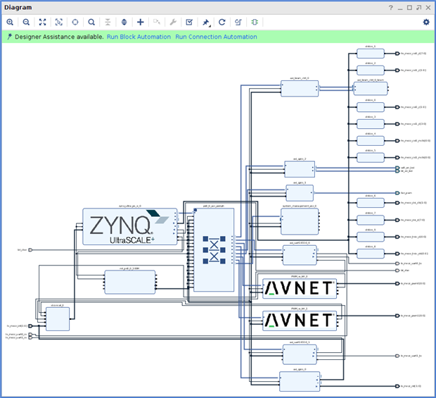

Examine the Completed Design
Once the Vivado design has finished building you can open the block design to examine how the design was built and customize it for your own needs.
