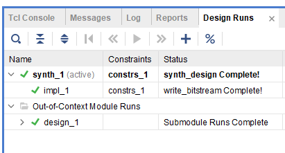

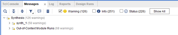

    Here's a screenshot from that Workshop #2 Vivado project -- no critical warnings. I think it is likely worth investigating what else is going on for you. Errors and critical warnings need addressing.
    Bryan
  • Andrew J
    0 Andrew J over 5 years ago in reply to bhfletcher
    Thanks, interesting.  And this was after generating the bitstream?  I’m not the only one who has seen these warnings judging by a message I’ve seen on the Xilinx website. I wonder if it’s a Linux version thing.
  • bhfletcher
    0 bhfletcher over 5 years ago in reply to Andrew J
    Yes, bitstream generation completed successfully.
