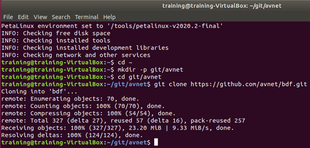

Now follow a few steps from narrucmot's blog Avnet HDL git HOWTO (Vivado 2020.1 and earlier) :
$ cd ~
$ mkdir -p git/avnet
$ cd git/avnet
$ git clone https://github.com/avnet/bdf.git

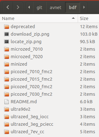

In this BDF archive that was just cloned, you can see folders for each one of the Avnet boards:
If you dig down into one of these folders, you will see different versions, and for each version, you will see a few XML files. It's beyond the scope of this blog to explain what is in those XML files except to summarize that it contains the default definition or "preset" to make the board work. For example, such things as clocking setup and DDR controller parameters to make that specific board work are embedded in those XMLs. There is detailed information about the XMLs in Appendix A of UG895. We've also discussed the possibility of running a training webinar to explain how to create your own BDFs, so if that is something that interests you, please put a comment below!

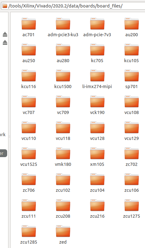

My next job is to make sure that Vivado can "see" my Avnet BDFs. There are multiple ways to do this. The brute force method (which I am NOT going to do) is to copy the BDF archive to the Xilinx tool installation, which for me is located at /tools/Xilinx/Vivado/2020.2/data/boards/board_files/. You can see that the default Xilinx tool installation populates a bunch of Xilinx boards here already.

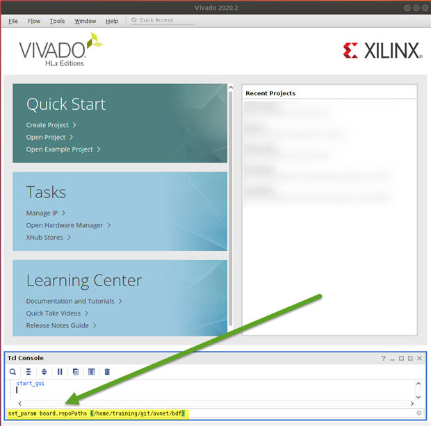

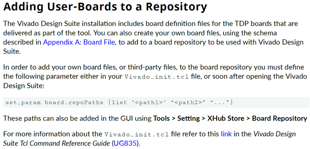

A much more elegant and cleaner way to allow Vivado to see my Avnet BDFs is to set the board.repoPaths parameter in Vivado. UG895 Chapter 2 says:
So, long-term, setting this in Vivado_init.tcl is the most efficient way to go, but for now, I will enter the tcl command manually after opening Vivado, remembering that I just cloned all the Avnet BDFs at location /home/training/git/avnet/bdf.
     set_param board.repoPaths {/home/training/git/avnet/bdf}

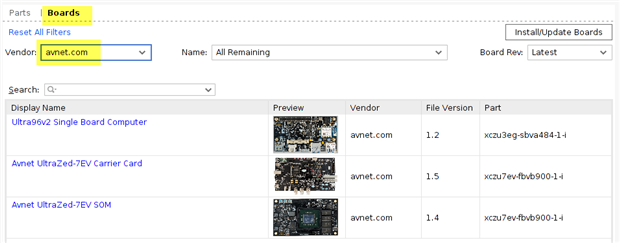

With that parameter now set, I can Create Project, chose Boards from Vendor avnet.com or em.avnet.com, and you'll be able to select an Avnet board. Incidentally, the vendor is based on the company URL. When Avnet started doing BDFs many years ago, our URL was em.avnet.com, which is why you see some of the older boards with that as the vendor. We are in the process of cleaning them all up and making them consistent, so you should only see "avnet.com" as the vendor here in the near future.
At this point, I can now create my project with Vivado understanding some of the base functionality of my board. While this is all very basic, it is essential to getting started with Vivado and an Avnet board. The rest of creating the project and applying the preset is a subject for another blog! Once you have your board definitions in place, move on to this blog:

    I'm glad you found it. I'll just remind everyone that this brute force method of copying to the installation folder is not recommended, although it definitely works, and it is the way I did it for years. It's highly recommended that you use the Repo method. In addition the TCL method that I detail above, you can also set this in the tools. Go to Tools --> Settings

    Okey, the new place is Vivado\2021.1\data\xhub\boards\XilinxBoardStore\boards\Avnet
  • davidfu
    davidfu over 5 years ago
    Hello Bryan,
    I'm using Vivado 2021.1, in the installed folder \xilinx\Vivado\2021.1\data\boards I can see no folder named board_files. Do I need to create this folder or go back to Vivado 2020? Or there is a new place to fit BDFs?
