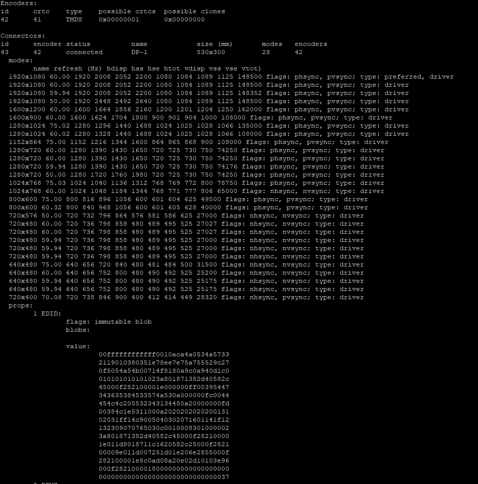

I've been working on a MPSoC design with a XU5Ev plateform. I've managed to get a video output from display port controller using petalinux and modetest.
Like many, I'd like to get an HDMI output, which is why I thought about using DP to HDMI adapter. I found this discussion on the forum : /products/devtools/avnetboardscommunity/avnetboard-forums/f/ultra96-hardware-design/38397/ultra96-v2-mini-dp-to-hdmi-adapter
In which the CD0095 seems to the solution. So I got the cable and tried it out !
Unfortunatly, no pattern on screen.
But, I did get the EDID from the screen :
which is quite encouraging.

    If the DisplayPort lanes are configured correctly in the hw platform and likewise for Linux in the devicetree, you should see colorbars if you run the modetest command:
    # modetest -D fd4a0000.display -s 43:1920x1080@RG16
    Yes, we use modetest and PetaLinux for our tests.
