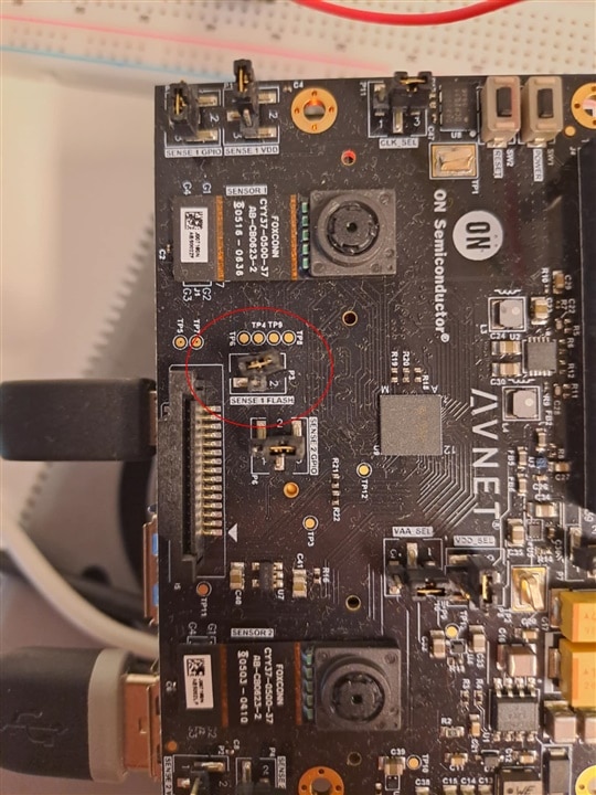

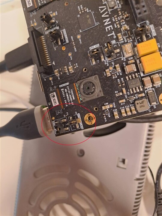

We use the onsemi Dual Camera Mezzanine and Ultra96v2 with a petalinux build. We need to enable the flash pins (see images) for synchronisation. Does anyone have any experience doing this?

    The signals for the FLASH control are on the SENSOR1_GPIO0 and SENSOR2_GPIO0 signals,
    which are routed to on-board headers P3 and P4.
    However, they are NOT routed back to the carrier board.
