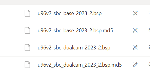

I'm using the prebuilt .img.gz from the Tria Vitis Platforms 2023.2 GitHub for Ultra96-V2. After flashing to SD and setting boot switches (SW3: 1=OFF, 2=ON), the board freezes at:
usbcore: registered new interface driver usbhid
usbhid: USB HID core driver
No USB devices are connected except micro usb to PC via the Avnet JTAG/UART pod. Is this a known issue? Could it be image corruption? There's no MD5 checksum provided — any help appreciated.

    I assume you are using the BSPs from the Sharepoint site? Those are pre-built and have checksums:
    Ultra96V2 has support through 2024.1.
    https://avnet.me/ZedSupport?ICID=microzed-datasheet-widget
    This link can be found on the Avnet boards page for the product you are working on under the REFERENCE DESIGNS tab. It will point you to the SharePoint site there.
