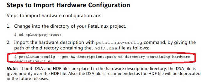

    kevinkeryk over 7 years ago
    Hi Anton,
    When you change the underlying hardware from the default included with the BSP, you will need to pull the new hardware description into your PetaLinux project using the "petalinux-config --get-hw-description=" command as outlined in UG1144:
    Once you get the new hardware configuration pulled in, build everything by running "petalinux-build" command.
    Finally, you can package everything up with your "petalinux-package" command.
    As for getting your application working, my suggestion is to get it working as a new SDK Linux application project first, then pull the application code into a new PetaLinux app under your PetaLinux project.
