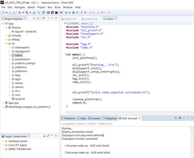

I'm trying to implement a bare metal design of the Displayport using Ultrazed EV using live video for the PL side.
The Ultrazed EV uses a single lane for the Displayport so I followed the mods suggested here by Xilinx:
https://www.xilinx.com/support/answers/71416.html
However it still does not work.
I'm using this active Displaypor to HDMI adapter.
https://www.amazon.ca/dp/B00EDT0072?ref_=pe_3034960_233158960_shiptrack_e_404_dt_1
The SDK app was based on the code for Ultra96 from Adam Taylor with the proper modifications for the number of lanes.
Is there any example from Avnet for Displayport?

    DisplayPort<->HDMI adapters are notoriously finicky.  The key for Ultra96 and UltraZed is to make sure it is an "active" adapter.  Many are not, and those are known to not work.  We recommend this adapter from AbleConn:
    https://www.amazon.com/Ableconn-MDPHD4KAA-DisplayPort-Thunderbolt-3840x2160/dp/B00Y07LLPM?ref_=ast_sto_dp
    We do not have a bare-metal DisplayPort reference design for the UltraZed-EV.  Instead I suggest using the posted PetaLinux BSP.  Though not bare-metal, this can be used to validate your DP<->HDMI adapter is working.  The included Vivado hardware platform can also be used to validate the PS configuration settings for the clocking and DP xcvrs.
    --Tom

    The link you posted is a mini_Display port cable. I have one and it works OK with Ultra96V1.
    I think the issue is with the SDK firmware at the moment. Still troubleshooting.

    I uploaded the current version of the code:
    https://github.com/Q-point/Ultrazed_EV_DisplayPort
    The Adam Taylor git repo I was referring is for Ultra96 so there are differences:
    https://github.com/ATaylorCEngFIET/Ultra96V2_MIPI_PCAM_VITIS/tree/master/display_port.xpr/display_port
    Regarding the VCU , I'm aware of that but I wanted to try something new, not just replicate Jason's project. However I plan to integrate the VCU on PYNQ later. I used the same commands to test the display though.
    I tested with with a Linux version from Albertabeef (Hackster project) and I see the monitor gets detected but there's no picture. I'll try another HDMI monitor and provide an update by next week when I post the review.
