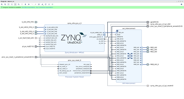

The MPSOC Subsystem design:
  • MPSOC AXI Connections from the ZCU106 VCU TRD Design
    • AXI High Performance (non coherent) connections for
      • VCU Encoder data (S_HP2)
      • VCU Decoder data (S_HP3)
      • AXI Interconnect Block (M_HPM0)
    • AXI High Performance (coherent) connections for
      • VCU MCU (S_HPC0)
  • AXI Interconnect Block Connections from the ZCU106 VCU TRD
    • IRQ Generation (M04)
    • VCU (M08)
  • AXI Interconnect Block Connections from the UZ Petalinux design
    • On-board DIP Switches (M00)
    • On-board LEDs (M01)
    • On-board Pushbutton Switches (M02)

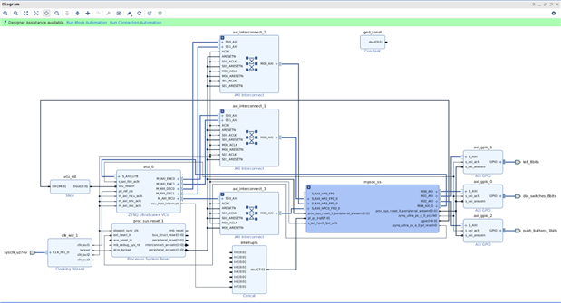

The Top Level Design:
  • PL blocks from the ZCU106 VCU TRD Design
    • 3 x AXI Interconnect Blocks for
      • VCU Encoder
      • VCU Decoder
      • VCU MCU
    • 1 x Reset Slice for GPIO-based VCU Reset
    • 1 x Concat block for IRQ routing
    • 1 x Clock Wizard Block for
      • Generating the VCU Clock
      • Generating the High Speed AXI bus clock (VCU and Display Related)
  • PL blocks from the UZ Petalinux Design
    • 3 x AXI GPIO blocks for
      • On-board LEDs
