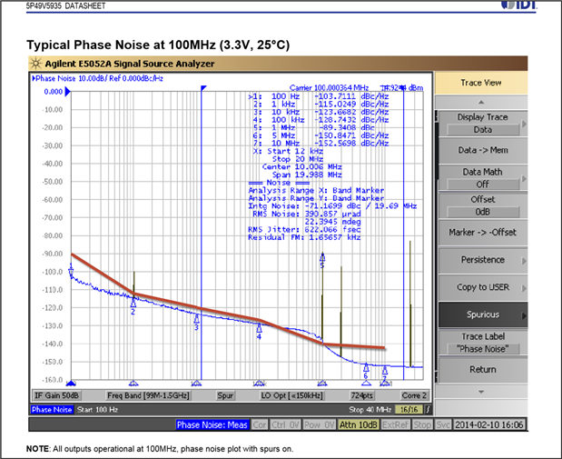

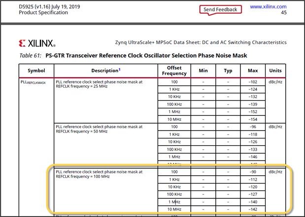

    Apologies for using this old forum post, but there aren't a lot of discussions here regarding the matter I'm looking into.
    I see that the 5P49V5935B536LTGI is used on Avnet's UltraZED Carrier Card to generate GTR reference clocks for the Zynq+ on the UltraZED. I've downloaded the datasheet for this part from IDT.
    Fortunately, the datasheet contains a representative phase noise plot of the device when it's creating a clock that's appropriate for use as a GTR reference--i.e., 100 MHz.
    Unfortunately, this device does not seem to comply with the required phase noise mask of the Zynq+ device, for GTR reference clocks. This mask is called out in Table 61 of the Xilinx document DS925.
    Below is a screen grab of the phase noise graph from the data sheet, and I've drawn the Zynq's phase noise mask on top of it as a red line.
    Can you tell me if and how you've dealt with this discrepancy?

    0 drozwood90 over 6 years ago in reply to jgalibois
    Hi there,
    We worked with IDT on this and based on that effort validated the clock as valid for the uses we needed within our system.
    If you have further concerns, you can contact your local FAE and they have a mechanism to contact IDT and leverage the same Engineering team to assist you with your design.
