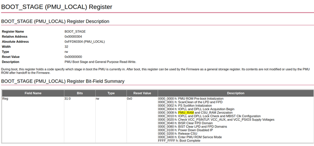

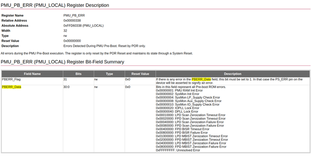

I was wondering if someone could explain the mechanism of the red LED3:  PS_ERROR_OUT
I know the label says something like : there is an error on the PS side :-) but I like to comprehend what is causing the led to light up.

    Hi Deville, This led is driven by the MPSoC. It could be caused by numerous issues. To determine your exact issue it would require you diving into the register set for the 3EG device. https://www.xilinx…

  • deville
    0 deville over 7 years ago in reply to jafoste4
    Thanks for the link Joshua,
    It must be the PMU RAM init error then which causes this. caused on its turn by a PMU RAM init error. This does not explain the 8 seconds delay on the Ultrazed-EV board but this is close.
    Very interesting.

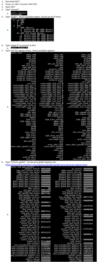

  • jafoste4
    0 jafoste4 over 7 years ago in reply to deville
    Hi Deville,
    These are the steps I have used in the past to read these registers on an Ultra96 board. Perhaps you can recreate these and see what you get? I would be interested in this aswell.

  • deville
    Thanks for your guide. I think this would come in handy later on.
    Concerning the LED ERR led.
    I'm no expert at this but I can't read out PMU_LOCAL. It is not present in the "rrd" register overview. I also noticed this in your example.
    The online register page you've provided states for BOOT_STAGE:
    During boot, this register holds a code specify which stage in boot the PMU is currently in. After boot, this register can be used by the Firmware as a general storage register. Its contents are not modified or used by the PMU ROM after handoff to the Firmware.
    So, I wonder. It this the reason I can't read out these boot status registers?

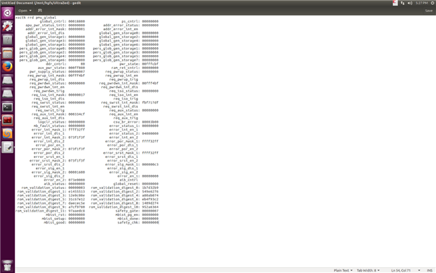

  • jafoste4
    Hi Deville,
    Reading through the register page, it shows that register set as private. How interesting, reading through the  TRM these are only accessible via the PMU.
    Mind collecting a dump of the PMU_Global register set and pasting it here? We may find a clue there.

  • deville
    Ok I missed the private thing, Good call.
    Here, at our firm,  we concluded that since the LED has multiple error causes there must be some underlying mechanism. Even when the SD is pulled out there is no FSBL nor PMU firmware present, yet the LED lights up. We think the CSU handles this.
    Looking at my log: CSU_BR_ERROR says: 0x3B. From the manual UG1085 on page 242:  0x3B Reading failed from the selected boot device.  ( yes, I unplugged my SD card to generate an error )
    I saw your device is having error 0x23:  Error occurred during QSPI 24 boot mode initialization
    Here is my register log:
