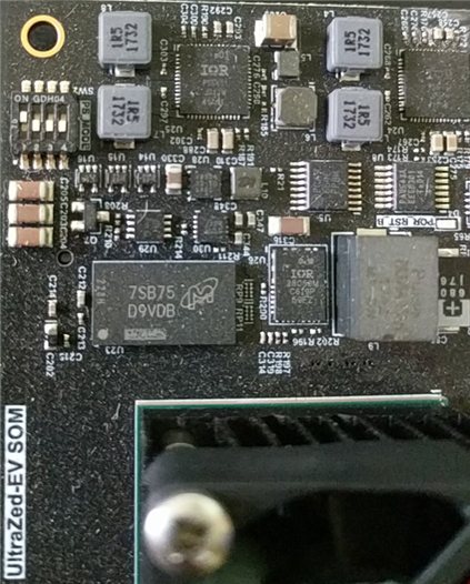

  • drozwood90
    0 drozwood90 over 6 years ago
    Hi Liyong,
    I can't be 100% sure this is your issue, but that nugget of information leads me to believe you do not have your boot switches set properly.
    The board ships from the factory setup for QSPI boot.  That factory test image is from 2017.3.
    You need to change the boot jumpers on the SOM to be SDCARD Boot.
    Left to RIGHT as depicted in the below image
    ON OFF OFF OFF
    --Dan

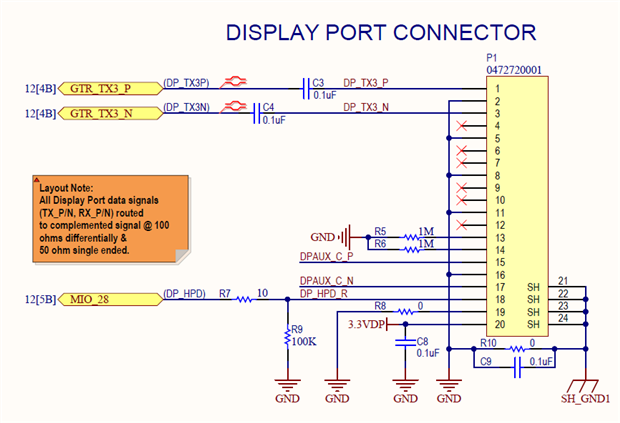

    (2) I have a 4K monitor. I could recognize that on ZCU106, but only 1920x1080 on Ultrazed. Was there some limitation on the display port hardware of carrier card or SOM?

    2) while the UltraZed-EV SOM supports 4K2K, the CURRENT Carrier does it using a SINGLE lane.  There are FEW monitors out there that support the full 4K in a single lane.  Thus we see almost all monitors we attach run at 1080P.  There are things in the works regarding this, but the solution you have right now (as it was explained to me) is get a really expensive monitor that can support a single lane 4K2K or live with 1080P while using our current carrier card.  A custom carrier would solve this issue.

  • narrucmot
    0 narrucmot over 6 years ago in reply to ontran
    Hi Liyong,
    The UltraZed may not recognize the high resolution of your 4K monitor because it is limited to just one lane of DP video.  Here is a screenshot from DP connector in the schematics:
    It is my understanding that UHD or 4K video requires 2 lanes of DisplayPort.  If this is a requirement you may want to take a look at the UltraZed-EG SOM with the I/O carrier.  The Zynq MPSoC device on the UltraZed-EG SOM has a smaller PL and doesn't have the VCU that the UltraZed-EV does, but if you need 4K video this may be an option for you.  Keep in mind only the UltraZed-EG I/O carrier has two lanes of DP video.
    --Tom
    • Reject Answer

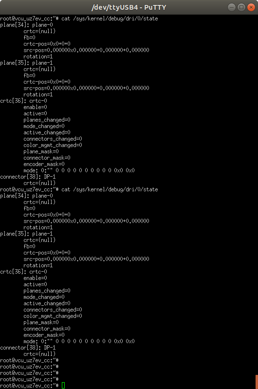

  • petercaddick
    0 petercaddick over 5 years ago
    Hi
    I too am having this same problem. I have the jumpers set correctly but I don't see anything on the display port.
    When I type cat /sys/kernel/debug/dri/0/state I don't get the output in the test screen, I get:
    note that the mode is all zero. I have a display attached to the display port. I've checked the voltages on the board. It seems all is ok apart from no image on the display. Any suggestions please?
