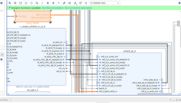

    Hi Daniel, I saw the project and i see that just "HDMI_RX_CLK_P_IN " (PIN "set_property PACKAGE_PIN B10") is going inside the FPGA. They dont need both ? (differential pins).
    Im having issues related with this but in my proyect. This  "HDMI_RX_CLK_P_IN " clock should be 148.5MHz ? because in my case i need that CLK for SDI.

  • francaprgonz
    0 francaprgonz over 4 years ago in reply to drozwood90
    How can i check if im geting the clk signal inside the FPGA ? If i try to connect in ILA (IBUF_OUT), it say that i can connect just in GTH pins, so i dont know how validate it.
    set_property IOSTANDARD LVDS [get_ports {CLK_IN_D_0_clk_p}]
    set_property PACKAGE_PIN D10 [get_ports {CLK_IN_D_0_clk_p}]
  • drozwood90
    0 drozwood90 over 4 years ago in reply to francaprgonz
    Hi there,
    You can take that clock and pipe it back out with appropriate divisors.
    Although, personally, if the GTH is running (use something like IBERT), then it is connected.
    --Dan
