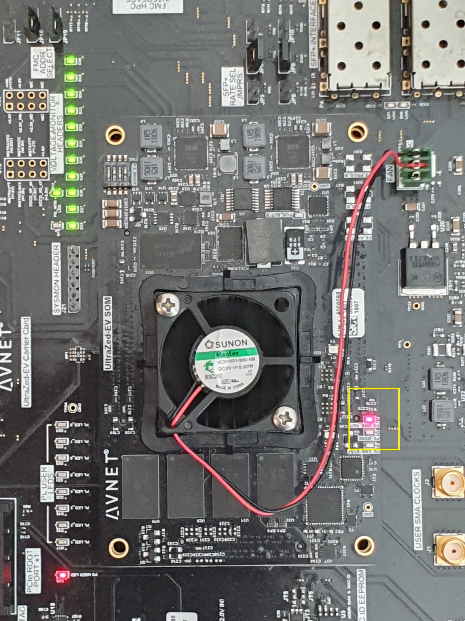

HI,
I used to build petalinux and copy the boot and image to sd card. Everything worked.
Now When I trying to boot, PS_ERR_OUT led is red, and there is no log at all,
so I wonderif the SOM got corrupted, or the multiplexer between boot medium
don't work.
I checked with different sd card, no change.
QSPI, JTAG,EMMC boot modes are working.
Any suggestions on how to further check the issue?

    The issue is occur on 2 different SOM on the same carrier card. I read the pmu_global registers according to that thread:
     /products/devtools/avnetboardscommunity/avnetboard-forums/f/ultrazed-hardware-design/38046/avnet-ultrazed-ev-red-led-when-boot-fails
    I added text file and photo.
