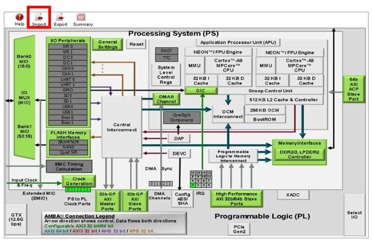

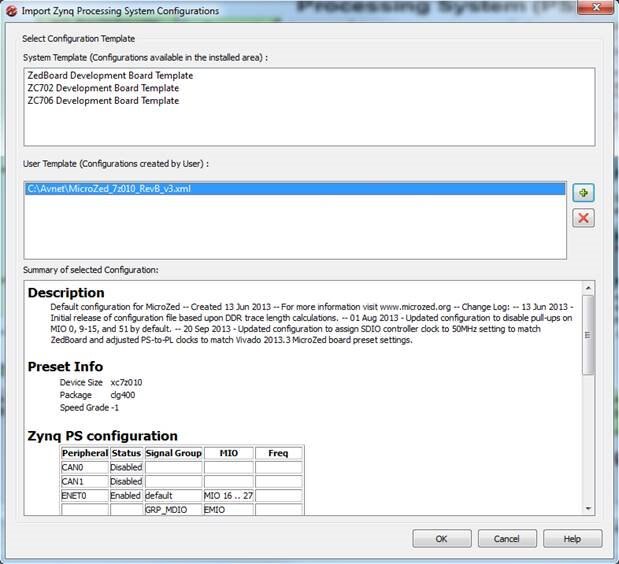

    Use the MicroZed Zynq Preset for ISE (XML) found here: http://www.zedboard.org/documentation/1519 Import the preset into your PS7 configuration in XPS: Then select the XML file downloaded: -Gary
    0 e14 Contributor over 12 years ago
