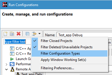

The trainig material says that to run a linux application, choose Run as -> Run configuration -> Remote Arm Linux Application. But I don't see a "Remote Arm Linux application" option any more in SDK 2017.3 . Where is this option now ? Also same issue when setting Debug configuration, the " Remote Arm Linux App" option is no longer there. Also when using GDB my understanding is gdbserver is needed on zynq board but it doesnt seem to be avialble in the prebuild release. When I do which gdbserver on zedboard it doesnt find it. Thanks

    Try Run->Run Configurations ...
    Then from the dropdown un-select 'Filter Configuration Types'
