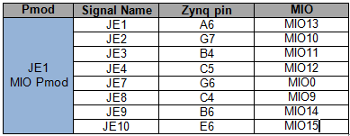

I'm currently trying to implement the CAN Controller from the PS into a design of mine.
The frist step was just to activate the CAN0 in the XPS and then making the synthesis work in Plan Ahead. I read in the Hardware User Guide, that the Pmod JE has hardwired connections to specific MIO-pins. Is that correct?
For instance, if I select MIO_14 and 15 for CAN_Rx and CAN_Tx, the signals would already be at the respective Pmod connection.
I tested the CAN Controller with the example codes and it all works fine when the Controller is in loopback mode. However, once I change the mode to normal and want to manually loopback Tx to Rx, it doesn't work anymore.
Can somebody give me a quick tutorial on how to implement the CAN Controller, just to rule out any design problems? Initially I thought that if the loopback modes work, the implementation is fine but now I'm not so sure anymore. Or does the CAN Controller need any specific hardware on the Zedboard? I have an external transceiver but since I don't even get the Tx signal out of the board, I'm pretty sure that that is not the problem.

    Check out this AR -- http://www.xilinx.com/support/answers/55133.htm
    JE does have hard-wired connections to the MIO. Here's a table from the ZedBoard UG with an MIO column added. If you configured the CAN controller to connect to MIOs 14, 15, then you should be looking at JE9 and JE10.
    It might be helpful if you share your code for setting up the CAN controller.
    Bryan

    Thank you Bryan for your response.
    I actually just used the xcanps_polled_example.c example from Xilinx ISE. Instead of loopback mode I just inserted nomrmal mode and thought that it should work, when I connect the Rx and Tx port of the Pmod.
