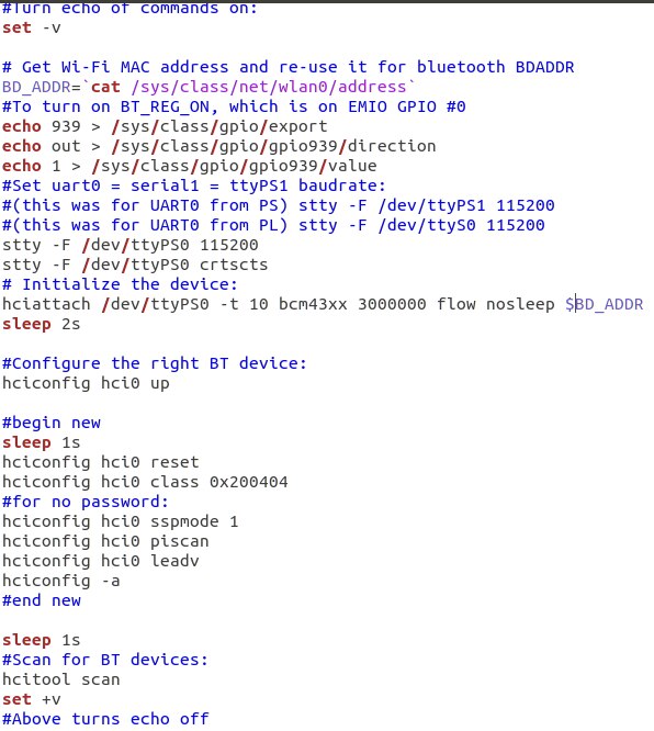

Hello everybody,
I'm trying to enable Wi-Fi & Bluetooth connectivity to the ZedBoard, using the 1DX Wi-Fi/BT module (LBEE5KL1DX-883)
A complete tutorial has already been done here: Adding Wi-Fi and Bluetooth Connectivity to the ZedBoard using the Murata 1DX Pmod
I succeeded in enabling Wi-Fi, but I'm facing a persistent issue when I try to enable Bluetooth.
I'm using the Harware design provided here (Reference designs section): https://www.avnet.com/wps/portal/us/products/avnet-boards/avnet-board-families/zedboard/
Here is the script I run to enable Bluetooth:

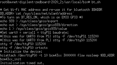

And here is the issue (bluetooth LED is turned ON when the script is launched):
Is somebody able to know where I should go to fix this issue concerning hciattach?

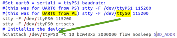

    Looking at your block diagram, you are using a PL-based, AXI-uart16550 for your Bluetooth UART interface. However, assuming these old comments are accurate, you are pointing things to the PS-based UART0…
  • bhfletcher
    bhfletcher over 5 years ago in reply to 3d_srv +1
    Hopefully some of the other software experts can chime in. From what I can tell from your hardware block diagram, you are using a PL-based UART to connect to the Bluetooth. If the PL-based TTYS* device…

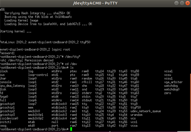

    Looking at your block diagram, you are using a PL-based, AXI-uart16550 for your Bluetooth UART interface. However, assuming these old comments are accurate, you are pointing things to the PS-based UART0:
    I suggest you look at /dev/tty* and see what you actually have there.
    Bryan
  • 3d_srv
    0 3d_srv over 5 years ago in reply to bhfletcher
    here is the list for /dev/tty. I guess it is initialising PS uart.

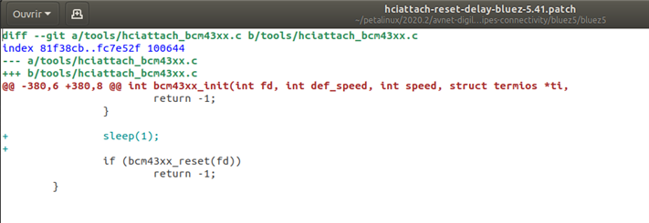

    Here is the patch for hciattach command. It is placed in /project-spec/recipe-connectivity/bluez5/bluez5/hciattach-reset-delay-bluez-5.41.patchimage
    Is this patch in the right folder in order to be taken into account?
    Could you please help me to understand the issue?
    Thanks
  • bhfletcher
    0 bhfletcher over 5 years ago in reply to 3d_srv
    Hopefully some of the other software experts can chime in. From what I can tell from your hardware block diagram, you are using a PL-based UART to connect to the Bluetooth. If the PL-based TTYS* device is not showing up in your /dev folder, then I'm guessing that is a devicetree issue, but again, that's not my area of expertise. If you are trying to use the PS-based UART to connect to the Bluetooth, then you need to change your block design.
    Bryan

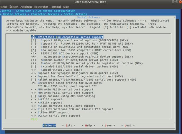

    So my problem is coming from the UART 16550 block which is not recognized and should be as /dev/ttyS0, isn't it?
    It seems that this block raised recent problems:
    https://forums.xilinx.com/t5/Embedded-Linux/Uart-16550-IP-not-showing-up-in-Petalinux/td-p/1187552
    I will check if "device tree based probing for 8250 ports" is enabled on the kernel config and I will give an update.
    Thanks for your help!
  • 3d_srv
    Update:
    It's working, and it was exactly what I thought : if you want ttyS0 to appear you have to make sure the UART IP block is recognized. The problem is that it's not documented at all:
    UART 16550 IP block needs some options available with petalinux-config -c kernel:
    - 8250/16550 and compatible serial support
         - Support 8250_core.* kernel options
         - DMA support for 16550 compatible UART controllers
    - Devicetree base probing for 8250 ports
    - Cadence (Xilinx Zynq) UART support
    - Cadence UART console support
    And then the hciattach function does not return any time out, and Bluetooth pairing works fine.
