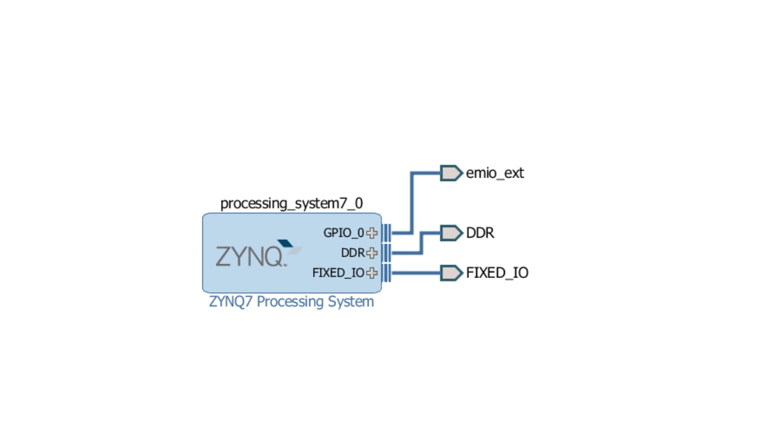

    I don't see any obvious problem in the source code you shared (I compared it with this code of mine, which I know for sure works).
    I can only speculate there may be an issue in the HW design. I suggest you share screenshot of your Vivado Diagram.

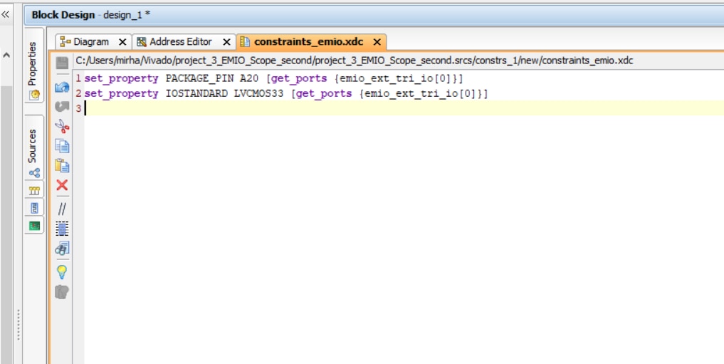

    0 trickntreat over 2 years ago in reply to viktornikolov
    I have kept the EMIO width to 1 only .
    This is an auto generated constraints file when i sythesise the project and put the pin number in GUI .
    Maybe i should try change the constraint file to match the Hw design external pin number ?
