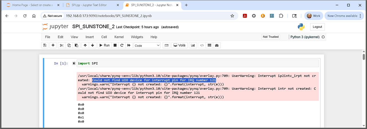

    ATT: my approach (eMMC image) has one issue:
    I cannot use a PL block diagram with axi_intc_0!
    It works fine with PYNQ imaged and booted from SD card: my INT via axi_intc_0 (signal axi_gpio_0/ip2intc_irpt used) works fine.
    But booting my (modified image) from eMMC complains with an error about "Interrupt ip2intc_irpt not created" and "Could not find UIO device for interrupt pin for IRQ number 121"
    I assume, the device tree is still not correct (even it sees the eMMC module, but not this signal from block diagram (in overlay bit file)).
    OK, what to do?
    Potentially: I'd like to get a ZUBoard PYNQ image which supports the AVNET eMMC module and works also for all regular PYNQ features (when booting from eMMC).
    I am not the big expert to figure out how to modify the PYNQ GitHub project for it.

    if you want to use axi_intc and INT signals - important how you set the bootargs:
    setenv bootargs "console=ttyPS0,115200 earlycon clk_ignore_unused uio_pdrv_generic.of_id=generic-uio root=/dev/mmcblk1p2 rw rootwait cma=512M"
    saveenv
    boot
