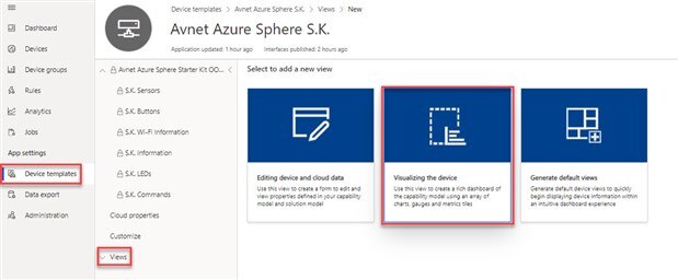

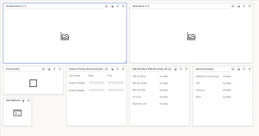

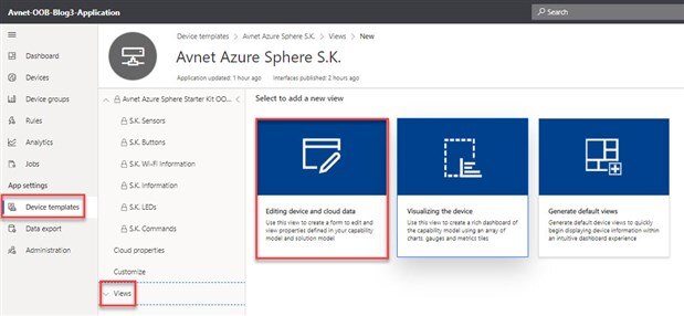

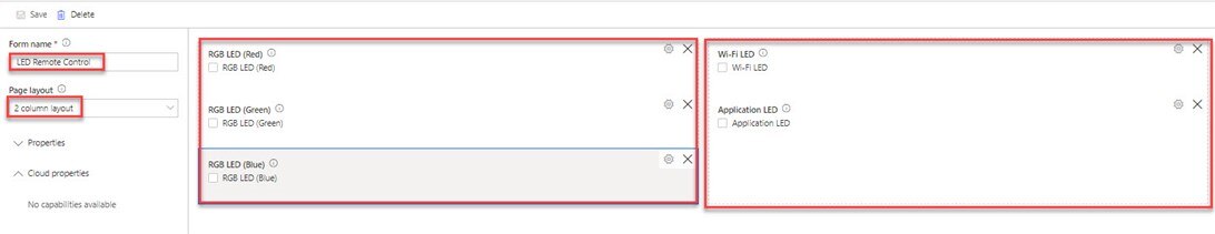

    • Create custom views (Build from Scratch)
      • LED Remote Control View
      • Device Data View (Build from Scratch)
    • Publish your Device Template (Build from Scratch)

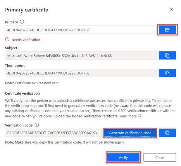

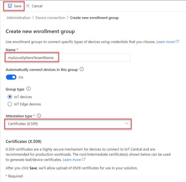

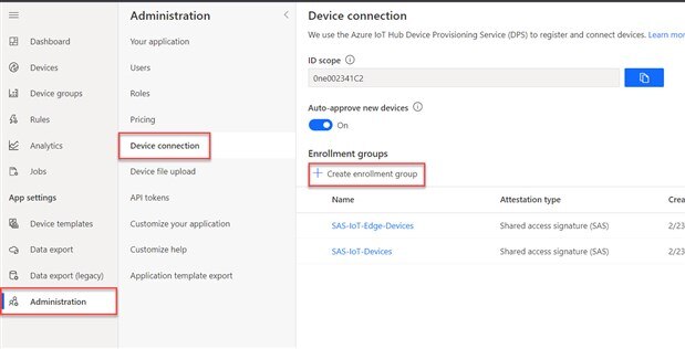

  • Configure DPS for our Application (Both)
    • Download the public tenant CA certificate (Both)

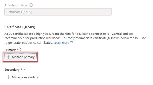

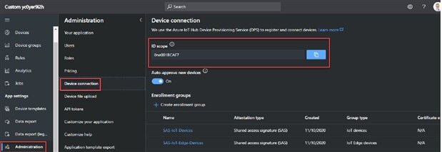

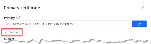

    • Upload the public tenant CA certificate to Azure IoT Central and generate a verification code (Both)
    • Generate and download the verification certificate (Both)

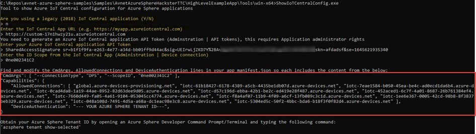

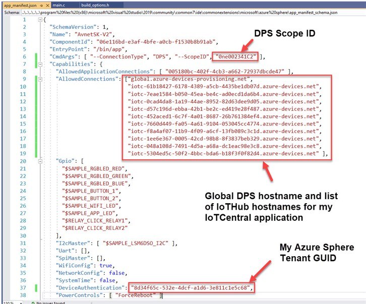

  • Configure our application to connect to the IoT Central Application (Both)
    • Find all the required information for our Azure Sphere app_manifest.json file (Both)
  • Modify the Azure Sphere source code (Both)
    • Updating the app_manifest.json file (Both)

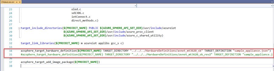

    • Update the CMakeLists.txt file to define which Avnet Azure Sphere Kit you are using Rev1 or Rev1 (Both)

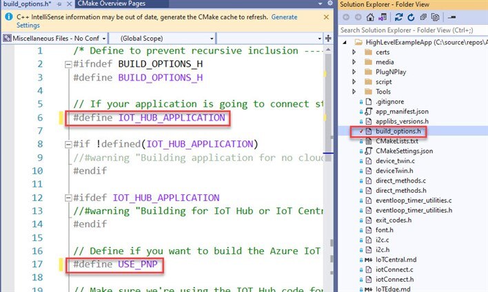

    • Update the build options (Both)

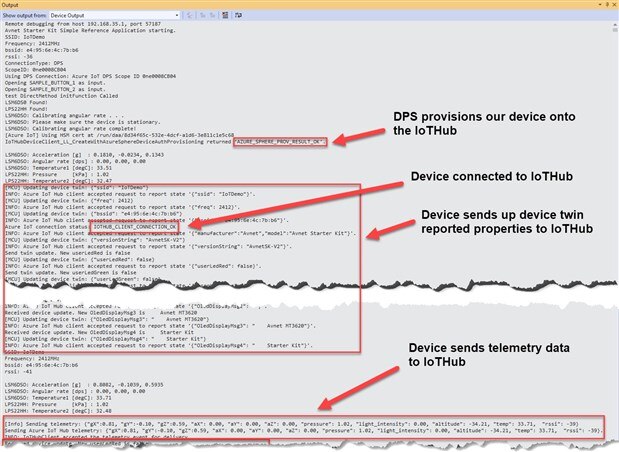

I’ll make the assumption that you’ve completed the simplified non-connected example.  If not, please go back and complete that examplehere. For the IoT Central lab the following prerequisites must be met.

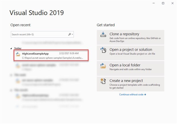

  • Visual Studio 2019 and the Azure Sphere SDK are installed and confirmed working
  • You were able to run the non-connected example without any issues (link)
  • Your device is connected to a Wi-Fi access point and has access to the internet

Our application will have the following features
  • Display X, Y and Z axis g-force (gravitational force equivalent data label named GForce) measurements from the built in LSM6DSO accelerometer in a graph
  • Display X, Y and Z axis angular rate measurements from the built in LSM6DSO gyroscope
  • Display pressure reading from the built in LPS22HH device
  • Display event data generated when user buttons A or B are pressed
  • Allow the user to toggle the User RGB Red, Green, and Blue LEDs from the application
  • Allow the user to toggle the WLAN and APP LEDs from the application
  • Display the current firmware version running on the Starter Kit
  • Display the current connected Starter Kit Wi-Fi SSID
  • Display the Wi-Fi AP bssid
  • Display the current Wi-Fi network and frequency
  • Remotely exit the application using a direct method call

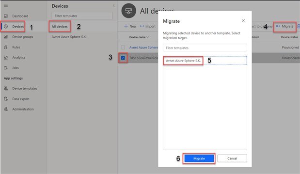

  • Migrate our device to the device template

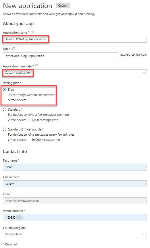

The first step is to create the application.  Follow this link to create a new custom IoT Central Application.
You should see a screen similar to the one shown below:
  • Create a name for your application.  Note that this name must be unique across all of Azure since your application name will also be used for the URL.  If you provide a name that’s already taken, you’ll get an error message stating the issue.
  • Select the “Custom Application” option.  The other option is "Custom Application (legacy)"  The new IoT Central is much different, these instructions will not correlate with the legacy implementation.
  • Select the “Trial” option for a free 7-day trial.  You can also select the Pay-As-You-Go option; you’ll need an Azure account with a balance or a pay-as-you-go account associated with a credit card if you choose this option.  When the 7-day trial expires, you'll have the opportunity to convert your application to a paid account.
  • Click the “Create” Button

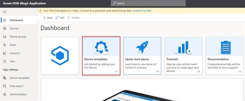

Your application will be provisioned on Azure and you’ll be taken to the main page of your application.
Here you’ll see the landing page.  The first thing we need to do is to create a “Device Template,” so click on the Device templates tile.
Create a device template (Build from Scratch)

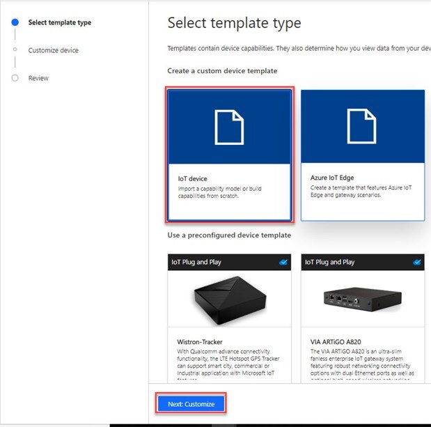

A device template is where we’ll define all the information and interactions for our device.

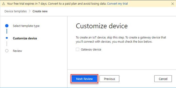

  • Select the "IoT device" tile
    • Note that all the current certified IoT Plug and Play devices are also available from this page.
  • Click on the "Next: Customize" button at the bottom of the page
  • Select "Next: Review"

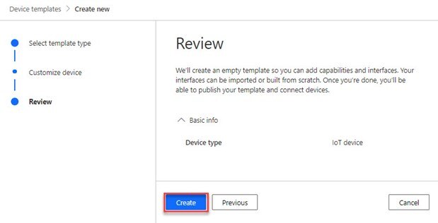

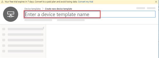

  • Click on the "Create" button to create and empty template

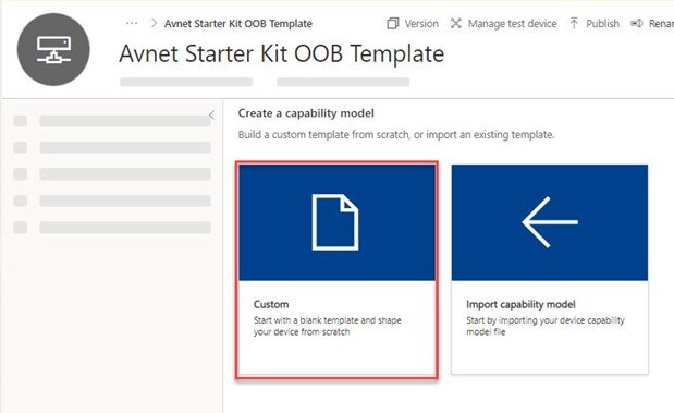

  • Name your template.  I selected "Avnet Starter Kit OOB Template"
  • Next you have the option of creating a custom template or importing a capability model (Optional)
    • If you like you can import my capability model by downloading the json file from here.
      • After you download the file, click on the "Import capability model" tile and select the file
      • I recommend you browse the rest of this section to understand how to add new data items to the application
      • You can skip to the section titled "Create Custom Views"

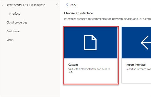

  • Click on the "Custom" tile

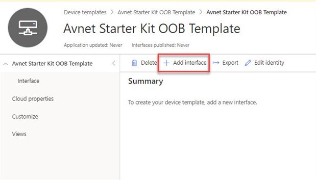

  • Next we'll create a custom interface
    • The interface is where we'll define all the telemetry data that our application is sending up
    • Best practice is to group like things into separate interfaces.  For example we'll create the following interfaces . . .
      • Buttons
      • Wi-Fi information
      • Information
      • LEDs
      • Commands
  • Click on the "+ Add interface" link
  • Select the "Custom" tile

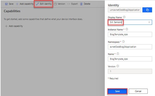

  • Rename the interface by selecting "Edit identity"
  • Type the new interface name into the "Display Name" field such as "S.K. Sensors"
  • Click on the "Save" button

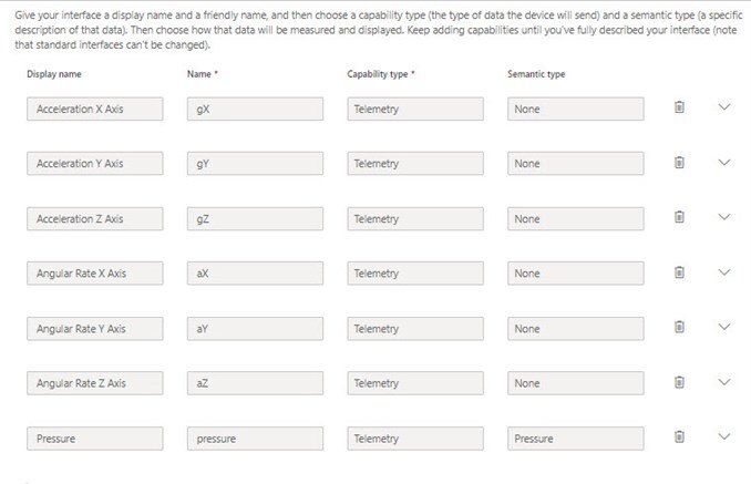

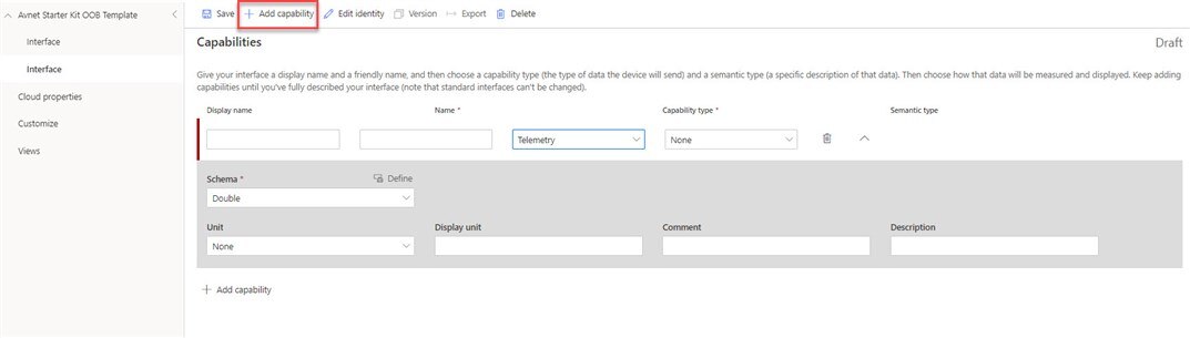

Next we'll add all the sensor capabilities for our application
  • Click on the "+ Add capability" link to bring up the Capabilities interface
This is where we will define the sensor properties for this interface.  In this interface we can configure telemetry, device twins and remote method calls.  For the sensors we'll configure telemetry items.

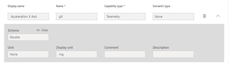

For the first example we're going to add the X Axis g-Force telemetry item.  To do this we just need to fill out the form.
  • Display Name: The name of the telemetry item to add, enter "Acceleration X Axis"
  • Name: This is the “key” string of the {“key”: value} key pair telemetry data.  The sample Azure Sphere application uses “gX” for the X g-force component, so we enter “gX” in this field.
    • Note that the interface automatically transferred the "Display Name" string to this field for you.  You can change it if you need to.
    • Make sure you match the case of the "key"
  • Telemetry | Command | Property: Select "Telemetry"
    • Telemetry is used for, you guessed it telemetry data from the device
    • Command is used for commands or direct methods to the device
    • Property is used for Device Twin Properties
  • Semantic type: This is used to pre-select the data representation.  For example Acceleration, Pressure . . .
    • If you don't select a "Semantic" type you can enter custom units
    • Select "None"
  • Schema: Select "Double"
  • Units: Our data is in milli-g so ideally we would select “mg,” but this is not an option.  Select "None"
  • Display Unit: Type in "mg"
  • Comment: Add any comment you wish
  • Description: Any description you wish
We just defined a Telemetry item!  Your screen should look similar to mine . . .
At this point we can click the "Save" icon to save our work.
  • On your own, using the "+ Add capability" link add the following telemetry items
Display NameNameCapability TypeSemantic typeSchemaUnitDisplay unitCommentDescription
Acceleration X Axis
gXTelemetryNoneDoubleNonemg
Acceleration Y AxisgYTelemetryNoneDoubleNonemg
Acceleration Z AxisgZTelemetryNoneDoubleNonemg
Angular Rate X AxisaXTelemetryNoneDoubleNonemdps
Angular Rate Y AxisaYTelemetryNoneDoubleNonemdps
Angular Rate Z AxisaZTelemetryNoneDoubleNonemdps
PressurepressureTelemetryPressureDoubleNonehPa
  • Save your work by clicking on the "Save" link at the top of the form
I've rolled up all my Telemetry items, but your screen should look similar to the graphic below . . .
Add Button Interface (Build from Scratch)
  • Add a new interface by clicking on the top level of the Template then "+ Add interface"
  • Using the same steps we used for creating the "Sensors" interface above, create the "Buttons" interface
    • Rename the interface "Buttons"

2. Device Data
This view will graph the acceleration, angular rate and pressure data.  We'll also add some status data and a link to run the "Halt Application" direct method
  • You should still be on your device template screen, if not click on the "Device templates" link in the left most pane of the IoT Central Application
  • Click on "Views"
  • Click on the "Editing device and cloud data" tile
  • The view form opens
  • Change your form name to "LED Remote Control"
  • Select "2 column layout"
  • Expand the "Properties" item
    • Note that you see all the interface items of type "Property" (device twin)
  • There are two ways to get items from the list into the view
    • Click the box next to each item you want to add and click the "Add section" button at the bottom of the interface (should that be "Add selection?")
    • Click and drag each item over with your mouse
  • Update your view to look like mine, or do your own thing
  • Click on the "Save" link at the top of the interface
  • Create a new view by selecting the "Visualizing the device" tile
  • Build out the view to look like mine, or create your own
  • Hints
    • Try selecting multiple telemetry items (check boxes), then the "Add tile" link
    • Try dragging single items from the list to the view (Pressure)
    • You can resize tiles from the menu on the tile, or by dragging the corners
    • You can change properties of each tile by clicking on the gear icon on the tile (tile title for example)
  • One you're happy with your view, click on the "Save" link at the top of the interface
In your new IoT Central application
  • Select the Administration --> Device connection
  • Select the “+ Create enrollment group" link
  • The "Create new enrollment group" dialog opens
    • Give your enrollment group a name, I recommend using the same name as your Azure Sphere Tenant
    • Select the "Certificates (X.509) Attestation type
    • Click on the "Save" link at the top of the dialog
  • After clicking on the "Save" link the dialog will remain open, but there will be additional information at the bottom of the form
  • Click on the "+ Manage primary" link to add our Azure Sphere Tenant CA public certificate
  • Note the "+ Manage secondary" link.  In a real world deployment you would use this link to add a secondary certificate.  The Azure Sphere CA certificate has a lifetime of 2-years.  Towards the end of the 2-year period a new certificate is automatically generated by the Azure Sphere Security Service (AS3).  You can upload and verify the new/update certificate using the secondary link so that there is not a lapse in coverage when the primary certificate expires.
  • The Primary Certificate dialog opens
  • Click on the folder icon next to the Primary input box
  • Browse your file system and select the CA certificate we download above
  • The interface parses the certificate and displays the Subject and Thumbprint from the certificate
  • Click the "Generate verification code" link to generate a verification code
Next we need to generate a validation certificate using the Azure Sphere CLI.  In this next step we're proving to the IoT Central application that we have access to the Azure Sphere Tenant and the private key.  This is accomplished by providing a IoT Central generated verification code to the Azure Sphere CLI.  Using the verification code AS3 will create a verification certificate that contains the verification code in the subject field.  The certificate is encrypted using the Azure Sphere Tenant Private key, and since we uploaded the Azure Sphere Public CA Certificate, the IoT Central application can decrypt the verification certificate and validate that the subject matches the verification code that it generated.  At that point the IoT Central application assumes that since we can generate an encrypted certificate that it can decrypt with the CA certificate that we have access or the authority to manage devices in the Azure Sphere Tenant.
  • Copy and paste in the command below to generate and download the verification certificate, make sure to replace the <code> text with the verification code from your IoT Central application
    • CLI V1
      • azsphere ca download-proof --output validation.cer --verificationcode <code>
    • CLI V2
      • azsphere ca-certificate download-proof --destination-file validation.cer --verification-code <code>
  • Note the output file must have the .cer extension
  • Click on the "Verify" link
  • Browse your file system and select the verification certificate we just downloaded
Your certificate is uploaded and a notification is displayed stating that the certificate has been “Verified.”
  • Click on the "Save" link at the top of the form before exiting
That completes this task.  Now any devices from our tenant that try to connect to our IoT Central application with the proper DPS scope ID will automatically be provisioned to our application.

We're going to use a tool called "ShowIoTCentralConfig.exe" to pull all the bits we need to populate our app_manifest.json file.  This utility is included in the repo along with the Avnet example code.
  • There are 4 pieces of information we need to provide for our application to connect to our IoT Central application
    • DPS Scope ID (This is case sensitive)
    • DPS Global Endpoint FQDN (This is case sensitive!)
    • IoT Hub FQDN(s) (These are case sensitive)
    • Azure Sphere Tenant GUID (This is case sensitive, must be all lower case!)
  • We can find three of the four easily, however the IoT Hub FQDNs are buried deep in the IoT Central implementation.  Remember that for our Azure Sphere application to be able to talk to any external server, we need to provide the FQDN or IP address in the app_manifest.json file.
  • Open a command line window, or use the Azure Sphere Command Prompt CLI
  • Change directories to your repo\Samples\AvnetAzureSphereHacksterTTC\HighLevelExampleApp\Tools\win-x64Tools directory
  • Run the "ShowIoTCentralConfig.exe" utility
    • This utility must be run from a command line.  If you run it from the file explorer, a window will open and prompt the user for information.  The application will output the data we need, then exit before you can see it.
    • When asked if you’re using a legacy (2018) IoT Central application (Y/N): Answer N
    • Next you’ll be prompted for the URL for your IoT Central application. Copy the URL from your browser window and paste it into the command prompt window. You only need the URL up to and including the *azureiotcentral.com

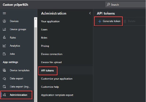

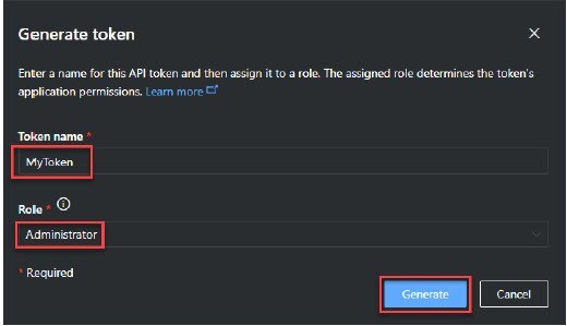

    • Next you’ll be asked for an Azure IoT Central application API Token
      • Go back to your IoT Central Application
      • Select Administration --> API tokens --> “+ Generate token”
    • Next we need to find the ID Scope and provide that detail to the utility
      • The ID Scope is for the Device Provisioning Service that’s deployed for your IoT Central application
      • Back in your IoT Central Application select Administration --> Device Connection
      • Copy the ID scope using the copy button
      • Paste the ID scope into the command prompt window
    • The utility will generate entries for your Azure Sphere applications app_manifest.json file. See the graphic below for the items we need to copy into our app_manifest.json file.
The graphic below shows my ShowIoTCentralConfig.exe execution
  • After supplying the requested information, the utility responds with the details I need for my app_manifest.json file
Now let’s go back to Visual Studio.  If it’s not open, go ahead and launch the Visual Studio application and open the \Samples\AvnetAzureSphereHacksterTTC\HighLevelExampleApp project.  Visual Studio keeps a list of recent projects, your project should be found in that list.
Open the app_manifest.json file for this application. There are four items we need to include in order for our application to use DPS and connect to our IoT Central Application:
  • DPS Scope ID: See the output from the the "ShowIoTCentralConfig.exe" execution
  • AllowedConnections (11):
    • The DPS global device endpoint FQDN: See the output from the the "ShowIoTCentralConfig.exe" execution
    • The IoT Hub’s FQDNs: See the output from the the "ShowIoTCentralConfig.exe" execution
  • DeviceAuthentication:
    • This is the GUID for your Azure Sphere Tenant. This is included so that this application will only work on devices claimed to our Azure Sphere Tenant. So if someone was able to get our application and side load it onto an Azure Sphere device, that device would not be able to connect to our Azure services, unless that device is in the same Azure Sphere Tenant.
    • From your "Azure Sphere Command Prompt Preview" CLI execute the command >azsphere tenant show-selected
My updated app_manifest.json file.
  • Open the CMakeLists.txt file in the project
  • Determine which Starter Kit revision you have Rev1 or Rev2.  This can be determined by looking at the silk screen text under the Avnet Azure Sphere certified module
  • Find the azsphere_target_hardware_definitions lines.  Make sure you uncomment the line that describes which kit you have
    • In the example below I 'm using a Rev1 kit
  • If you get this wrong, the wifiLED device twin control will not work correctly since the GPIO driving the LED is different between the two kits

  • Open the build_options.h file
  • On about line #6 remove the “//” comment characters to enable the #define IOT_HUB_APPLICATION configuration.
  • On about line 17,  remove the "//" comment character to enable the #define USE_PNP configuration.
  • Save your work by typing (Ctrl+S).

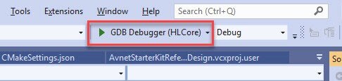

To compile, link and load the application onto your Starter Kit, you just need to click on the “Remote GDB Debugger” button in the toolbar.  You’ll see the build process run and a popup box stating that Visual Studio is starting the application.
  • Make sure your device is connected to your PC
  • Ensure your device has a Wi-Fi connection
    • azsphere device wifi show-status
  • To compile, link and load the application onto your Starter Kit, you just need to click on the “Remote GDB Debugger” button in the toolbar.
    • If you're asked to save the changes click "OK."
If you look at the output window, you should see something similar to the text below.
Let's review this output . . .
AZURE_SPHERE_PROV_RESULT_OK
This output confirms that the DPS successfully provisioned our device into the IoT Central application (IoT Hub in the background)
Updating device twin
This output is showing that the application is sending device twin updates.  You can see in the output that these updates are sent as JSON {key: value} pairs.
IOTHUB_CLIENT_CONNECTION_OK
This output shows that our device has connected to our IoT Central Application (IoT Hub).  If you don't see your device connect to the IoT Hub, please review the Troubleshooting Azure IoT Hub Connection Issues blog entry.
Sending telemetry
This output shows the telemetry data we’re sending to Azure.  As with the device twin update message, we’re sending JSON key: value pairs. To send telemetry, you just need a valid JSON structure.  The IoT Hub will collect this data and simply pass it on to any services that subscribe to the IoT Hub.

  • Navigate to your IoT Central web site
  • Click on "Devices"
  • Click on "All Devices"
  • Select your device; your device is the one with the long ugly device name/ID.
    • Click on the selection box
    • Click on the Migrate link
      • If you don't see the Migrate link, click on the ellipses
    • Select your device group
Now you can open your device, see the data your board is sending and exercise the LEDs using your new LED Remote Control view.
