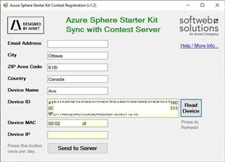

The process of connecting for the daily sync was quite involved due to the highly secure nature of the connection. The first thing needed was a secure email account, so this had to be set up with Microsoft. This is not a regular Microsoft account, which I already had. Then there are many steps to get the device properly set up to connect to the cloud, involving a lot of command line interaction with the device.
After the module and accounts are set up, a downloadable app makes daily syncing very straight forward - just a few clicks of a mouse.
Just run the app and click on the "Read Device" button, wait for it to obtain device ID from the module via USB, then click on the "Send to Server" button.

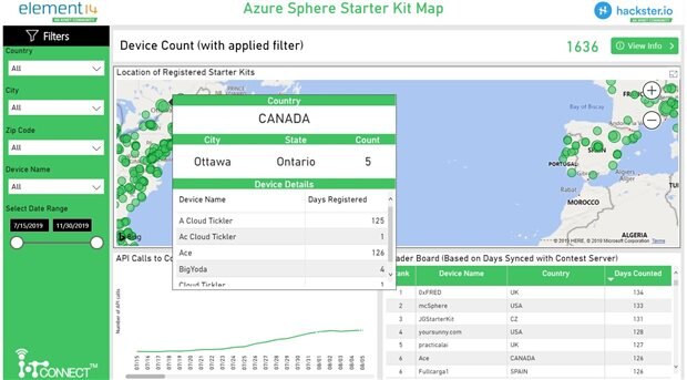

The connection activity is summarized on the online Heat Map.
This shows that the total number of devices checking to date in is 1636 and the maximum on any given day is 654.
My 2 devices are named "Ace" and "A Cloud Tickler", so you can see they have connected daily for 6 months so far. That part of this challenge was harder than it sounds as I had to travel several times and just consistently checking in requires persistence and perseverance. The difficulty is obvious from the heat map that indicates there has never even been one day where more than half of the devices checked in. However my devices have succeeded at this aspect of the challenge.

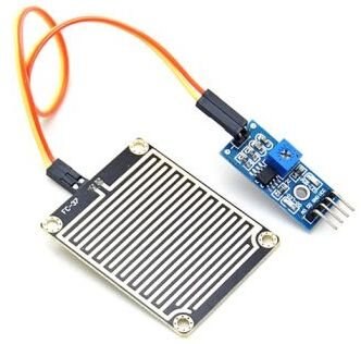

I also ordered and received an I2C to digital I/O module for use in my other Azure Sphere Kit project - detecting open windows and rain ingress:
Rain Sensor

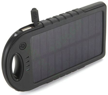

I have a solar charged battery with USB output which should power the system.

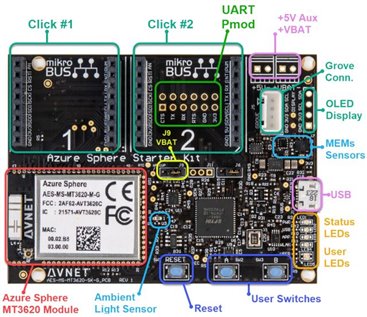

Azure Sphere Module
After getting some parts on order and I finally worked up the nerve to start messing with loading software on the Azure module.

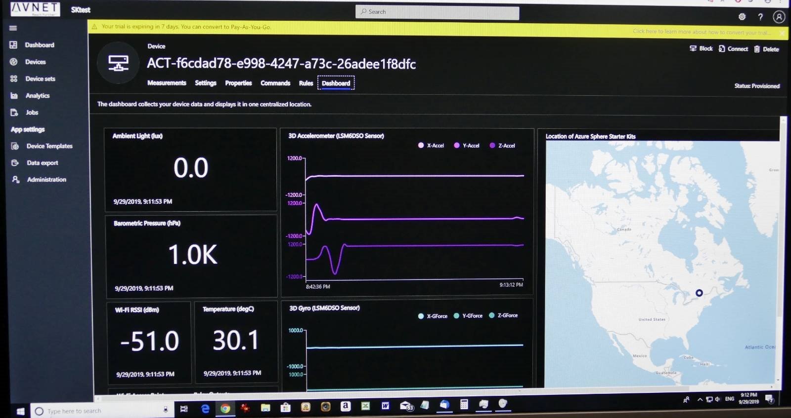

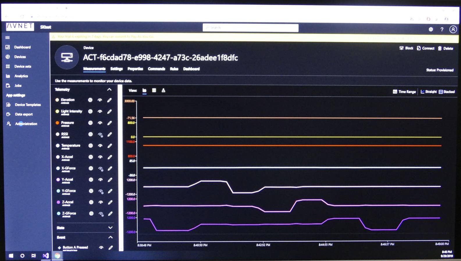

The first tests were with the Azure Sphere Starter Kit out-of-box demo application software that read all the built-in sensors and displayed their outputs.
Here are some screen captures of the demo app in operation, showing the different acceleration axes as I rotated the device with respect to gravity:
