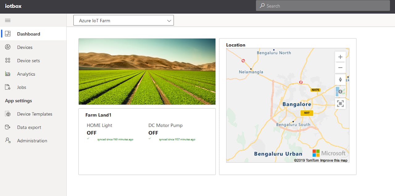

Cloud side I was running IoT Central application :
I was not sure but mostly last two months my board is connected to azure cloud, in between the account free services expired, I came to know after 15days only then again activated the service and running now.
With the help of Dashboard Settings switches I could control the load from cloud. It was very fast. Also I tried to create another client application with node js to read the switch status and monitor the sensors values
