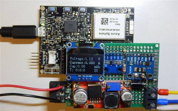

1. Introduction
The project was born from the need to have a universal charger that is able to charge both 1 cell and a battery pack for child car or scooter .
The main concept to make Li-ion charger was using the block for fast prototyping.
I chose as hardware for this role 5 modules:
1. MT3620
2. LM2596
3. INA226
4. MCP4725
5. OLED Display

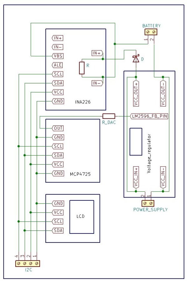

2. Description of concept
On the diagram bellow are present the connection between all additional boards.
The main processor, in this role MT3620, is responsible for collecting information about actual voltage and current provided to charged battery and correct them if they are out of scope.
The main module responsible for controlling the voltage is based on LM2596 and is controlled via 12-bit DAC - MCP4725. To collecting all necessary information I use wide range input ADC - INA226.
Additionally few information about charging process like:
- charging voltage
- charging current
- capacity
- passed time form the begin of charging
- actual charging mode
are presented on OLED  display.
All this three modules are connected to ISU2 and controlled via I2C bus.

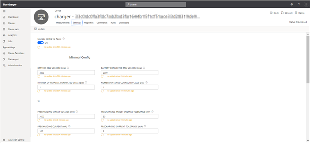

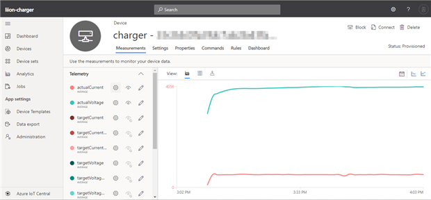

Furthermore Azure module is also responsible for communicating with Azure IoT Central where all information of charging process are presented.
In Azure IoT Central is also possible to change parameters for charging process.

In “Standalone mode” all parameters for charging process are predefined in file liion_charger_algorithm.h
In “Configured via Azure” mode the parameters are taken from Azure. In this case program is waiting for connecting to Azure and after receiving all parameters, sets them by calling function SetDefaultChargingParameters(&azureChargingParameters).
In “Test mode” user has possibility to check all peripheries. Program read state of button A and B and increase / decrease value of DAC register. The result of this is changing voltage on output. By holding the button for time longer than one second, DAC value is changing in step +/- 20. When button is pressed and released in time shorter than one second, DAC value is changing in step of +/- 1.
Information about Voltage on output and actual current are show in display.

Appendix A.
To calculate the R_DAC please visit: https://www.fischl.de/dcdccontrol/

Graph of charging battery from Azure
Setting form on Azure portal
