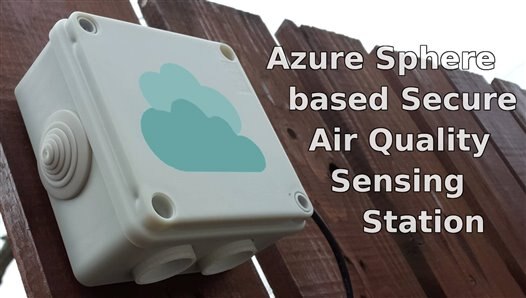

In this post I will show the build of a Secure IoT Air Quality Sensing Station, a device based on the Avnet Azure Sphere MT3620 Starter Kit.
The proof of concept device has the following features:
  • air quality monitoring using the PMS7003 sensor - measures the concentration of the < 1.0, 2.5, 10.0 um particles in the air
  • atmospheric pressures and temperature monitoring
  • OLED display
  • Azure IoT Central application
  • A7 high level + M4 real time applications, with inter-core communication

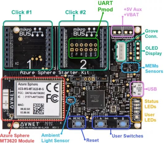

3.1 Avnet MT3620 Starter Kit
The Avnet MT3620 Starter Kit is a development kit based Azure Sphere module AES-MS-MT3620-M-G.
It has the following features:
  • on-board sensors: Accelerometer + Gyroscope, Ambient Light, Pressure
  • support for 2 Click modules
  • support for Grove sensors
  • support for a 4 pin OLED display
  • on-board debugger

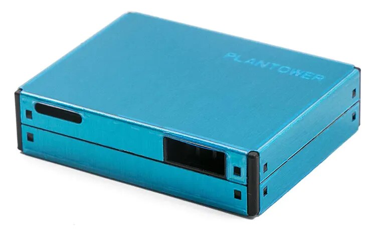

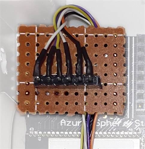

3.1 Plantower PMS7003 - Laser Dust Sensor
The Plantower PMS7003 is an air quality sensor, which measures the concentration of particles of different sizes in the air. The sensor measures particles with a diameter between 0.3um and 10um.
The PMS7003 uses UART communication with a custom data packet format.
To connect the PMS7003 to the Sphere Started Kit I fabricated a DIY adapter that exposes the 3.3V, GND, RX, TX pins of the Click connector.

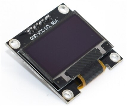

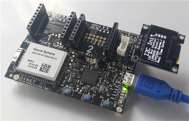

3.2 OLED Module
A 4 pin OLED module can be used to display useful information:

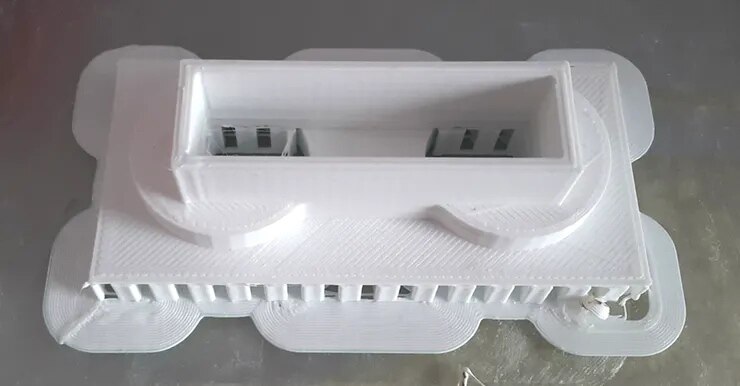

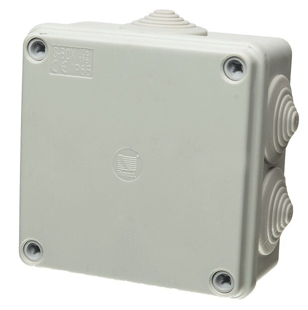

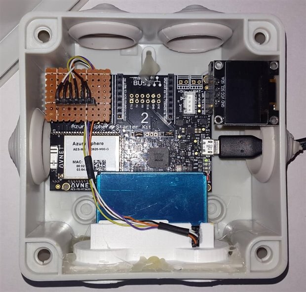

3.3 Enclosure
As the air quality sensor will be placed outdoors, it is recommended to use a protective case / enclosure. I used a IP65 junction box:
with a 3D printed adapter for the PMS7003:

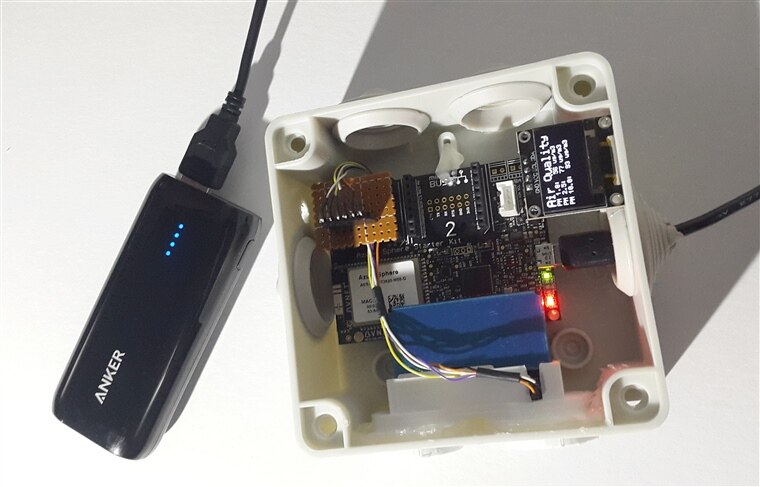

3.4 Assembly
The assembly was pretty easy. I just needed a little bit of hot glue to fix everything in place:

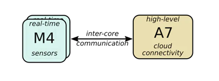

The software running of the Azure Kit has two parts:
  • a high level application running on the A7 application processor
  • a real time capable application running on one of the A4
The two cores are communicating through inter-core communication.

4.2 M4 Real Time Application
One of the M4 Real Time capable core of the MT3260 is used the offload the handling of the PMS7003 sensor, for the main application processor.
The sensor data is transmitted using inter-core communication, supported by the MT3260 MCU.

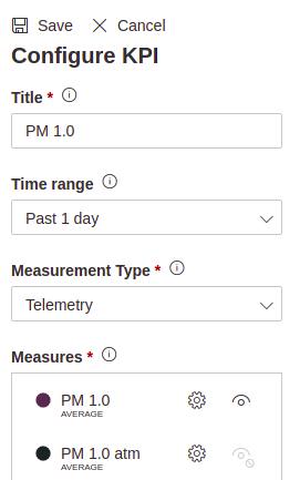

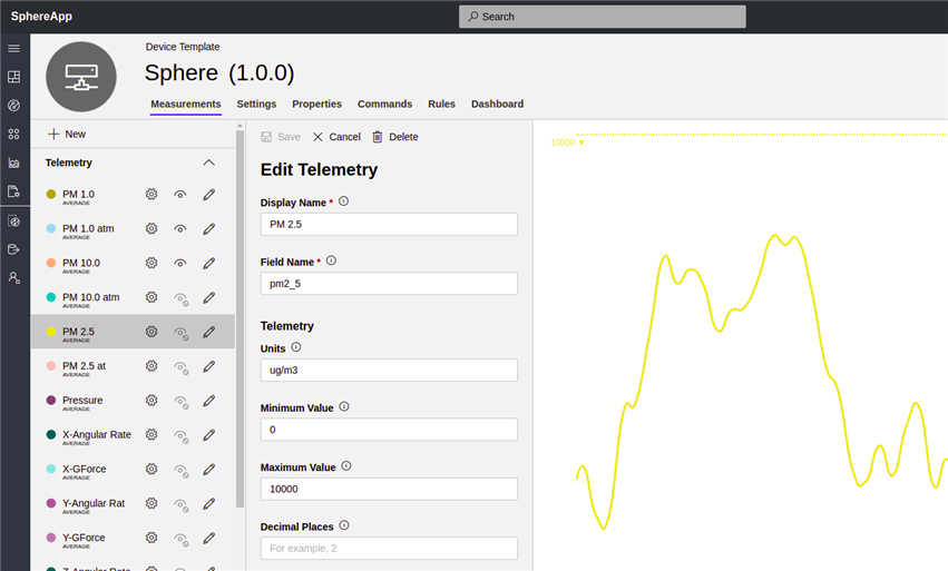

5.1 Device Template
The first thing to do is define the measurements for the fields we send form the device.
In my case these were the following:
  • PM 1.0, 2.5 and 10.0 values
  • PM 1.0, 2.5 and 10.0 values see level atmospheric pressure
  • atmospheric pressure data
.image

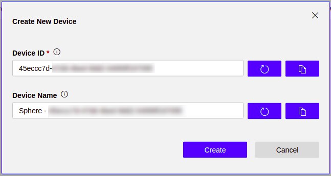

5.1.1 Adding a device
Next we can add our device:
and create a connection for it:

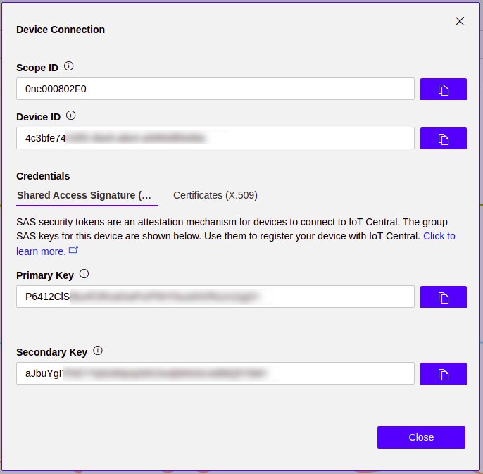

Having this we can generate a connection string using the dps-keygen utility:
$ dps-keygen -si:<scopeID> -di:<deviceID> -dk:<privateKey>
Azure IoT DPS Symetric Key Generator v0.3.3
Connection String:
HostName=iotc-2e2dxxxx-xxxx-xxxx-xxxxxxxxxxxxxxx.azure-devices.net;DeviceId=xxxxxxx-xxxx-xxxx-xxxx-xxxxxxxxxxxx;SharedAccessKey=xxxxxxxxxxxxxxxxxxxxxxxxxxxxxxxxxxxxxxxxxxx=
The resulting connection string need to be placed in the connection_strings.h file.

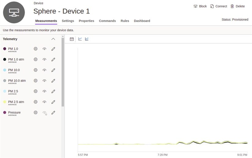

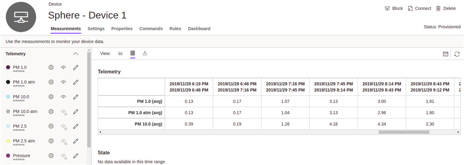

5.2 Measurements
After this the device should be able to send data to the Azure cloud.
And we should be able to visualize it.
(the diagram shows a 3 hour period, in a Friday afternoon)
In case we like more exact values, we can take a look at the telemetry tab:
(pretty much no smog today in Cluj image)

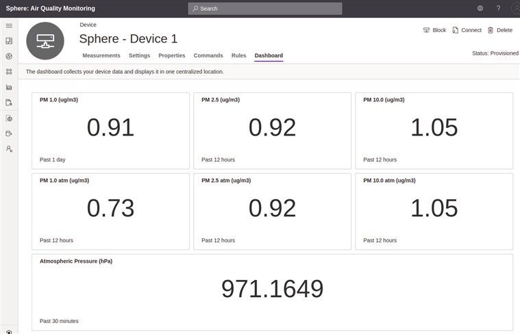

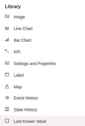

5.3 Dashboard
We can also configure dashboards:
like the one bellow:

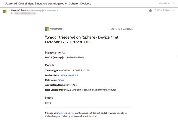

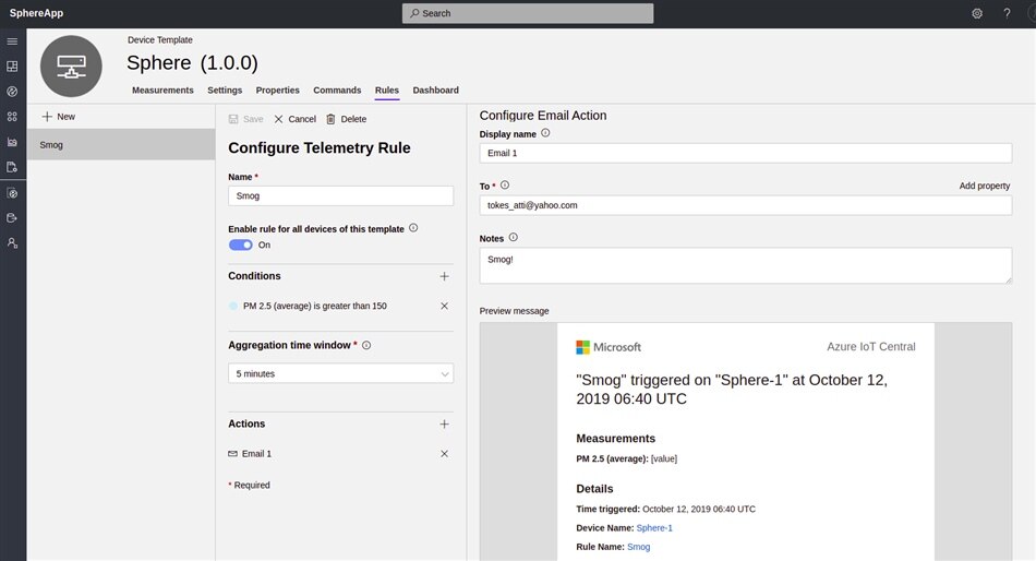

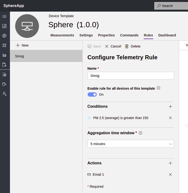

5.4 Rules and Notifications
Azure IoT central also allows to define different rules with action assigned to them.
For example, I configured a rule the sends an email if the PM 2.5 gets over 150 ug/m3:
If the rule is triggered, I get an email like this:
