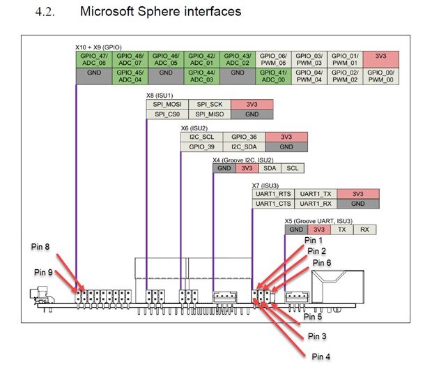

BLE PMOD Wiring

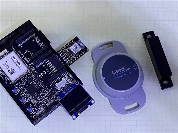

Wiring for the Avnet Azure Sphere Starter Kit
  • Solder a 2x6 right angle header onto the Starter Kit
    • Find the unpopulated header location between the Click Socket #2 headers
    • Face the connector to the edge of the Starter Kit
  • With the Starter Kit powered down, Insert the BLE PMOD into the new 2x6 connector
Wiring for the qiio PoC in a Box

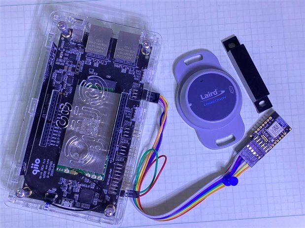

The graphic below shows where to connect signals between the qiio device and the BLE PMOD.  The Pin #s on the graphic refer to the BLE PMOD Pin numbers for each signal.
Signalqiio device (Header Pin)BLE PMOD
GPIO 47X10+X9 Pin 1Pin 9
GPIO 48X10+X9 Pin 2Pin 8
RTS/CTSX7 Pin 1 (ISU3 RTS)Pin 1 (CTS)
TX/RXX7 Pin 2 (ISU3 TX)Pin 2 (RX)
3V3X7 Pin 3Pin 6
RTS/CTSX7 Pin 4 (ISU3 CTS)Pin 4 (RTS)
TX/RXX7 Pin5 (ISU3 RX)Pin 3 (TX)
GNDX7 Pin 7Pin 5

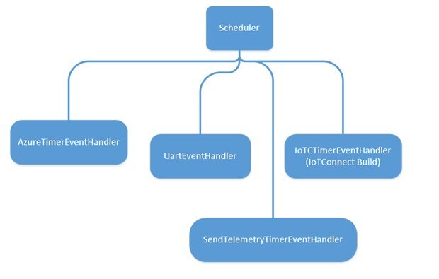

The Azure Sphere Application follows a common Azure Sphere design using events to drive the application.  This is the preferred pattern as demonstrated in the Microsoft AzureIoT example application.  I use the AzureIoT example application as a starting point for all my connected Azure Sphere applications.
I can break the architecture into three main parts: the main loop, events, and Azure handlers.

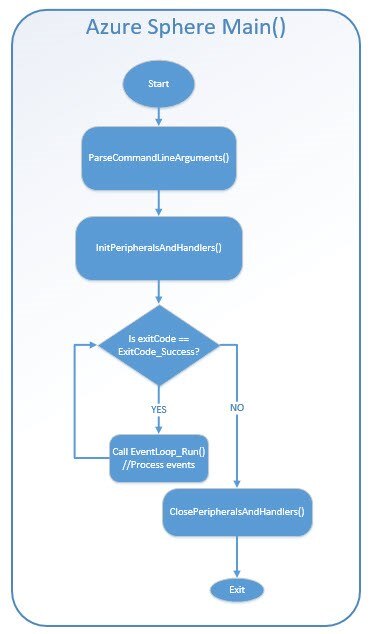

Azure Sphere Main Loop
The main() function is a simple loop that initializes the hardware and handlers, then monitors a global variable: exitCode.  The rest of the Azure Sphere application will update the exitCode variable if/when any issues are encountered.  At that time code execution leaves the main loop to perform some cleanup activities and exits.  Inside the main loop the EventLoop_Run() method is called that will pass control to any handler that the scheduler has deemed ready to run.
When an application error is encountered, the exitCode variable is updated with the reason enumeration and the application exits.  When the application exits, it will return the exitCode value to the OS so that the developer can determine which exit case the application encountered.  See the ExitCode enumerations in exit_codes.h to map the exit code value to the exit enumeration/reason.
Event Handlers
The events handlers are shown and described below.  Event handlers can be triggered by timers (repeating or one-shot) or I/O events from hardware interfaces.
  • AzureTimerEventHandler
    • Manages the connection to Azure
    • Runs at different intervals depending on the IoT Hub connected state
  • UartEventHandler
    • Responsible for reading data from the BLE PMOD UART
    • Collects UART data until a complete message is received, then calls method parseAndSendToAzure() to process the message
    • Runs when the UART receives data
  • SendTelemetryTimerEventHandler
    • Sends the latest sensor readings (from variables) to Azure as JSON telemetry
    • Runs every 360 seconds (default), can be dynamically configured using the device twin key "telemetryPollTime"
  • IoTCTimerEventHandler (Only for the IoT Connect build option)
    • Manages the initial communications to the IoT Connect platform
    • Runs every 15 seconds

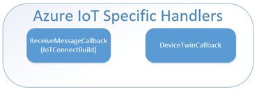

Azure Callbacks
The Azure Sphere SDK implements all the Azure IoT pieces we need to interact with the Azure IoT Hub.  This application uses a couple of the Azure IoT callbacks to facilitate Cloud to Device (C2D) communications.
  • DeviceTwinCallback
    • This method gets called when the Azure IoT Hub sends updated device twin desired properties
  • ReceiveMethodCallback (Only for the IoT Connect build option)
    • This method gets called when a direct method is called on the remote device from the IoT Hub
    • This method expects a response message from Avnet's IoT Connect that includes specific data fields that the IoTConnect interface expects when the device sends telemetry data

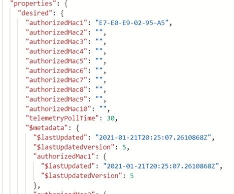

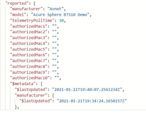

Device Twins

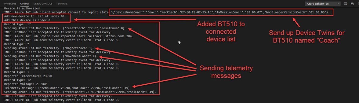

The application implements the following device twins.  Where the key contains <BT510DeviceName> the application will insert the BT510 name into the key name.
Device Twin KeyRead Only or Read/WriteDescription
manufacturerRead OnlyThe manufacturer of the device
modelRead OnlyThe model number/name of the device
authorizedMac1Read/WriteThe MAC address of a BT510 device authorized to associate with this device
authorizedMac<2-10>Read/WriteThe MAC address of a BT510 device authorized to associate with this device.  One key for each authorized device.
mac<BT510DeviceName>
one instance for each BT510
Read Only
The reported MAC address of the device, note that this MAC must also be one of the authorizedMac<n> entries.  One key for each authorized device.
fwVersion<BT510DeviceName>
Read OnlyThe reported BT510 firmware version for this device.  One key for each authorized device.
bootloaderVersion<BT510DeviceName>
Read OnlyThe reported BT510 bootloader version for this device.  One key for each authorized device.
telemetryPollTimeRead/WriteThe time in seconds between the device sending telemetry data to the Azure IoT Hub.  Note that if any of the BT510 "Alarm" events are received by the device, then the telemetry is sent up immediately.  See the BT510 documentation for Alarm events.
Telemetry Data
The application will send the following telemetry data.  Where the key contains <BT510DeviceName> whatever name the BT510 defines/reports will be used in the key name.  After each telemetry item is sent, the local variable is set to NaN.  The NaN value will be overwritten if/when the application receives an update.  Only non-NaN values are sent up as telemetry data.
Telemetry KeyUnitsDescription
temp<BT510DeviceName>Degrees CThe temperature reported by this BT510.  One key for each authorized device.
rsii<BT510DeviceName>The last reported rsii by this BT510.  One key for each authorized device.
bat<BT510DeviceName>VoltsThe last reported battery level for this BT510.  One key for each authorized device.
movement<BT510DeviceName>Event sent when this BT510 detects movement.
magnet<BT510DeviceName>Event sent when this BT510 detects a magnet state change, 0 if close, 1 if far.  One key for each authorized device.
reset<BT510DeviceName>Event sent when the BT510 experiences a reset event, see the BT510 documentation for enumerations.  One key for each authorized device.

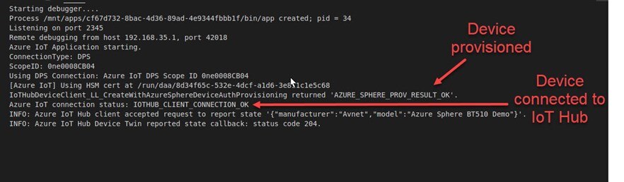

This is a connected application.  There is not a non-connected build option, so you must have an IoT Hub, IoT Central application, or IoT Connect instance to connect your device.  If you need help configuring Azure resources and updating your app_manifest.json file, you can use the following links to get help.
  • Microsoft AzureIoT Example: Link
    • Since this application started life as the Azure IoT Example, all the instructions for configuring Azure resources and updating the app_manifest.json file apply to this application
  • Avnet Starter Kit Out of Box Blog Series: Link
    • This series of blogs will walk the user through all the steps necessary to get started with Azure Sphere development and includes details on configuring Azure resources and IoT Central application

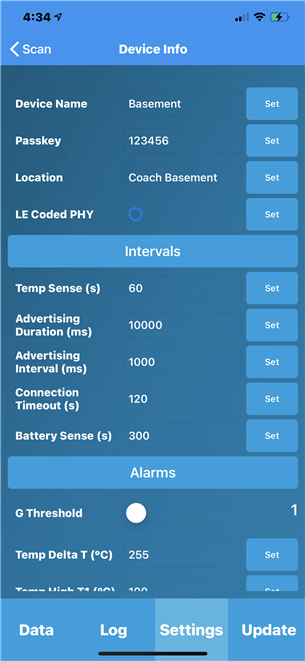

Configure your BT510 device(s)
As mentioned earlier in this blog, the application uses the Laird Connectivity BT510 device name to uniquely identify data from each device to the Azure Cloud resources.  This requires that the user configure each BT510 with a unique name.  If you have more than one Azure Sphere Device, you can configure multiple BT510s with the same name, but for any one Azure Sphere device, any authorized BT510 must have a unique name different from the other BT510s authorized for that Azure Sphere Device.
To configure your BT510 you need to download the mobile application, and update the device name.
  • Search your mobile device app store for "Sentrius BT510"
  • Install the application and follow the instructions for connecting your BT510 device to the mobile app
  • On the "Settings" tab change the Device Name field for your application.  In the graphic below, I named this BT510 "Basement"

It's time to build and load the application onto your Azure Sphere Starter Kit (or the qiio device).  Build, load, and run the application.  Assuming your device has an Internet connection and your Azure resources are configured correctly, the application will connect to Azure.
You should see debug similar to the screenshot below . . .
If your device does not connect to your IoT Hub/IoT Central
  • Verify that your device has an internet connection
  • Verify that your app_manifest.json file is correctly updated
  • Verify that your Azure resources are correctly and completely configured (did you add the enrollment group to your DPS resource?)
Add device twins for our application to your Cloud implementation
Next, update the device twin desired properties to match the device twins our application implements
  • Open an interface to your Azure Sphere devices Device Twin
  • I'll use the Azure Portal
  • Navigate to your device and open the device twin tab
  • In the desired section add the following lines . . .

  • Click on the Save link
  • Click on the Refresh link
  • Scroll down to the "reported" properties section. You should see your desired properties show up as reported properties.
    • If not, verify your device is connected to your IoT Hub
Power up a BT510
When your BT510 powers up, it will start to broadcast messages.  Your application should see these messages and output debug similar to the debug below.
Device E7-E0-E9-02-95-A5 has not been Authorized, discarding message data
To authorize the device add its MAC address as a authorizedMac<n> in the IoTHub device twin
  • If you don't see this debug
    • Verify you correctly configured your CMakeLists.txt file for your Avnet Starter Kit Rev1 or Rev2
      • These kits use different ISUs on the PMOD interface
    • Verify that you updated the BLE PMOD firmware and loaded the SmartBasic application
Authorize one or more BT510 devices
  • Next find the MAC address on the back of your BT510 device or copy it from your debug
    • Mine is "E7-E0-E9-02-95-A5"
    • Enter the MAC as the value part of the "authorizedMac1" key: value pair
      • Make sure your MAC uses UPPER CASE text and contains the '-'s
    • Click the Save link
    • Click the Refresh link
    • You should see the "authorizedMac1" reported property updated with your MAC
Your application will receive the device twin update and the next time a BT510 message is received the application will . . .
  • Validate that the device is authorized
  • Read the device static information and send it to Azure as device twins
  • Add the device to a dynamic connected list for processing
  • Every 30 seconds, if new BT510 data was received, a telemetry message will be constructed and sent to your Azure IoT Hub
As BT510 messages are received the application will parse out data and send it up as telemetry dynamically creating telemetry keys that use your devices name.  See the sample output below for my device named "Coach". . .

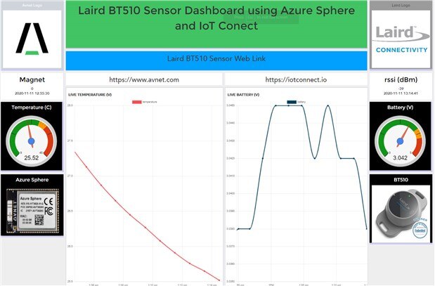

Data Visualization with Avnet's IoT Connect Platform
Below is a simple dashboard that I created with Avnet's IoT Connect Platform.  The data is from a single BT510.  Using the IoT Connect platform I created this dashboard in ~15 minutes.
