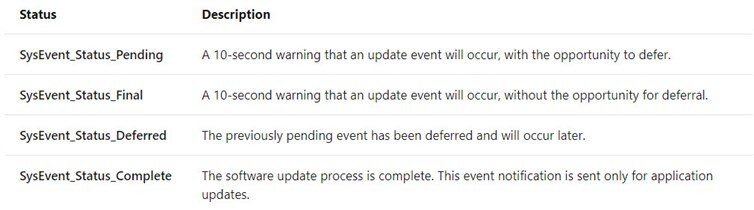

At a high level the Azure Sphere High Level application registers for OTA events and provides a handler that will be called when OTA events trigger.  The events are shown below, note that there is a 10 second window where the application has the opportunity to defer the update.
Note that there is a limit to how long the application is allowed to defer the updates.  For OS updates the limit is 24 hours, and for application updates the limit is 167 hours (~7 days) .  These time periods start when the application gets the first notification that an update is pending.  If the application asks for a deferment period greater than the remaining allowed period, the requested period is adjusted to reflect the max time remaining.

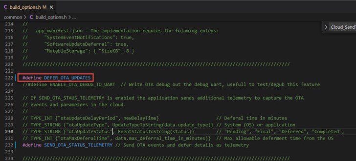

If you leverage the Avnet examples, you just need to enable the feature by enabling the compile flag in common/build_options.h

  6. Search the example project for the compile flag DEFER_OTA_UPDATES to see all the required code
