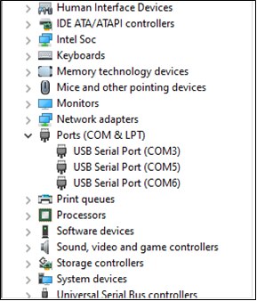

The Device Driver:
FTDI: FTDI driver for Windows should be installed
           TAP: Tap driver for Windows 10 installed

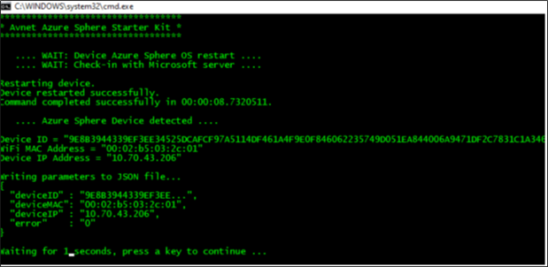

Reading azsphere kit information:
Configure AzureSphere Kit IP Address:

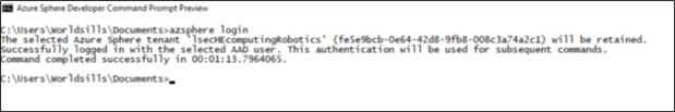

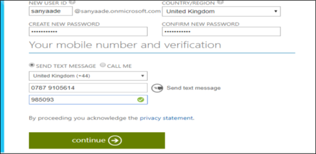

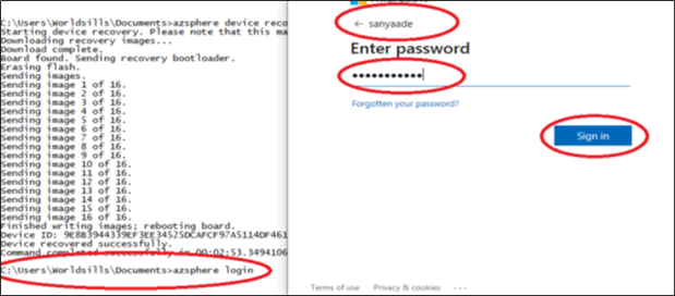

Sign up for Azure Sphere Account:
log-in to your account

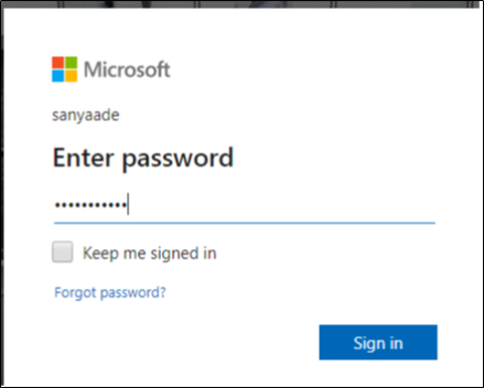

Note: Due to the nature of my involvements, I have many accounts that were associated with Azure Cloud. Your mileage may vary.
If everything is successful then you should see the screenshot message below:
You should be login into your azsphere azure account.image
As you can see from the screenshot above:
  1. 1.) My Azure Sphere tenant name is :  'lsecHEcomputingRobotics'  which I created when setting for the AVNET Azure Sphere MT360 kit competition. You will need to create one for your azsphere kit.

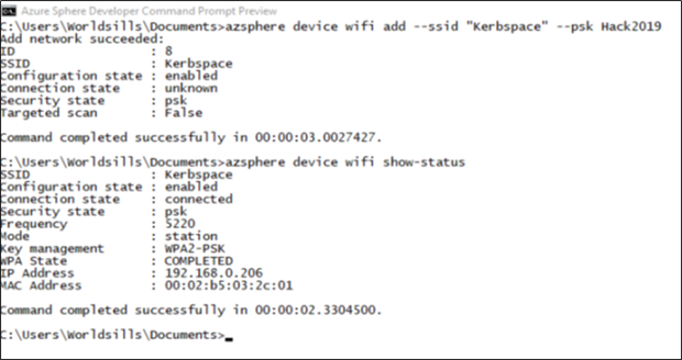

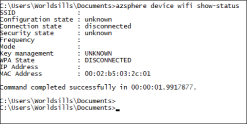

The next and probably the last step is to configure your azsphere for networking. Many people may be confused just like I was with this section. What it basically meant was that you will be setting the device up to communicate over the air with IOT hub. In order to achieve that the azsphere will need an IP value assigned to it. Lets go:
open the azure command prompt preview:
  1. next enter the following routines:
    • azsphere device wifi show-status

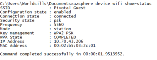

you should see the following
from the above, you see that the IP address is not configured hence the device is not connected either.image

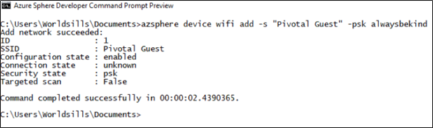

Next run the following command:
azsphere device wifi add --ssid <yourSSID> --psk <yourNetworkKey>
  1. e.g. azsphere device wifi add --ssid PivoGuest  --psk alwaysbekind
ATTENTION: If the SSID or key includes a quotation mark, use a backslash to escape the quotation mark. Backslashes do not require escape if they are part of a value. For example:image
azsphere device wifi add --ssid "New SSID" --psk "key \"value\" with quotes"
As you can see above my -s or –ssid is in quoted marks.
If we now run the command => azsphere device wifi show-status,  we should have the following result and be connected.
See below for another correct way I was able to the azsphere connected to WiFi:
C:\Users\Worldsills\Documents>azsphere device wifi add --ssid "Kerbspace" --psk Hack2019

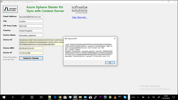

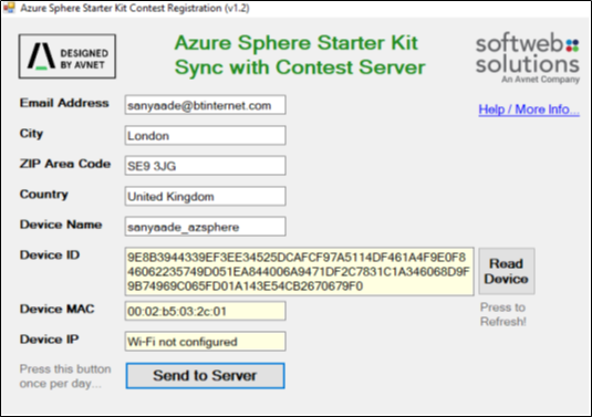

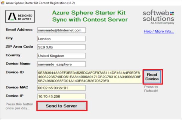

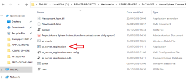

The next step now is to ping the contest server, to do we need to install the avnet program called azsphere-contest-app from this url on google drive:  https://avtinc.sharepoint.com/teams/ET-Downloads/Shared%20Documents/Forms/AllItems.aspx?id=%2Fteams%2FET%2DDownloads%2FShared%20Documents%2Fprojects%2FMicrosoft%20Azure%20Sphere%2FHackster%20Contest%2FAzure%20Sphere%20Contest%20Registration%20App%20%28v1%2E2%29%2Ezip&parent=%2Fteams%2FET%2DDownloads%2FShared%20Documents%2Fprojects%2FMicrosoft%20Azure%20Sphere%2FHackster%20Contest&p=true&originalPath=aHR0cHM6Ly9hdnRpbmMuc2hhcmVwb2ludC5jb20vOnU6L3QvRVQtRG93bmxvYWRzL0VYYzBMczVtSkN0SHRET3g1LVNad0FjQmZSQkY4c2l5ci1IVGRURUE2NDNEbFE_cnRpbWU9SlNaYVk4WlUxMGc
Well just download the whole folder, unzip it in your contest kit folder. Next navigate to the folder and then double click on. See the item arrowed below:
A window will open up for you to enter your details that will be sent to contest server. Fill in your detail. Now click the “Read Device” button at the bottom right hand side of the window. The program will interrogate with the azsphere devicre to obtain its ID, MAC ans IP values
if everything went well like the above green window then you contest-app program should look like the below screenshot
Click the “Send to Server” at the bottom of the program to have these details sent to the contest-app server. The only remain for complete part 1 of the competition is now to run the contest-app daily and continuously to ping the contest server for 15 days. Hum! Happy hacking and see you soon in phase 2 of the competition.

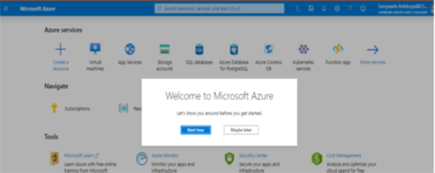

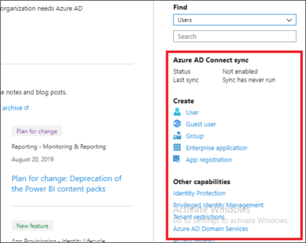

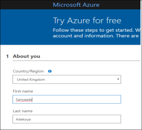

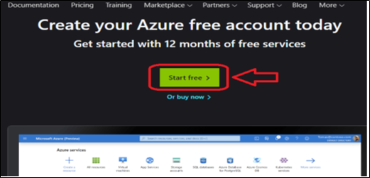

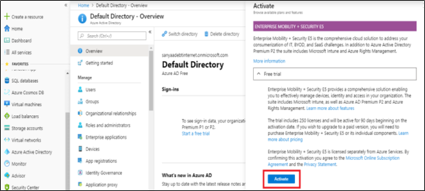

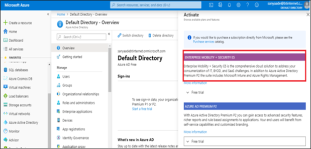

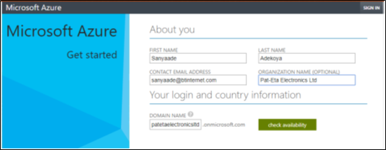

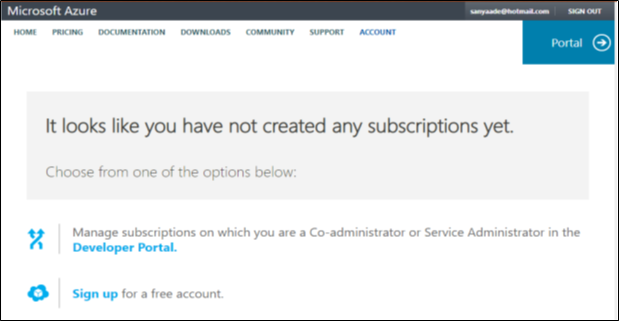

The most challenging part of the phase 1 is azure cloud account setup. Microsoft has loads of information that spread across their internet portals. Most of them vary vastly from different versions of Visual Studio editions. I thought since the azsphere kit itself is used mostly with the C language, portability and cross domain across the visual studio family should be a breeze.
Also Azure account sign up has been a painful experience for most of us that are newbie. It is either is too steep up, too steep down and mix-match. Most people on the Element 14 and Hackster.io reportedly complained about these processes. See you in phase 2:

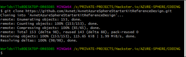

Let us create a folder and named it coding. Next we clone the github into that folder:
git clone https://github.com/Avnet/AvnetAzureSphereStarterKitReferenceDesign
This will create a sub-folder named AvnetAzureSphereStarterKitReferenceDesign and will download the software C code inside it. The folder above contains some samples code written in the C-language that will be using to interrogate with the start kit onboard sensors.

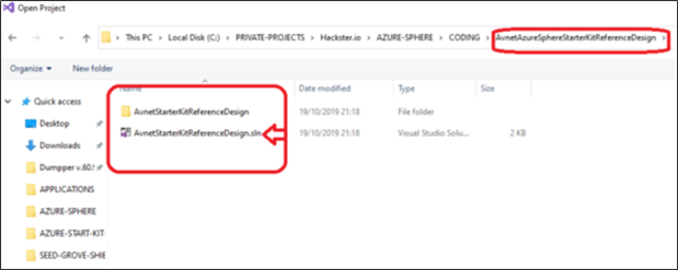

Next launch the Visual Studio IDE, mine was the 2017 edition of the compiler.

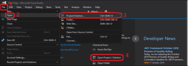

Now open the project solution file
you can either click on file menu then select open and project/solution or use Ctrl + Shif + O
Next navigate to the project folder and open the project solution file inside Visual Studio.

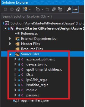

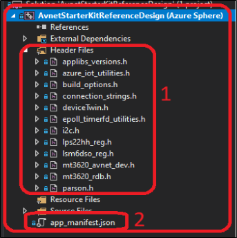

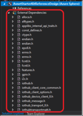

A quick walk down the aisle of the azsphere start kit reference code shows the dependencies libraries that the device made use of. See the screenshot:
I believe that this contains generic library code that can be imported by variant devices that are based around the MT3620 families. How portable are the libraries will what I love to explore and to see if these can be ported to Linux, Mac Osx with little efforts. This is the beauty of the C-language since it available on many OS platforms mostly at embedded level. Various API functions like messaging, data transport, GPIO, i2c, endian bits including onboard sensor devices and the client to iothub server were defined in the header files included in the library.
Here are the header files and the manifest json file:
The reference source files are being shown below here:

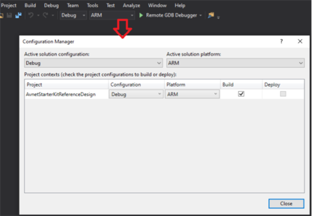

Exploring the reference design configuration show the below setup:
There is opportunity to modify this configuration to derive a new one or an extension of it. More about this later. Also configuration for release or debug including pre-build mode can be configured here.

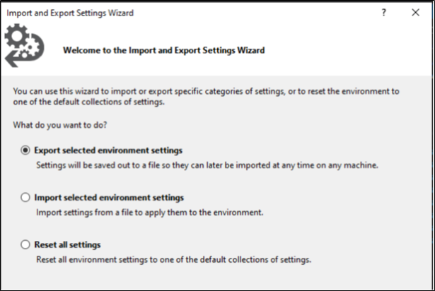

When playing around any referencing code, it is a good practice to backup settings in order to be able to fallback to the original configurations if thing get out of hands most especially newly introduce device like avnet MT3620 into the market. Luckily visual studio provides that for us. See below:
on how to export project environment settings from visual studio

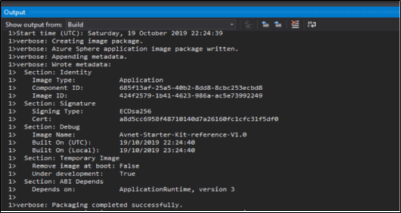

First let us build the out of box of the reference project. Select project and click on build the solution option.
The test build result shows that we are able to compile the project without errors:
This is cool as we know know that any consequence error arriving will be coming from us and not from the reference code.

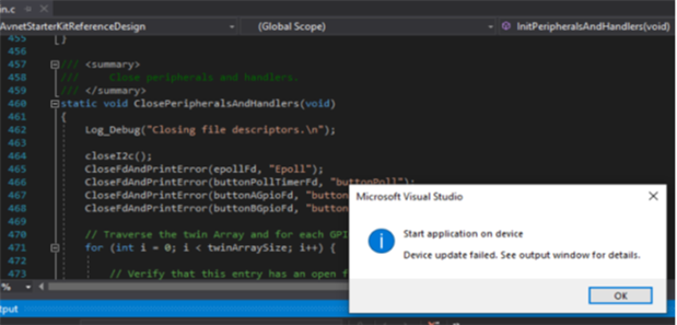

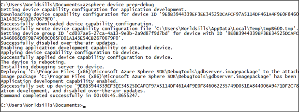

Test driving:

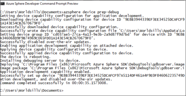

if you run the program you may get an untrusty message and the app will fail to run on your device
the solution to the above message is to put the device in pre-debug mode in order to allow programming it from your PC.
Open the azure command prompt preview and run the following commands:
                                                azsphere device prep-debug
This will disable over the Over-The-Air mode and put the starter kit in local mode and prevent it from the update from the WiFi interface. The debugger tools will then be deployed onto the device. image

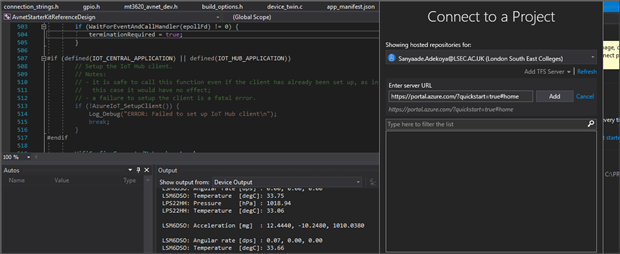

Hey!
Now you can start to program and debug the starter kit from within visual studio.

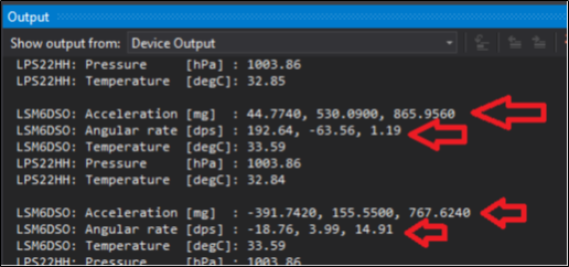

Test 1: LED Blink, Sensor readings:
watch the accompanying video to see these. The screenshot below also shows the values of accelerometer and angular phase changes when the board was manually rotated and moved around:

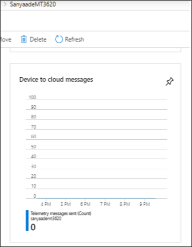

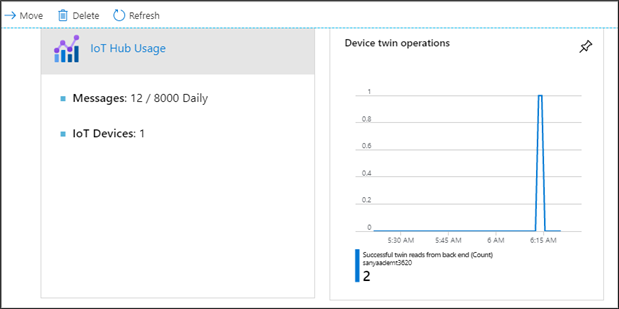

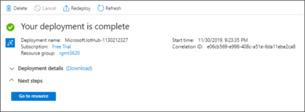

Test 2:  Connecting and Sending Device Data to Cloud

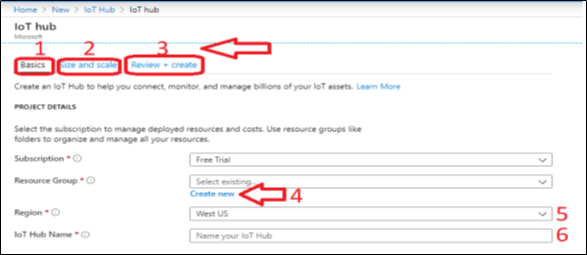

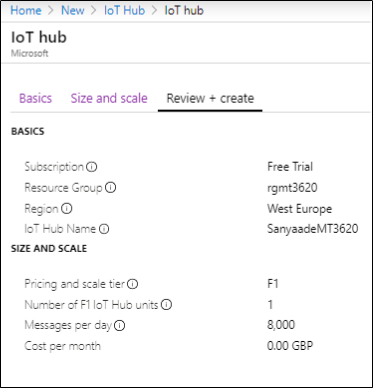

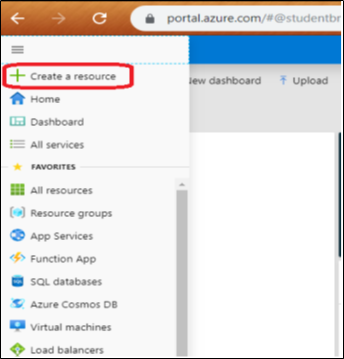

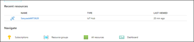

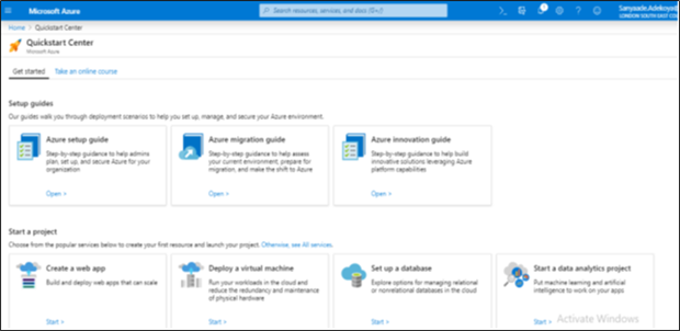

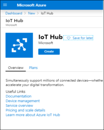

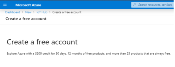

  • Next login into  your Azure online portal in order to do a azsphere device to cloud communication and to send those data  in step 1 above to Azure hub:
  • Create a resource in the top left
  • Then search and select IoT Hub to create it

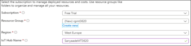

Note: Please beware of the free account and the paid version. Make sure you follow the free account steps throughout.

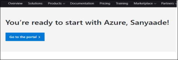

Now complete your IoT Hub registration details
if you complete the registration process to the screen below then you are set up!
Click on the go to the portal button to proceed to the next stage of the device to cloud registration, huh!

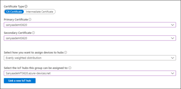

  • Now complete the six step highlight below to create and get your device ready for provisioning
This is mine creation below:

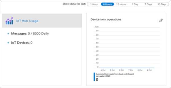

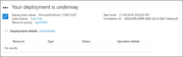

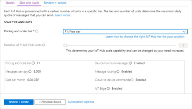

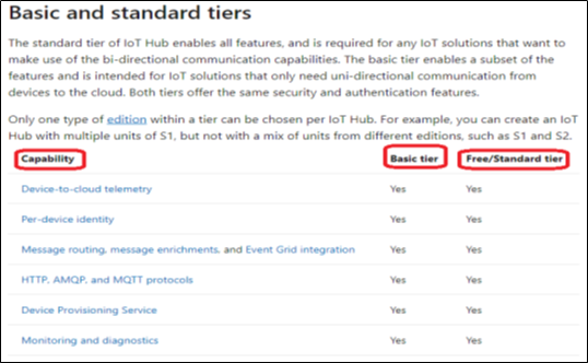

The next is very crucial since you could gobbling cost of data to cloud so a mindful steps are required when choosing the size and scale of how to provision your IoT device. Mind how you do this. Also see below for a quick overview of Basic and Standard tier
I went for the free tier at least for now that I am experimenting Azure IoT hub for the first time:
Next click on Review+create button to go to the last stage and actually create your IoT hub device
Next review your options and then click the create button to it done for your.
You will get a similar results like those shown below here:
As you can see from the above images, our device twin operartion and devcie to cloud data graph are empty with no values as we have not connect the local azsphere to Azure cloud IoT Hub and send data to it device. This is our next task but we need to provisioning our azsphere to link it to IoT Hub, lets go:

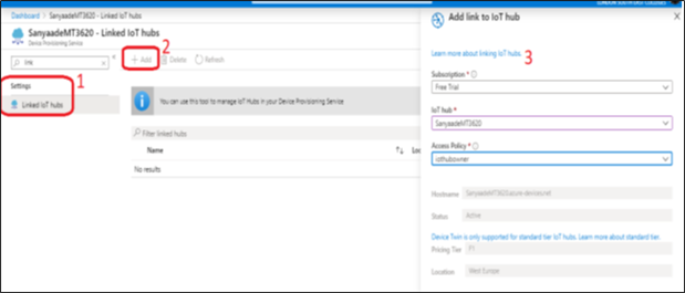

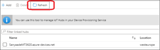

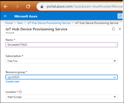

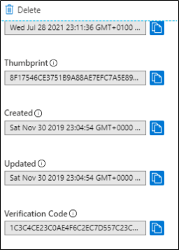

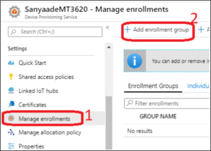

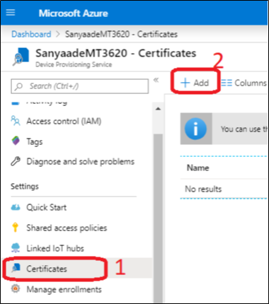

Our next task is provision our device and get it connected to IoT. In order to achieve this we take the following steps:
  • IoT Hub Device Provisioning Service
  1. now go to dashboard and Click on Create a resource
  2. and search for Device provisioning service.
      3. Next fill-in your details and  click Create:
     You should get a similar result like show below here:
In order to link the Azure Sphere device to the service, select settings from your provisioning device, next
click on Linked IoT Hubs. Now click the +Add button see the screenshot below:
Next fill-in the details as shown in section 3 above, then click the save button confirm your action. Now refresh the Linked IoT Hubs page to get the updated settings

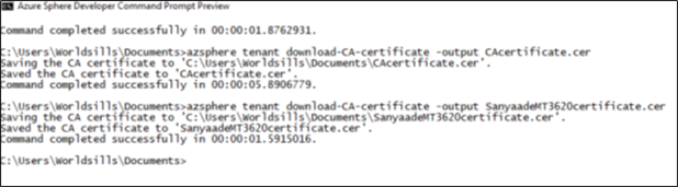

Local to Cloud connection: (AzSphere Device configuration)
  • Next open Azure Sphere Developer Command Prompt
  • Next issue the following command to download ypour device certificate into your computer
=> azsphere tenant download-CA-certificate –output SanyaadeMT3620certificate.cer
Note: (replace SanyaadeMT3620certificate.cer with your own make up name)

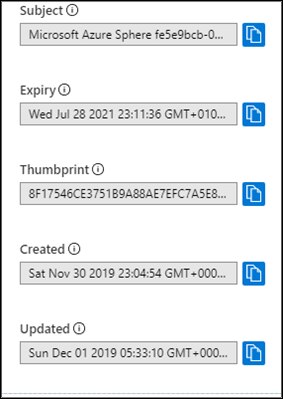

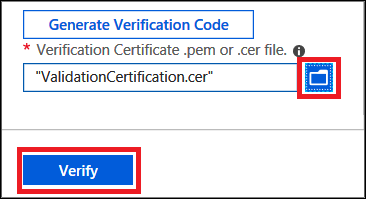

On the left hand pane of the Device Provisioning Service in your Azure Portal, select the Certificates tab
Next click the +Add, now give give it a name and upload SanyaadeMT3620certificate.cer that was created earlier
The Certificate is listed as Unverified, click on it, on the pop-up window, towards the bottom, copy the verification code generated to the clipboard
Next go back to your command prompt as enter the command below:
azsphere tenant download-validation-certificate --output SanyaadeMT3620verification.cer --verificationcode 1C3C4CE23C0AE4F6C2EC7D557C23C297DC565715B1EA3104
once again you need to replace the last bit of code above with your own generated code hope this is clear enough!
We are almost there now but on your IoT hub provisioning device, go to the left hand pane and select Manage Enrolments. Next click Add enrolment group
Give it a name and then choose the certificate and assign an IoT Hub
Click Save button to complete the process. We can now start to send data from our device to cloud but conduct and complete the verification process for the device:
Next go to command prompt and put the azsphere device in debug mode again. This is always need to boot it in programming mode for the SDK samples and push to cloud sessions
  • ð azsphere device prep-debug
Get the mojo working:
After some high and low attempts then things started to show data:
