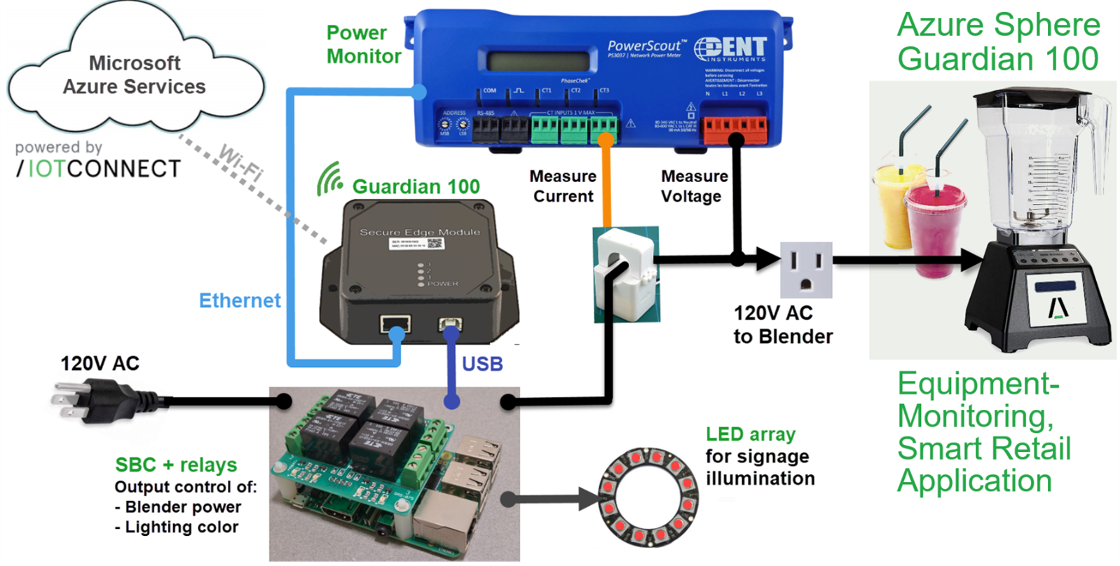

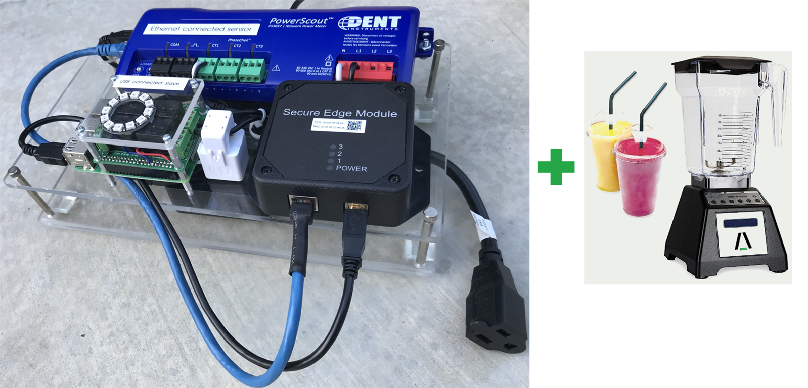

The power drawn by each blender appliance is measured using a multi-channel commercial power monitor and reported via Ethernet to Guardian.

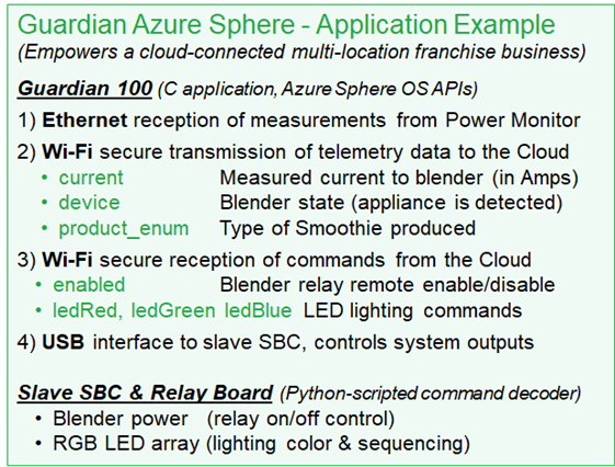

Program logic in Guardian's Azure Sphere application matches current-draw profiles to which blender buttons have been pressed (ie. which smoothie flavors produced).
Dual-band Wi-Fi
Guardian securely sends via Wi-Fi this telemetry data to Azure-based IoTConnect, which charts current and other reported parameters over time within it's comprehensive device monitoring and management interface
A PowerBI based business dashboard is also provided, that provides insights and identifies trends from the captured database of Smoothie drink production data
Different output options can also be controlled remotely by franchise management, by making changes to the Azure Device Digital Twin that models the physical outputs of each connected-blender installation.

Guardian also communicates locally via USB with additional off the shelf hardware (Raspberry Pi fitted with Relay HAT and RGB LED array) to implement various outputs.
This enables (seasonal- or special event-) control of RGB lighting LEDs at each installation, as well as the ability to remotely disconnect blender appliances, in the event of unpaid franchise fees or a need for technical maintenance

The diagram below provides system-level detail of the hardware involved (for simplicity a single blender installation is shown)

Summarized below are some key aspects of the implementation
  • A commercial power monitor reports via Ethernet to Guardian, the measured operating current and voltage of the blender appliance(s)
  • Guardian's Azure Sphere application logic matches the current profile with blender button pressed (ie. smoothie flavor produced)
  • Telemetry is securely sent via Wi-Fi from Guardian to the Cloud
  • IoTConnect cloud-based application charts current over time and identifies smoothie quantities and flavors produced.
    It also hosts a PowerBI business dashboard with analytics to extract visualizations that highlight trends and additional insights of customer purchased smoothie products over date and time.
  • Control of local outputs is implemented via Guardian’s USB interface to a slave SBC board’s relays and LED peripherals
  • Remote management via internet browser of the cloud-hosted Azure Device Digital Twin, to control local outputs:
    - RGB LED lighting array (for seasonal or mood effects)
    - Power-disconnect relay (for remote disable of the blender)
