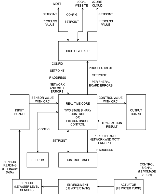

General assumptions and concepts
The controller
The basis of the project is as the name implies – is the regulator itself. In order to not limit the usage of the project I’ve decided to implemented both continuous and discrete controllers. As the continuous controller I’ve chosen PID controller and as discrete – two state controller. The controller shall be selected from configuration website hosted on the device itself. As the control algorithm is a critical task that requires precision timing and time determinism It was decided to implement it within real time capable core of the Azure Sphere along with all GPIO communication such as communication with sensors and actuators, additional EEPROM memory, 7 segment display, buttons and diodes. The high level core will be responsible for communication with virtual world such as Azure Cloud, IoT devices via MQTT broker and through HTTP server that serves easy access to all of the configuration parameters of the device.
Expansion cards
In order to ensure the largest possible number of supported objects, measurements and actuation were decided to be read from/written to specially designed expansion cards. Thanks to these cards it is possible to control virtually any linear object as long as there is right expansion card for it. To ensure safety of the control process, it was decided to design these cards as separate devices with separate microcontrollers. Thanks to this, communication between the controller and cards could be secured from potential errors and noise with checksum and additional confirmation bits. This method can also be used to check whether cards are connected and are working properly. In case of the card’s fault, the controller goes into failure state and tries to write lowest possible control value into output card. This state can be cleared only by performing hard reset.
The operator’s panel
The panel (in front of a device) will enable user to check device's IP address and current setpoint via 7 segment display, check control’s error via led bar and check whether there any errors through three error diodes: expansion card’s failure, MQTT not connected and network’s error.
Setpoint setting
To maximize the usability of the project it was decided to let user change the setpoint from three places: MQTT, configuration website and by using the potentiometer located on the housing.

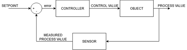

General concept of the device is visible on the diagram below.

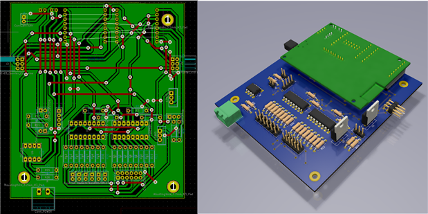

Electronic designs
In order to not play with breadboards, it was decided to make a durable, solid project using toner transfer method. All of the boards were designed in KiCad program.

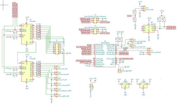

Main board
The schematic above shows the controller’s main board. There are two 5V voltage regulators, one for Azure Sphere itself and one for expansion cards. The board also contains 1kb EEPROM memory for configuration, two SIPO registers to control led bar and status diodes, and connectors for buttons, diodes, 7 segment display and potentiometer.

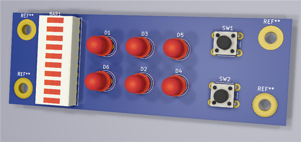

Control panel
The panel has an led bar showing current control error, leds signaling status of the device and buttons responsible for setpoint setting and displaying device’s ip addres to user so configuration website can be accessed.

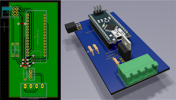

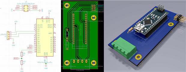

Input peripheral board
As an input, It was decided to use distance measurement from HC-SR04 ultrasonic sensor. In order to measure and secure data Arduino Nano was used. The SPI MISO goes to the motherboard via a voltage divider due to differences in voltage levels between Arduino and Azure Sphere.

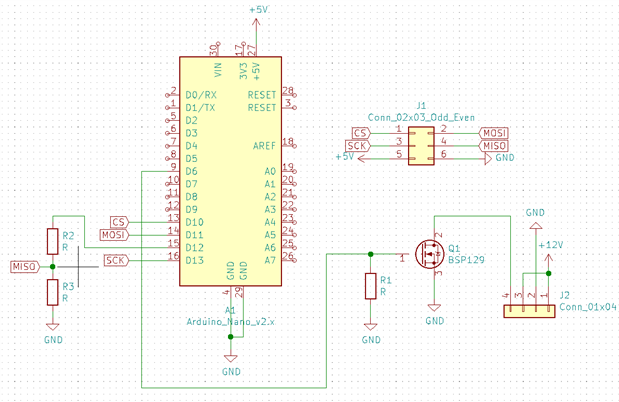

Output peripheral board
Similar to the input expansion card, the output card is equipped with Arduino Nano but this time it controls the NMOS transistor via PWM.

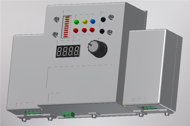

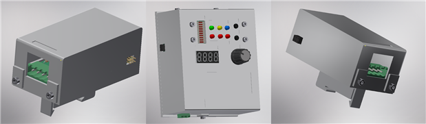

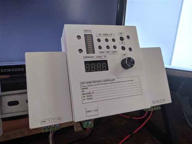

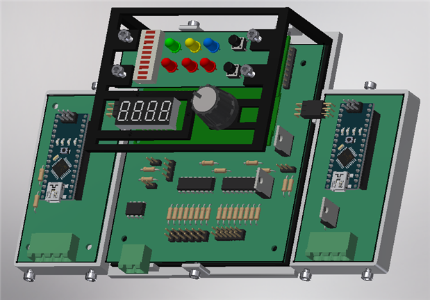

Housing
The housing of the project was made on a 3D printer. The main assumption was the possibility of placing the controller on a DIN rail (TH35) together with modular equipment. The housing was decided, just like the electronics, to be divided into 3 parts: input/output expansion card's housings and main board’s housing.
Electronics boards connected to the back of the housings:
Separate housing designs:
Complete housing with expansion cards connected:

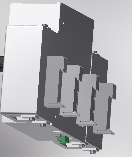

Back of the controller (DIN mounts created by https://www.thingiverse.com/RobertHunt/about (https://www.thingiverse.com/thing:101024)):

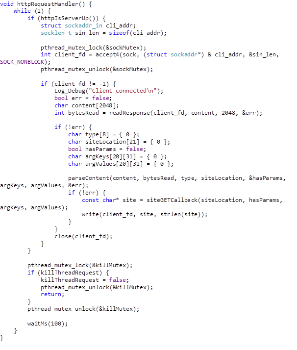

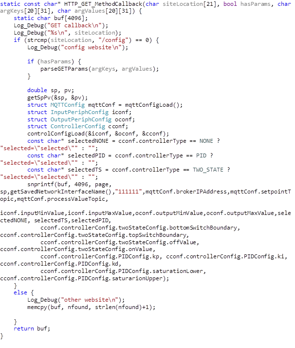

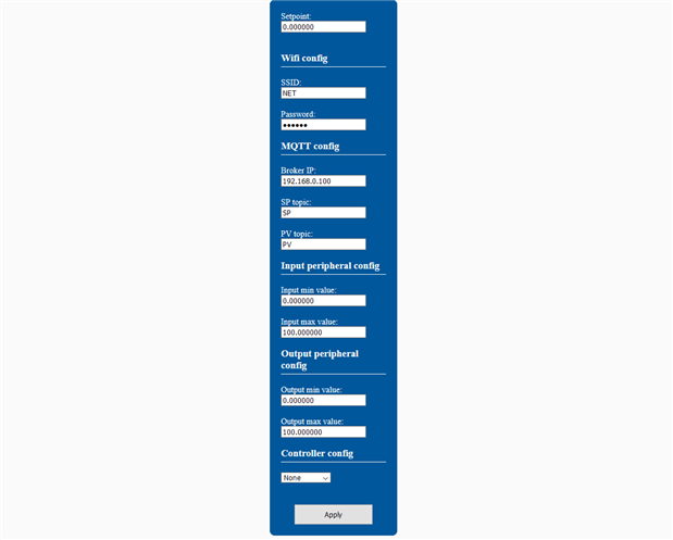

Web based configuration
In order to allow the user to configure the device, it was decided to provide a simple website at local_ip:8181/config. For this purpose a simple socket based HTTP server has been written which awaits in a separate thread for connections with clients:
After connection, callback (siteGETCallback) is calles, in which, depending on the requested page’s location, the configuration website is provided, or a 404 error.
The configuration website is shown below:

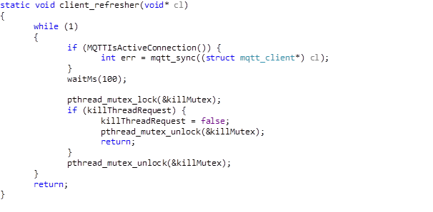

For communication with MQTT, a third party library was used (https://github.com/LiamBindle/MQTT-C) which works without any problems on Azure Sphere. To use this library, a wrapper header has been written to simplify the structure of the main code. As with HTTP server, the main MQTT loop runs on a separate thread:
And also has a callback that is called when a message is received from setpoint’s thread:

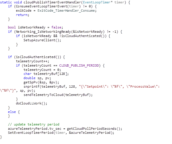

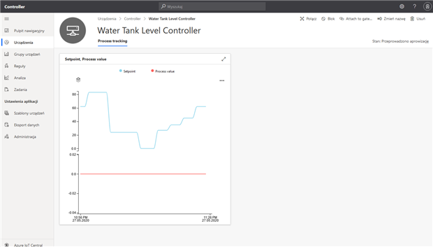

Cloud based control reporting
In the project, the cloud plays the role of supervisory panel in which current state of the control process can be seen. Every minute telemetry about current setpoint and process value is being sent to the cloud and both values are displayed on time plot.
In the picture above, you can see setpoint changes made with knob over time. Input sensor was disconnected at the time so chart of process value is always 0.

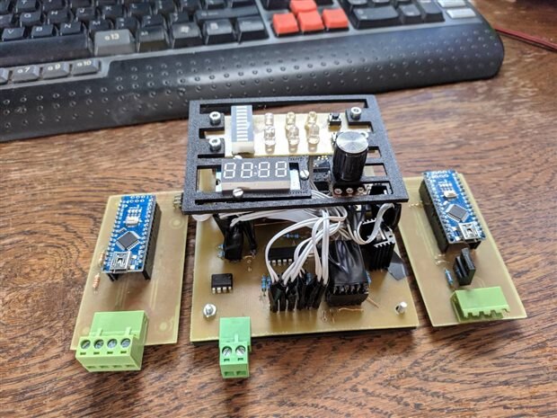

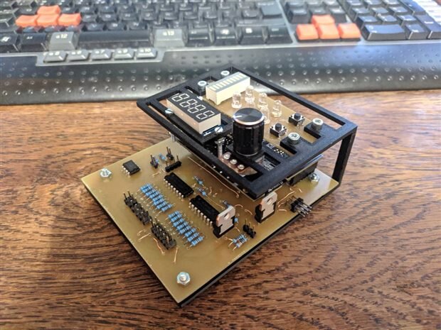

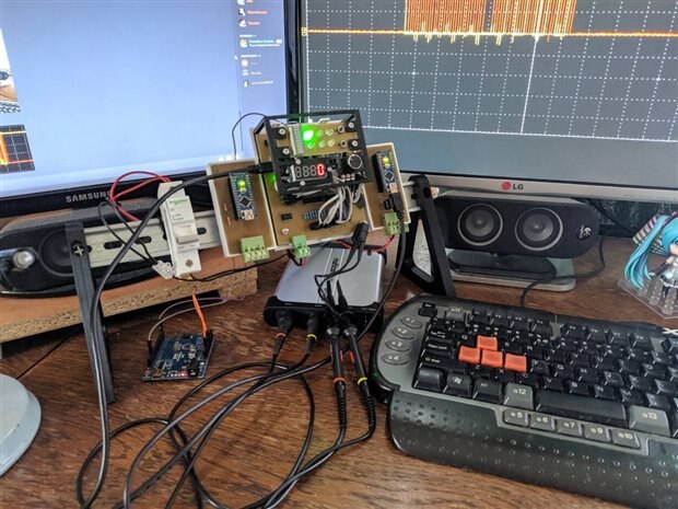

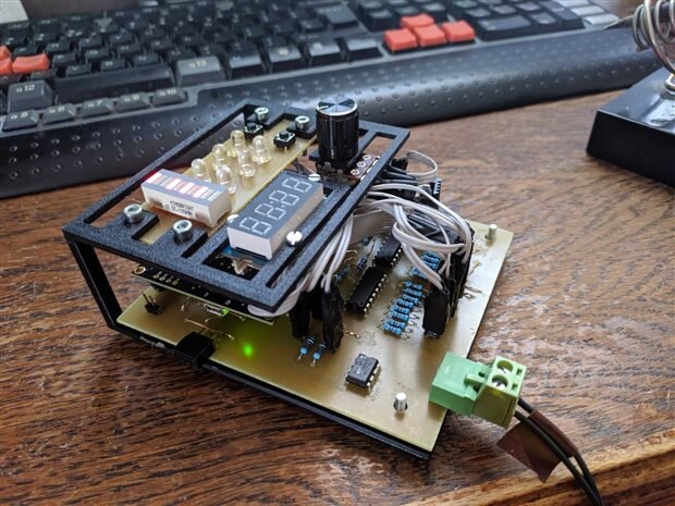

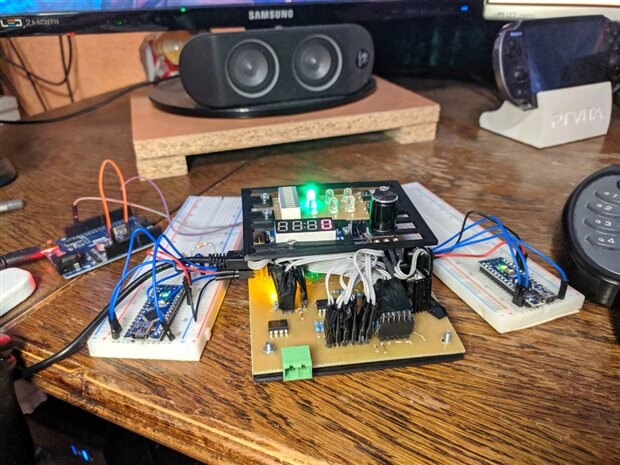

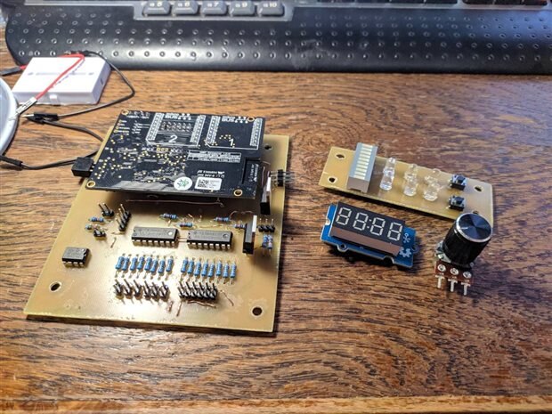

Realization of the board

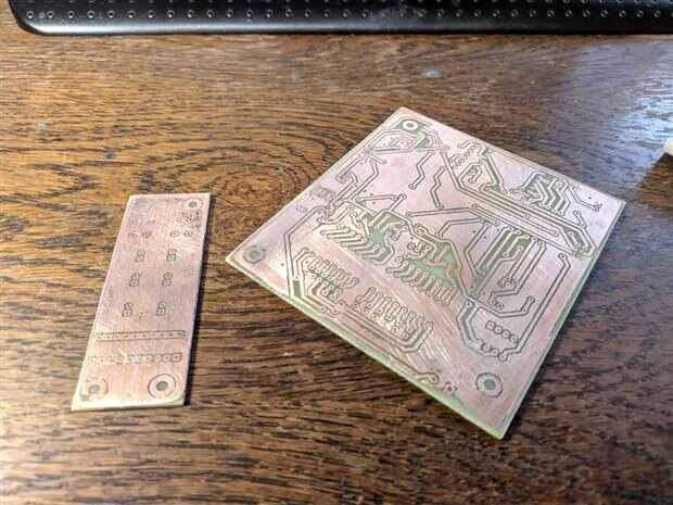

Boards etched and ready to be drilled:
Main board with operator’s panel ready to be assembled:
Assembled main board:
All the stuff connected and first test with external 12V voltage:
First tests of expansion cards on breadboards:
Expansion cards etched and soldered:

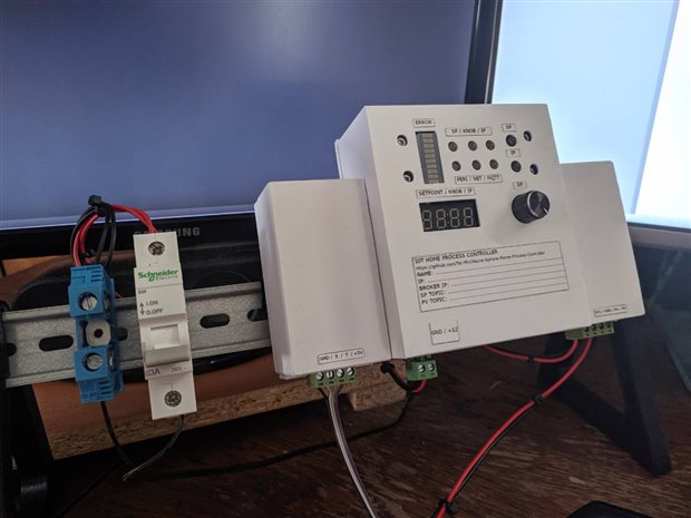

Complete electronic design on DIN rail, programming and bug fixing in progress:
Completed controller:

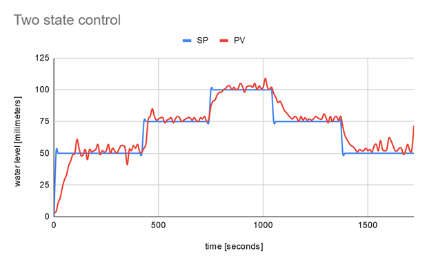

Tests
Both tests were performed using MQTT script similar to script shown in one of the videos above. In the script setpoint's value is changed roughly every 7 minutes. The script changes the setpoint from 50 to 100 to 50 in increments of 15. Setpoint and process value were recorded using mosquitto MQTT broker.
Two state control
In the plot above you can see that two state control works and keeps value roughly around setpoint. But also you can see that the value oscillates around it (+/- 3 milimeters). This controller is ideal for slow processes or processes where some small error does not matter that much. In the project, following parameters were configured for two state controller:
  • Max top error value: 2mm
  • Max bottom error value: 2mm
  • On value of the actuator: 12V
  • Off value of the actuator: 0V

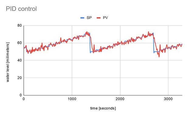

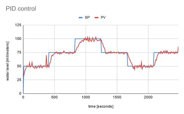

PID control
As you can see, PID control works a lot better than two state control. It keeps process value pretty much on setpoint's location. On the plot one problem can be seen: the sensor is a bit noisy and it can affect our control mechanism. In the project, following parameters were configured for PID controller controller:
  • kp:20
  • ki: 10
  • kd: 0
  • Lower CV saturation: 0
  • Upper CV saturation: 12V
Longer test:

Housing
  1. 3D print all stl files available in project’s repository with 0.2mm layer size , 20% infill and supports
  2. Assembly main board on adapter (black part on photos)
  3. 3D print DIN rail mounts  (01 ver) from here: https://www.thingiverse.com/thing:101024
  4. Connect DIN mounts to the backs of the printed housings
  5. Connect boards to the back of the hounsings, main board via screws and nuts, expansion boards just clicks inside.
  6. Screw top parts of the housings via 3mm screws, no nuts needed
    dougw over 6 years ago +2
    Very nice project and I like the way it is packaged as well.
  • taimin
    taimin over 6 years ago in reply to dougw +2
    Thanks! I just have discovered printable DIN stands and designed the packaging just to try it. It already became my favorite method of displaying DIY projects!
