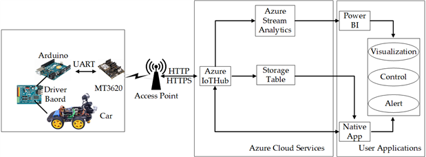

2. System Overview
The entire system is shown in Figure 1, which can be divided into three different layers including device layer, cloud layer and application layer. Firstly, a remote sensing car is composed of Avnet Azure Sphere Starter Kit, Arduino Uno and a car model. Secondly, Azure IoT Hub, Azure Stream AnalyticsAzure Storage Table are utilized as the data processing and management unit. Lastly, Power BI and Native App are used as UX solution and business integration.
Figure 1. System overview.

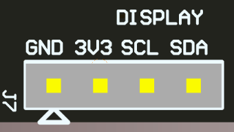

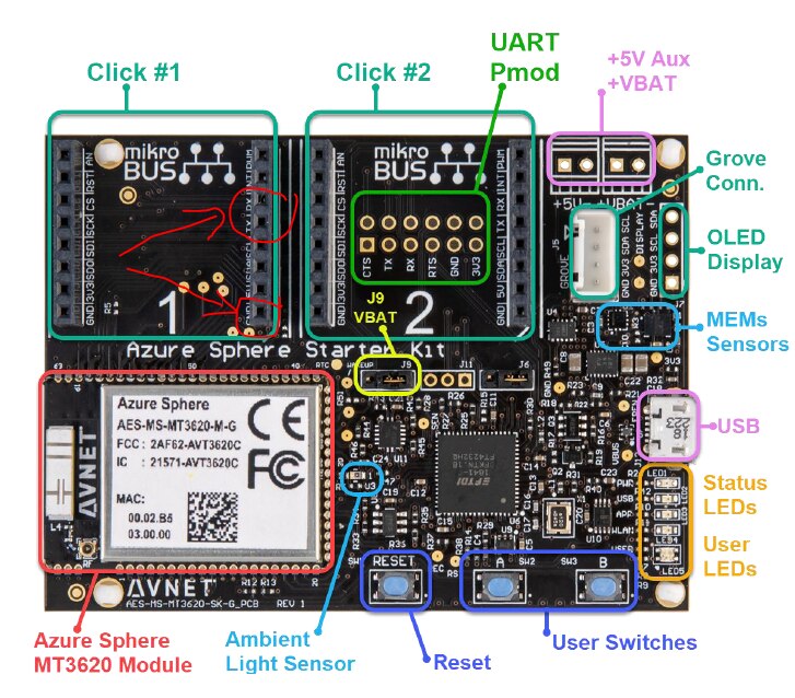

3.2 Connect an OLED Display to Azure Sphere Starter Kit
Interface for optional OLED 128x64 display (I2C) is left empty on the board. The pinout of the OLED DISPLAY connector on this Starter Kit is tabled below in Figure 2.
Figure 2. OLED Display Interface
We can solder four 2.54mm Pins on the board to help connecting with OLED display as shown in Figure 3.
Figure 3. Connecting the board with OLED display by four Pins.

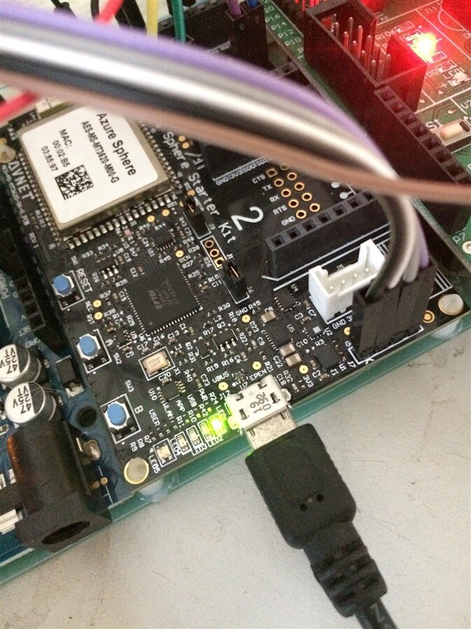

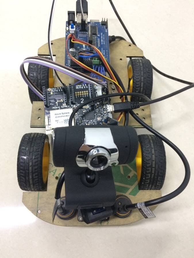

3.3 Connect Arduino Uno to Avnet Azure Sphere Kit
In this project, we use Uart0 of Arduino Uno. So, Pin 0, Pin 1 and GND are used as Rx, Tx and GND for Uart communication. For Avnet Azure Sphere Kit, Uart0 on “Mikrobus Click 1” is used as shown in Figure 4.
Figure 4. Connecting Arduino Uno to Avnet Azure Sphere Kit
Please make sure that the Rx of Arduino is connect with Tx of Avnet Azure Sphere Kit, and the Tx of Arduino is connect with Rx of Avnet Azure Sphere Kit. The car with Avnet Azure Sphere Kit is shown in Figure 5.
Figure 5. The car with Avnet Azure Sphere Kit

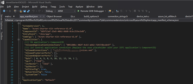

Figure 6. The application manifest file for the project of MT3620
It should be noted that the “AllowedConnections” should be changed to your own Azure IoTHub.

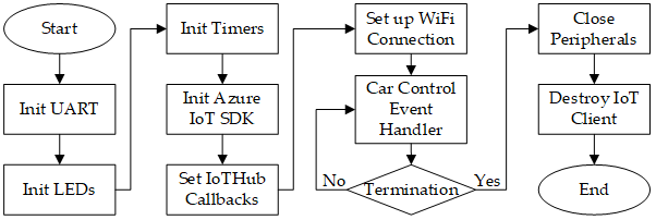

The flowchart of the application that is running in the MT3620 is depicted in Figure 7. In the initialization process, the UART peripheral is configured and opened for communication with Arduino Uno. In the azure_iot_utilities.c, the Cloud-to-Device message is handled by the “receiveMessageCallback” function, in which the global Boolean variables including moveLeft, moveRight, moveForward, moveBack, and moveStop are changed according to the receiving message. In the main loop, the CarControlHandler is called for car controlling according to the values of five global Boolean variables.
Figure 7. The flowchart of the application running on MT3620.
The commands are handled and sent to the Arduino Car by CarControlHandler as follows. Ca rcaiControlHandler

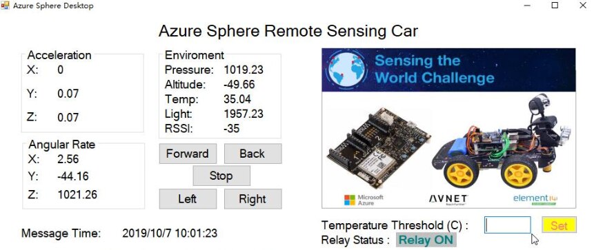

The desktop application is a .NET application. It is named as Azure Sphere Remote Sensing Car, which is built for message display and feedback control as follows.
Figure 8. The WinForm application running on desktop.

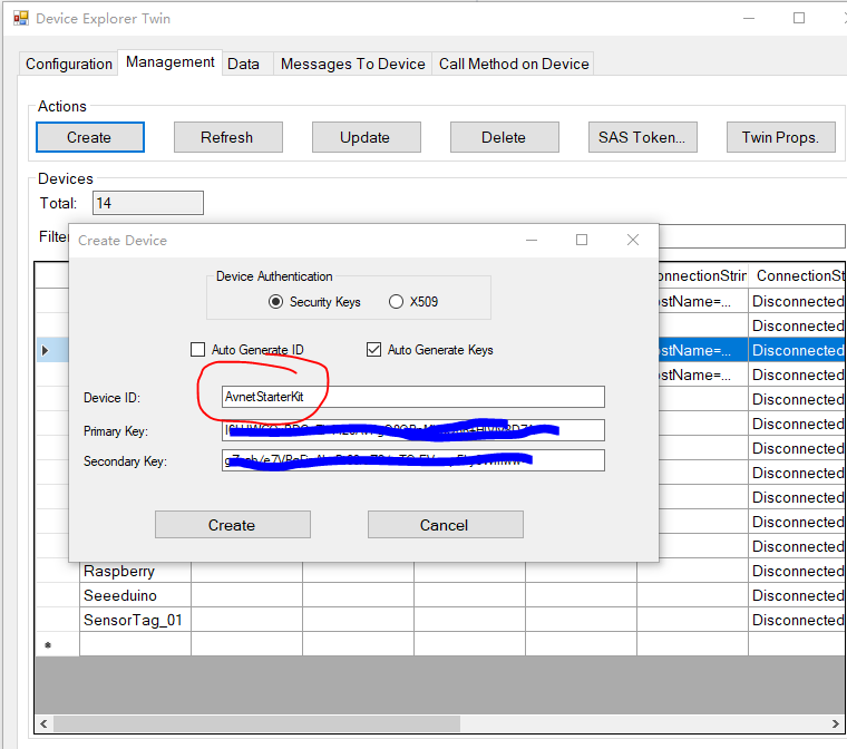

5.2 Authenticate the Avnet Start Kit with Device Explorer
Communication between Azure IoTHub and devices is secured. On Windows, we can use Device Explorer app to complete this Authentication process. A pre-built version of the Device Explorer application for Windows can be downloaded by clicking on this link: https://github.com/Azure/azure-iot-sdk-csharp/releases/tag/2019-1-4 (Scroll down for SetupDeviceExplorer.msi). The default installation directory for this application is "C:\Program Files (x86)\Microsoft\DeviceExplorer".
Open the Device Explorer app and fill the IoT Hub Connection String field with the connection string of the IoT Hub that we created and click on Update. Go to the Management tab and click on the Create button. The Create Device popup will be displayed. Fill the Device ID field with a new Id for your device (AvnetStarterKit for example) and click on Create as follows.
Figure 9. Authenticate the Avnet Starter Kit with Device Explorer
When the device identity is created, it will be displayed in the grid. Right click on the identity we created, select Copy connection string for selected device and save the value by copying to clipboard, since it will be required to connect the hardware with the IoT Hub.

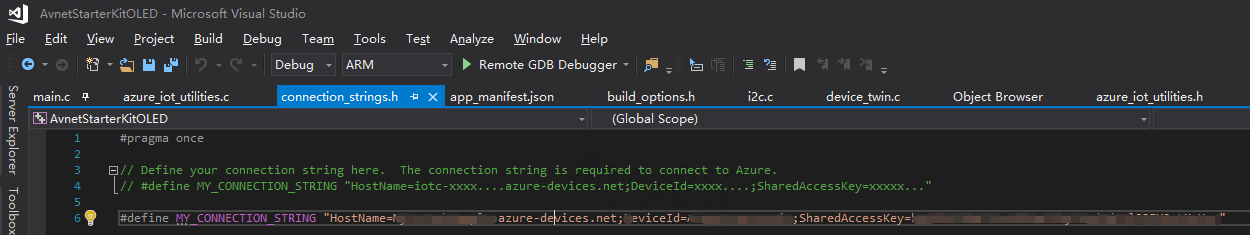

5.3 Update Azure IoTHub connection string
Download the source code from GitHub repository (https://github.com/shijiong/AzureSphereRemoteSensingCar/tree/master/AvnetAzureSphereSK_OLED). Open the solution with Visual Studio, navigate to “connection_strings.h”, update the connetion string as shown in Figure 10.
Figure 10. Update Azure IoTHub connection string

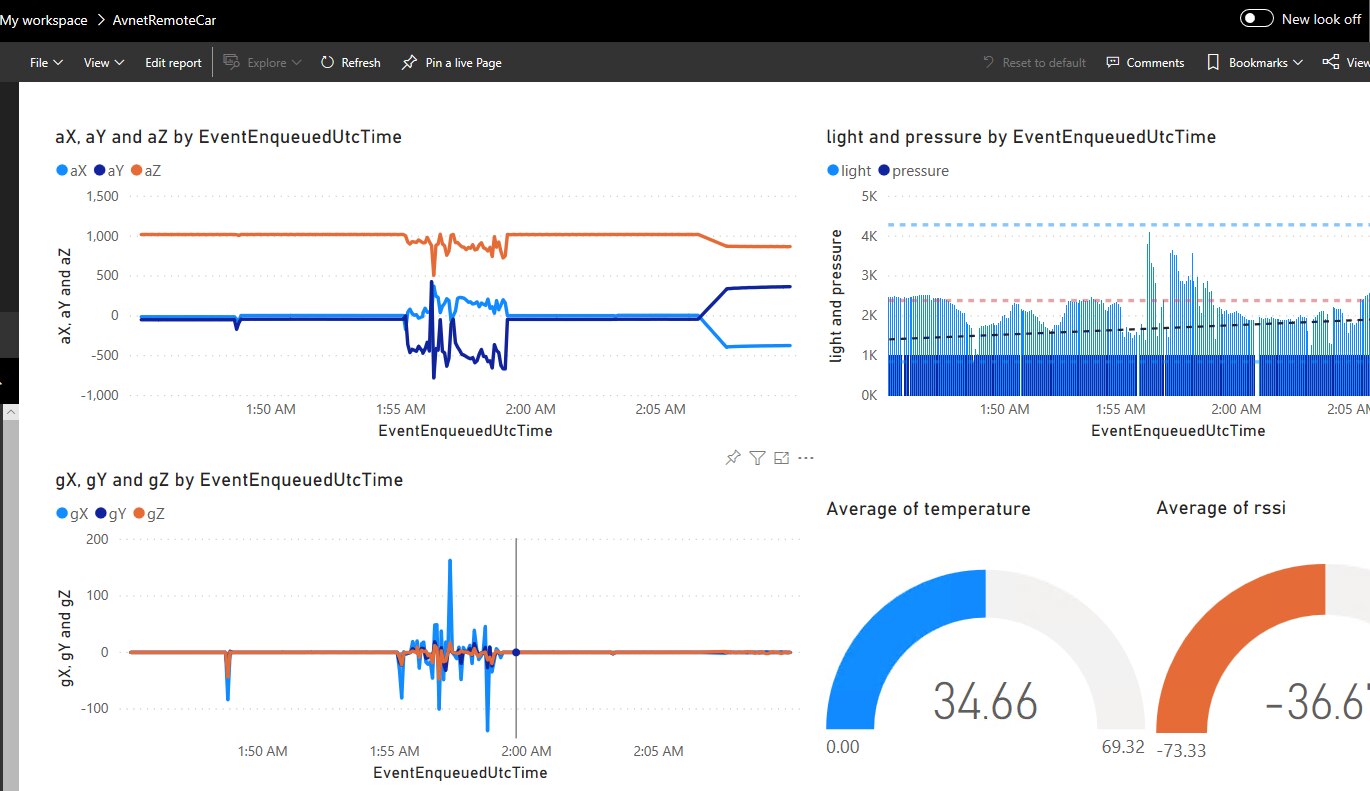

5.5 Config PowerBI Dashboard

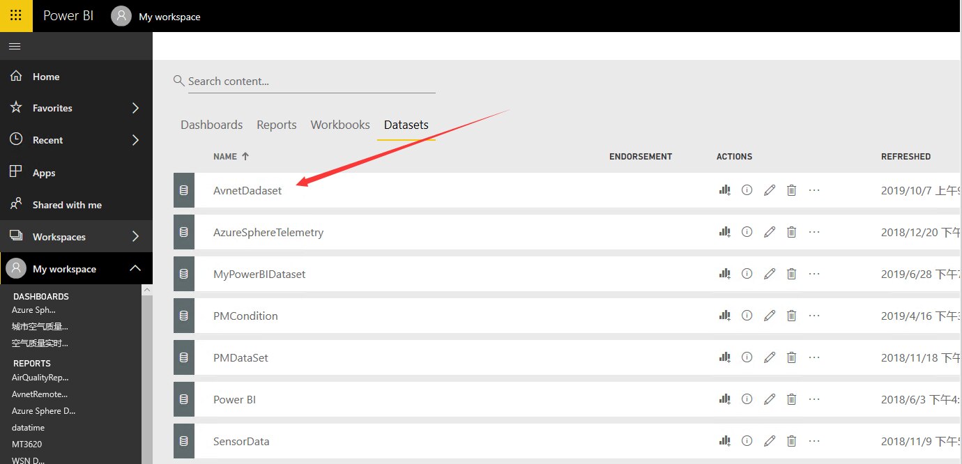

Now that the datasource is created, go back to Power BI session, and find My Workspace by clicking the Power BI link. After some minutes of the job running you will see that the dataset that you configured as an output for the Job, is now displayed in the Power BI workspace Datasets section in Figure 11.
Figure 11. Power BI workspace Datasets
Please note that the Power BI dataset will only be created if the job is running and if it is receiving data from the IoT Hub input, so check that the hardware is working and sending data to Azure to ensure that the dataset be created. To check if the Stream Analytics job is receiving and processing data you can check the Azure Management Stream Analytics monitor.

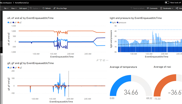

Once the datasource becomes available you can start creating reports. To create a new Report, click on the Power BI datasource.
The Report designer will be opened showing the list of fields available for the selected datasource and the different visualizations supported by the tool. Here we choose real-time sensor date and the processing time. Now the report is almost ready. Click the SAVE button and set Campus Environment as the name for the report as follows.
Figure 12. Power BI Report designer

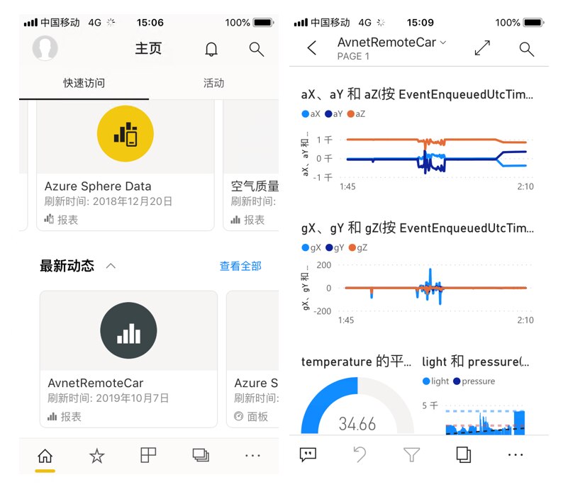

5.6 Browse PowerBI Data on Mobile Device
With Power BI Desktop (https://powerbi.microsoft.com/en-us/desktop/), we can get the data from Power BI Web and display the data report that we create above on desktop PC.With Power BI application on iOS or Android, we can get the data from Power BI Web and display the data report on mobile phone.
Figure 13. Power BI Mobile

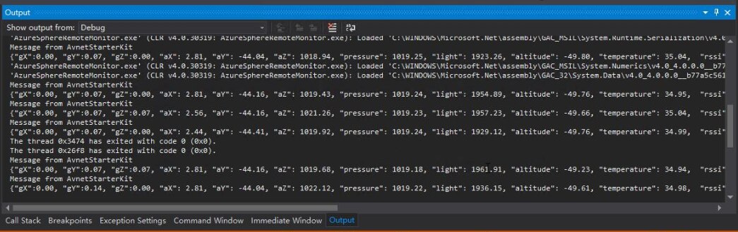

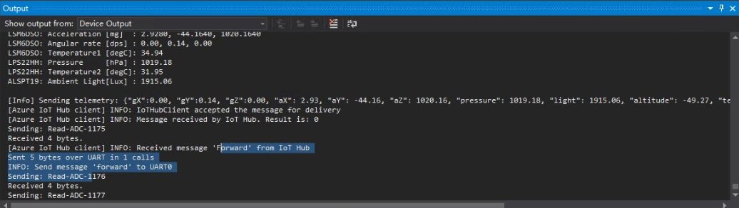

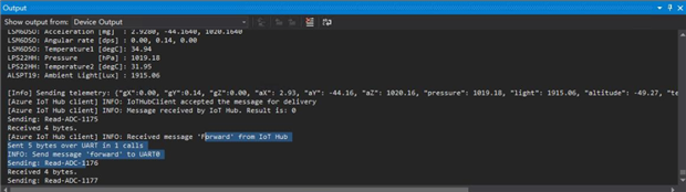

6.2 Monitor the output of the Visual Studio IDE
The debug information will be displayed in the output windows of Visual Studio. When we click Forward button on the WinForm application, the message will be sent by Cloud to Device message and it will be processed by MT3620. The raw information will be shown as in Figure 14. As we can see, the message is well received and the corresponding UART Hex data is sent to Arduino for car control.
Figure 14. Output Window of Visual Studio

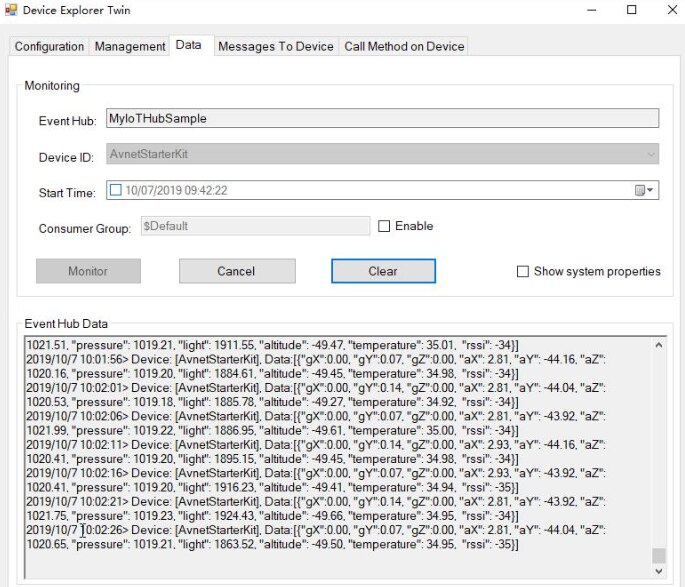

6.3 Monitor the messages with Device Explorer
Once the messages are sent successfully to Azure IoTHub by Avnet Start Kit, the information can be monitored by Device Explorer. The raw messages are shown as in Figure 15.
Figure 15. Message captured by Device Explorer

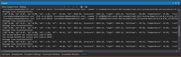

6.4 Monitor the output of the WinForm Application
As soon as the application starts, the communication between the desktop and the Azure IoTHub is established. And the Device to Cloud messages are displayed on the output window as in Figure 16.
Figure 16. Message of the WinForm Application

    Basically, we mainly use the UART of Avnet Azure Sphere Kit to communicate with Arduino Car. Please find the details in Section 3.3.
    And "Please make sure that the Rx of Arduino is connect with Tx of Avnet Azure Sphere Kit, and the Tx of Arduino is connect with Rx of Avnet Azure Sphere Kit."
